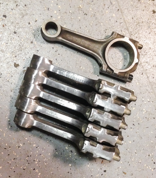

In my M30 motor I used stock rods but did a lot of extra material removal. See photo.
They are very strong and very heavy as stock.
I removed material and weighed them all to get them the same weight to the gram and then my machinist balanced all reciprocating parts including the harmonic balancer and flywheel.

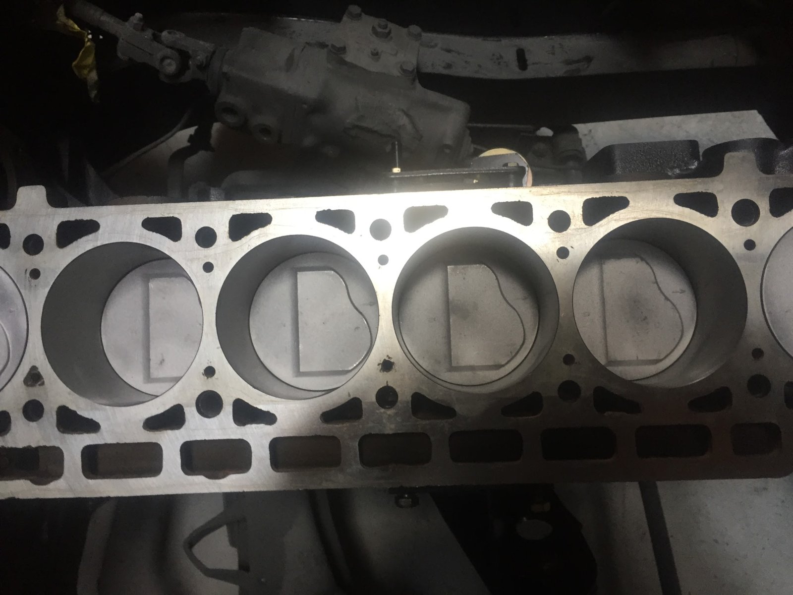

92 bore?
piano top pistons?
what date is on your block?
call me....
got off the phone with don.
despite the vin on above the starter the engine is definitely not from a 79 635csi. casting on head and block are from 1982. don thinks its most likely a b34 and not an m90.
A question from an old hot rodder. In the day, we never went to high performance rods unless building a true "monster" motor. Why the concern here? Also. although compression ratio can be specified , whatever machining has been done to the head surfaces or the block deck itself have to enter into the measurements of the pistons and their dome height because of valve interference As I am sure Don will chime in, this is an exact science, and all these things have to be thrown into the equation. I guess if it is a stock unmolested engine and just needs to be bored, then there shouldn't be a problem?
M30b34 euro spec engine
10:1 piano top pistons
92 mm
bore
1982 date on block and head

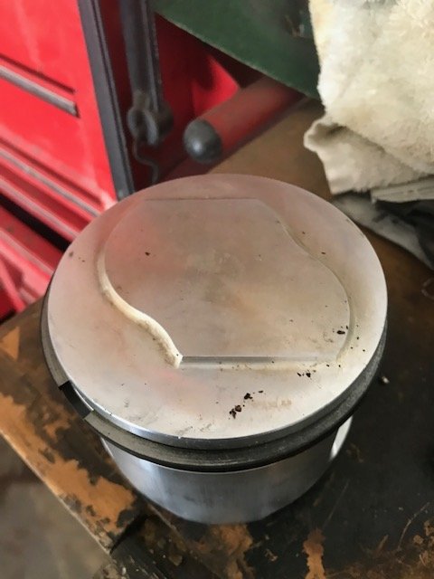

JE 10:1 from my 81 M90. Either made wrong by JE or measured wrong by engine builder as the piston stuck up .5mm over the deck. It's hard to see as it is very small, but one of the valve was lightly touching the piston. So much for one of three best shops in town
