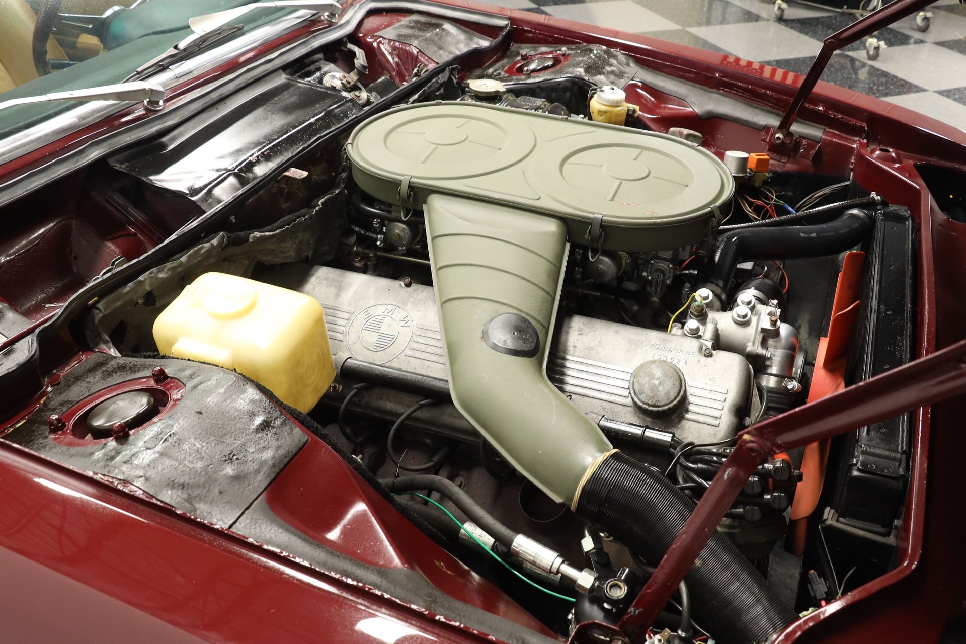

Ugly non-OEM tar insulation. 1st thing I'd do is heat gun those off, but wonder if they're hiding some ugly shock tower repair. However, the underside looks pretty good.

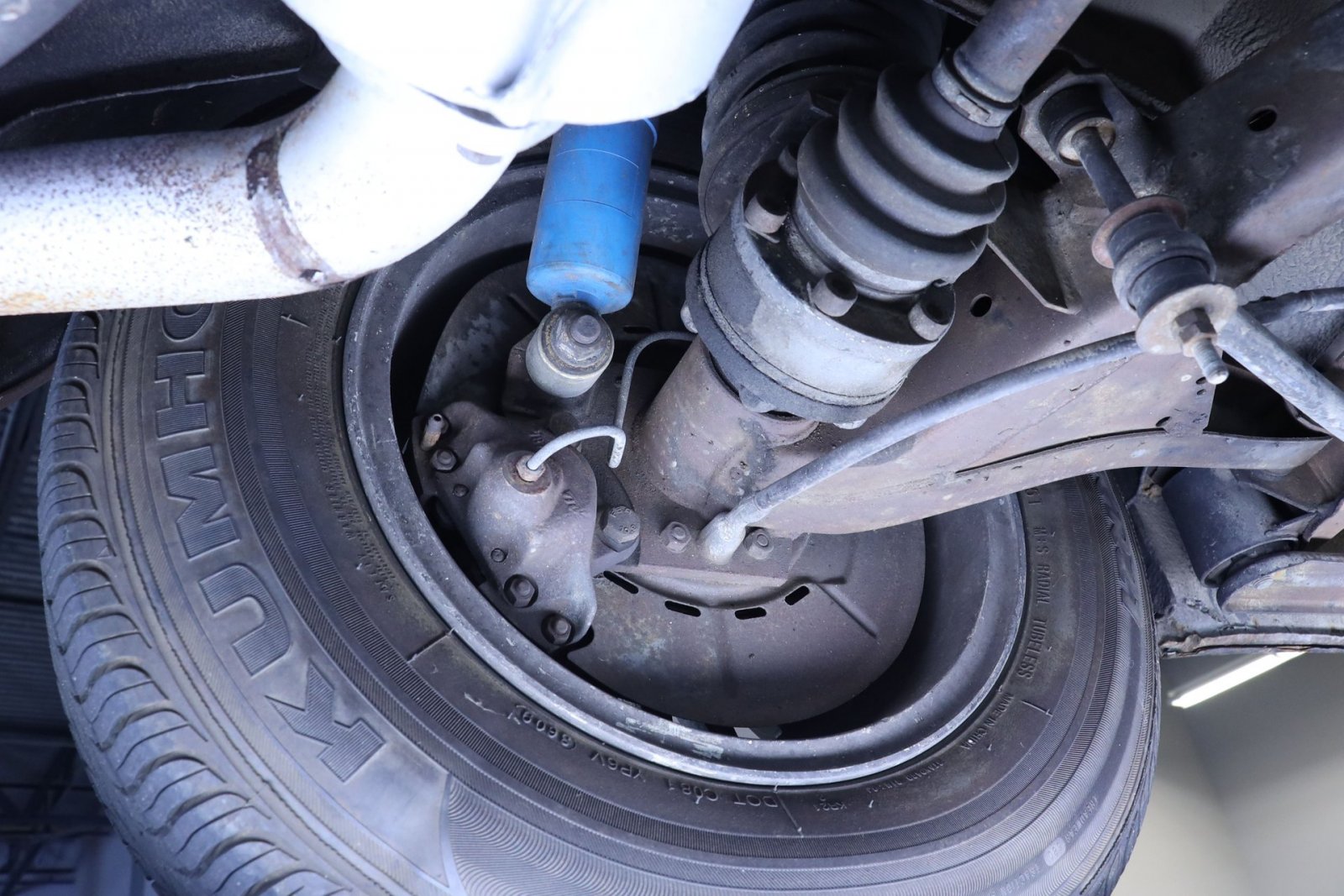

Another odd detail, I think, is it appears the rear shocks are upside down (or at least the blue dust boot is on the bottom where it should be on the top). Are there different versions of Bilsteins that would install this way? I can imagine those blue covers filled with water, which is not the intended purpose.

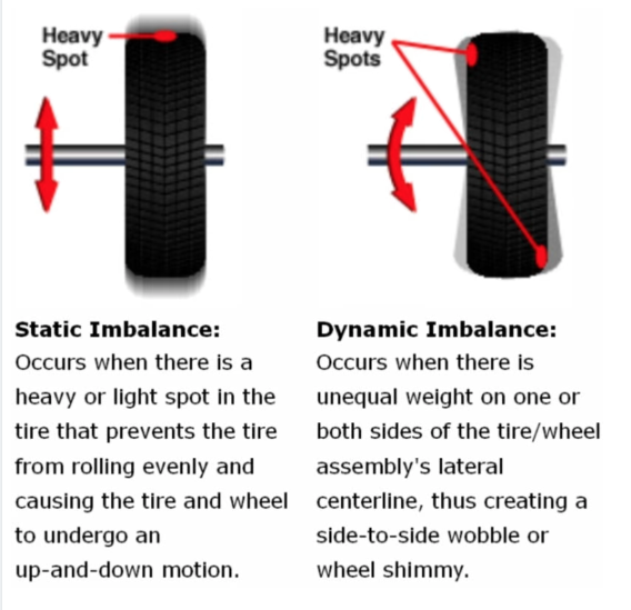

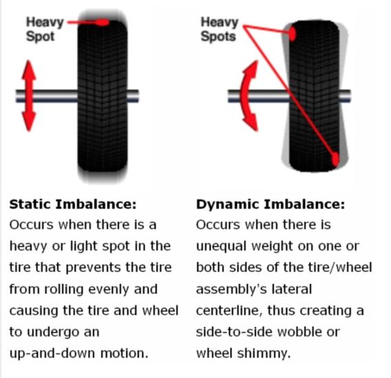

Because tires are not uniform it's possible to have weight variations that are not evenly distributed across the width of the tire. If the heavy spot is near the outside and the balance weight is put inside the wheel, you can have a dynamic imbalance that will show up at speed but not when the tire is statically balanced. To be dynamically balanced, it can be better to have the weight on the outside.
There's also a type of balancing called "road force" balancing where a roller is pressed against the tire to simulate the weight of the car to measure the variance in the flex of the tire and allow calculations of proper weight placement. This might also result in weights being placed on the outside of the wheel.

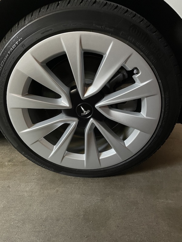

I don't think you will find many newish cars with weights on the outside of the wheel...
I've always had the tire shops use stick on weights in the barrel of the wheel on my collector cars with no balance problems
The wheels/tires are still DYNAMICALLY balanced even with stick on weights. I don't think any shop is STATICALLY balancing these days
Shops (and car manufacturers) have to be more accurate with stick on weights, but most shops have the modern electronic equipment needed for the accuracy required.
As of 2019, 40% of weights used by tire shops were stick on.
Tire shops would not balance wheels/tires with stick on weights in the middle of the barrel if it resulted in vibration. They know you would be back for a redo. :(

Paint very orange peely. Looks great from 10 feet away. Some rust visible in usual spot on both rockers. Lots of mismatched or loose trim. Hood didn't shut right. Interior seemed to be in excellent condition (wood, seats, doors, dash), as did the headliner. Loose power window buttons (and gosh, BMW, that is an unforgiveable material). Underside looked great, as pictures show. Some bubbling in places. Grab handle/dry cleaning hanger had loose trim. All the rubber around windows and doors was toast, flaking off/cracked or missing, though that's pretty typical. Pioneer unit looked ugly in there, as did the aftermarket speakers, but whatever. Tar insulation in engine bay was indeed hideous and pretty warped. No clue what that's covering. The antenna was cleverly hidden on an a-pillar, almost unnoticeable. Trunk looked good around the spare. Lots of signs of older work.
