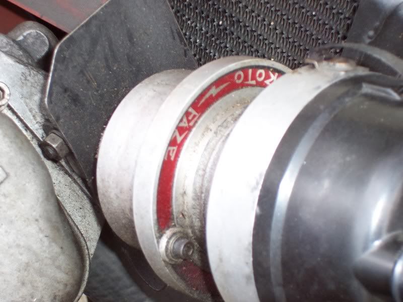

I just swapped the OEM distributor back to the one that came in my car when I bought it. It is a Roto Faze, custom out of California. It is a hipo dual point distributor using 2 sets of NLA Mallory points which I am having a very hard time sourcing. It also uses a 6 cylinder Ford Mustang cap and rotor. My car runs much much better, even running on one set of points currently...
