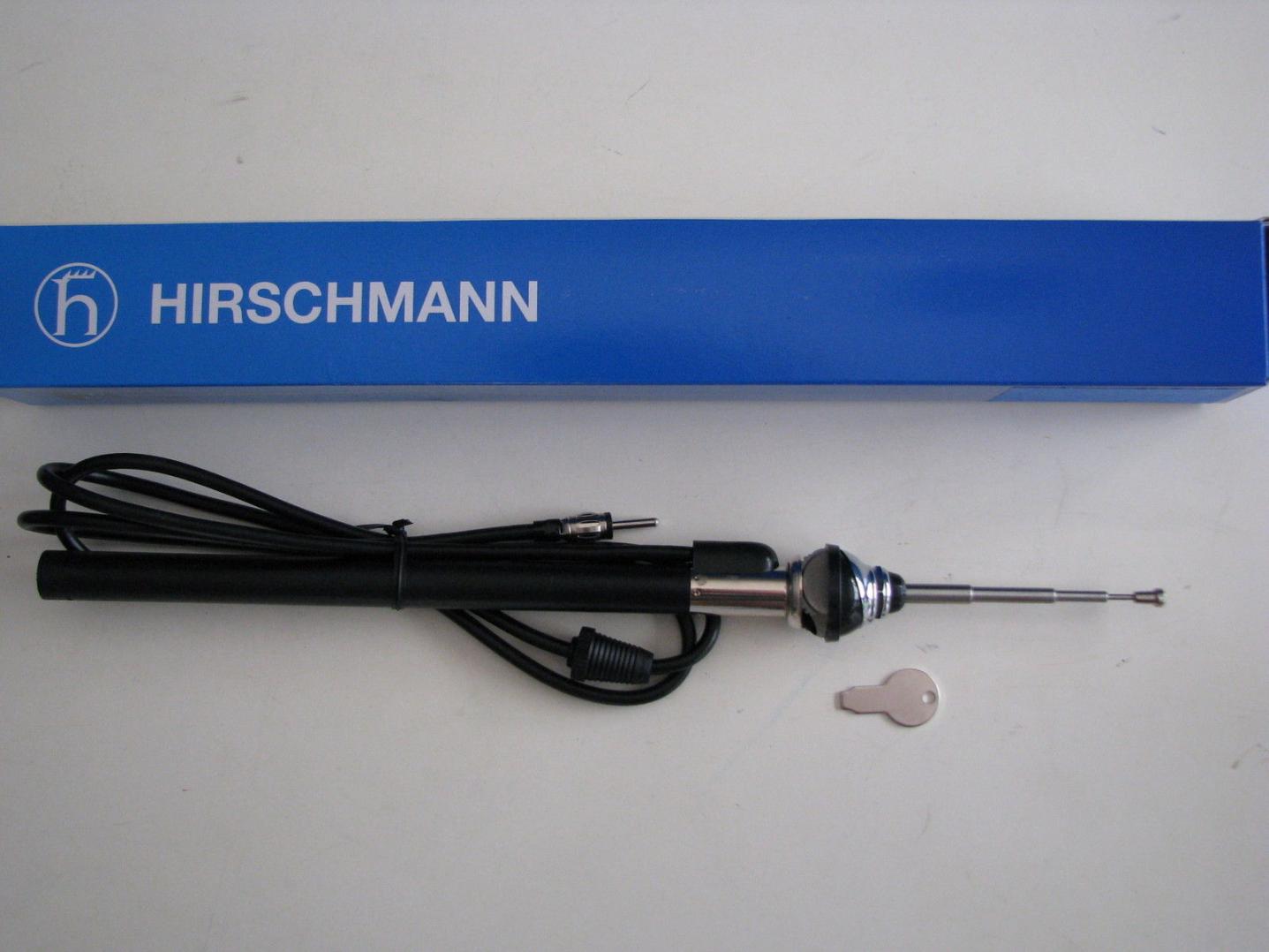

i have a brand new one, and it goes all the way down ... its a hirschmann style, but not hirschmann. if you buy a new one, you need to check the diameter of the hole in your fender. there's a guy on ebay - woodyscustomshop that is very helpful and does sell hirschmann - both manual and electric.

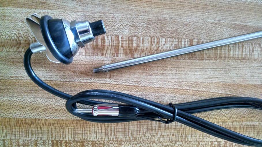

now for the question, what side is your antenna mounted on? is it in the front or rear? the reason i ask is that i learned this issue the hard way. mine is located on the passenger front fender and there is not enough depth to put a fully recessed antenna in ... hence the reason that i have an antenna sitting in the parts bin ... it fits the hole in the fender, just wouldn't go down into the hole. so, the type of antenna that i have is a shallow mount ... and won't go lower than 8" to 10". if you remove the antenna, you can figure out what type of mount you have.

so if you remove the antenna, is there a section that is about 8" to 10" deep into the fender cavity? if so, then the antenna should be able to be pushed all the way down ... if there is no depth, then it is a semi-retractable and can't be recessed any further
