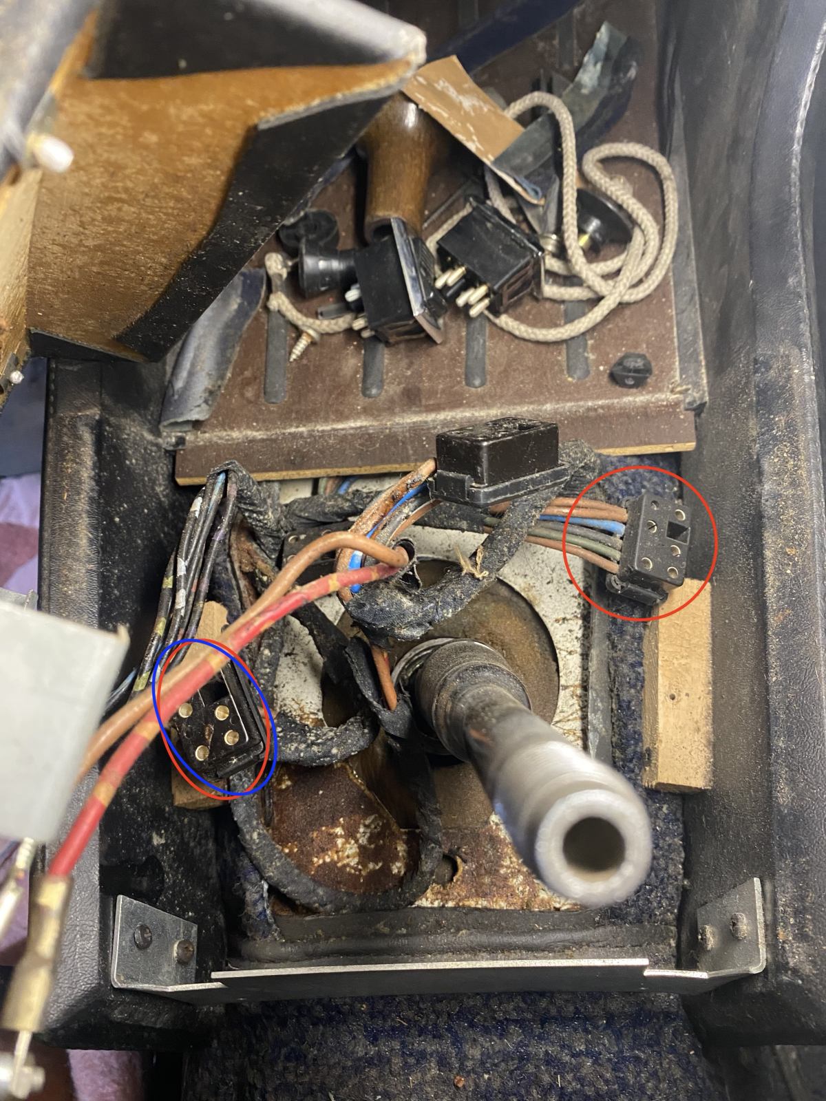

doing some electric in my car (MUST have an autoradio in it !!!)
and i saw that i have some rocker switch in my central console for front electrical windows (in red)
so i was thinking of installing motor in my front doors
anyone has a picture of door ? one with new motor and one with sardine motor ?
just to see if its easy to install (i have new type motor on the rear)

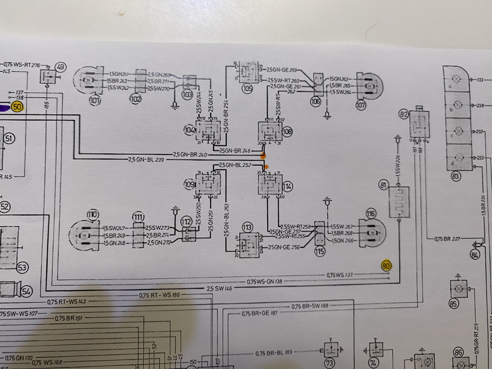

also my switch have 6 wires attached..i search in my wiring diagram but i have trouble finding what exactly going on ...
do you know what this 6 wires are ? where are they going ? i have no wire in my doors and it seems wires goes under the carpet with is glued and i don't want to take it appart...
i think they are just somewhere under the carpet, disconnected but if someone has an idea ... i take it !

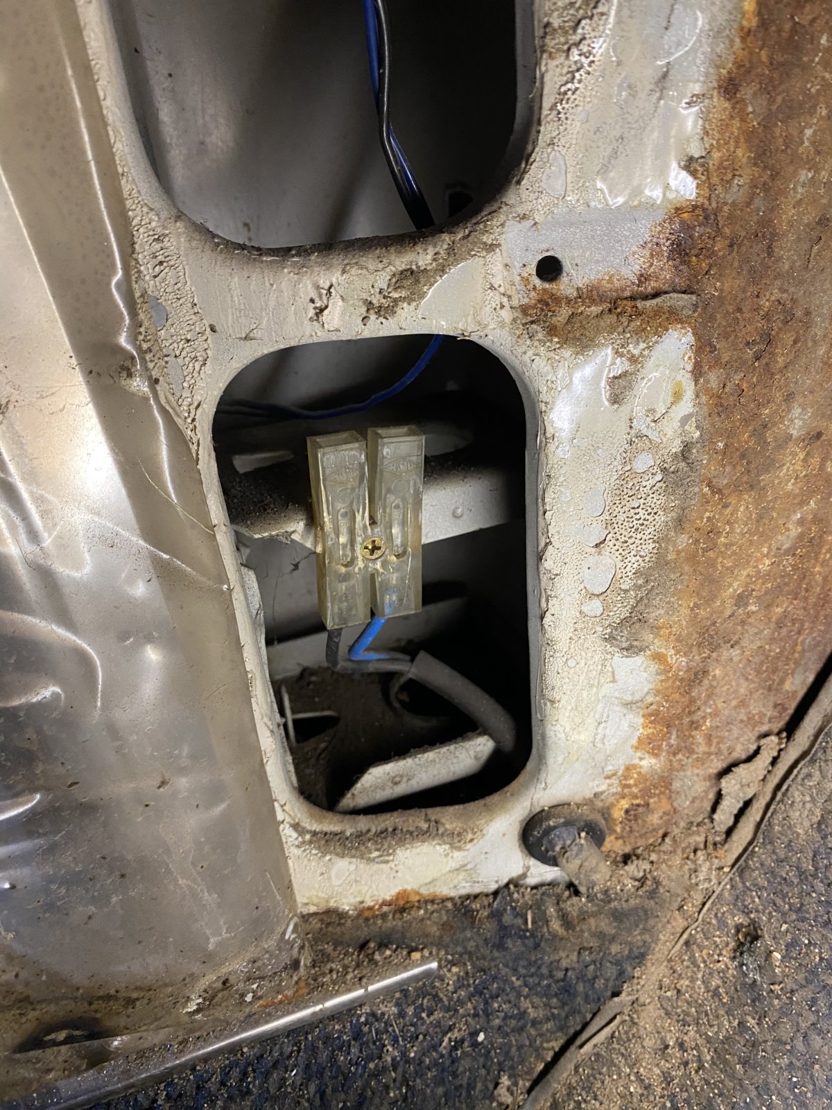

First of all, when was your coupe built, before Feb 1973 or after. The wiring diagram is for sardine can motors with three wires to each motor, the later motors use two, is this what you have in the rear? You would need window regulators that hold either of these motors. Your switches are the later style by the way. The wires for the front door end at a junction behind the kick panels with just two wires if later style.

My car is 74 , I was thinking that newer motor ( none can motor) on rear was only on car after 73 so I didn’t mention it sorry
This is the wrong diagram … I was so upset about not understanding…… it’s all clear now !!
Do you have the correct diagram? This is very strange because I have the original owners papers with original manual…
I think I need a pair of recent motor to match with my car with regulator , I will see tonight
With new motors , is this plug and play as can motors or you need more modification of the door panel ?
Thanks a lot !
74 wiring diagram is here:
You need a pair of e28 window motors from the “rear“ doors only, members sell them here, but it may be hard to find the regulator to mount the motor. You will also need the circuit breaker, you already have one, under the steering column, hopefully wiring is there too. Not quite plug and play.

I found this in the kick panel
Two wires, so it seems I can fit e28 motors

As you can see, there is plenty of dirt in the car, obturator seems to had gone away With time …. Need a good clean up and some verification
(Some wire suffered a bit)
