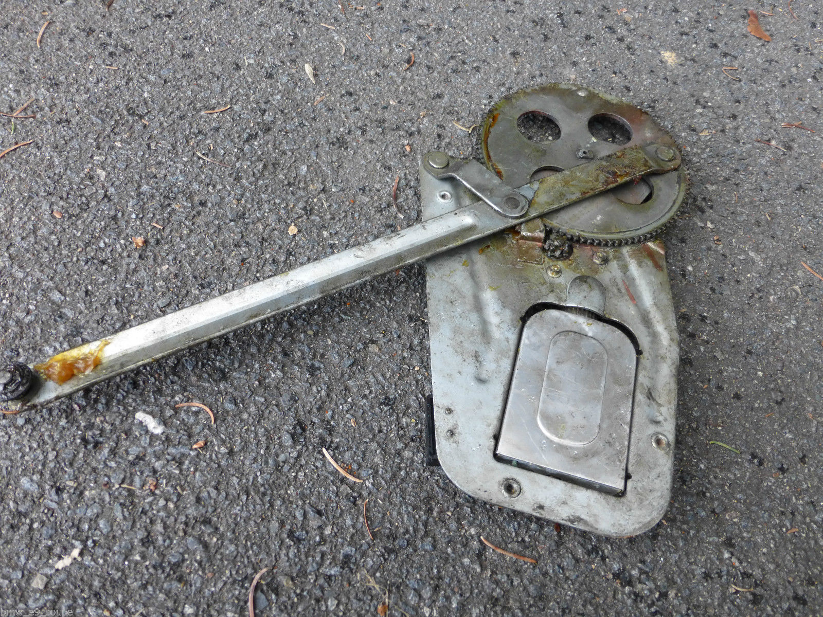

Example of pre 74' sardine motor type front power window mechanism

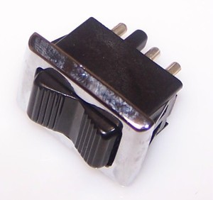

the rear windows are the sardine can type Part No 0 130 805 003.......their action is quiet quick ......it doesn't look exactly like your photo (may have been upgraded as I have heard rear windows are slow) The switch is as below.

That switch is for later motors as it has pins instead of spade terminals. Coupes with manual front windows had a blocking plug inside the chrome trim for the window switch, not unplugged switches, someone added those. You can use either motor in your doors but you need to find the mechanisms first which appear to be a bit rare, someone here may have them though.

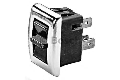

If you have sardine motors you will need Bosch switch as below.
So, for front you will need exact same mechanism L&R as was shown above - no mods will be needed with genuine parts all is plug'n'play.
