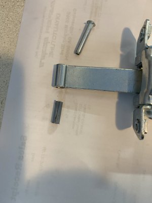

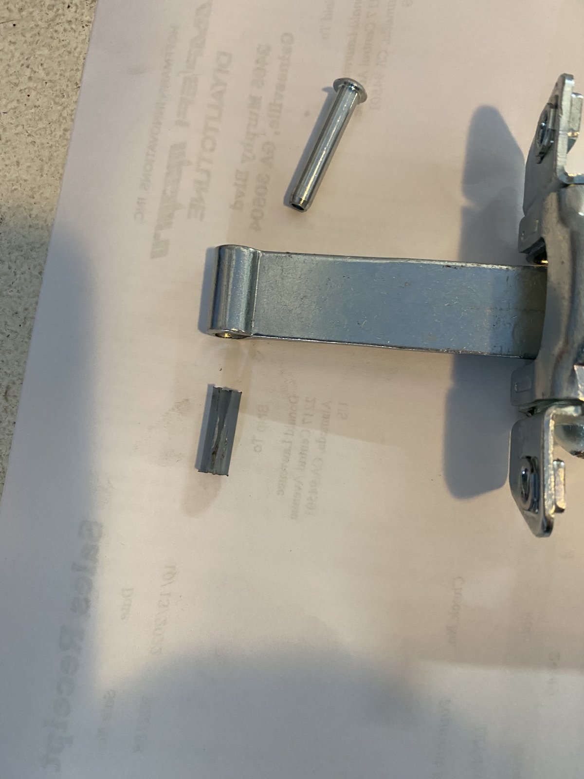

2002 door brake pin
Blue plastic vent hose that came with your car
Cut the hose with a fine dremel blade lengthwise.
Man, I hate those aluminum pins, they tend to work up and come out at the bottom which after a few door openings and closing will usually break the tab off but just a thought as I sit here typing this out, drill a small hole in the bottom and put a small cotter pin in there Other than that, they do work well But I have found that the MB style replacements that are being used now are slightly larger at the end where the pin goes thru so I am not sure if the blue tubing is tight enough in there. I just 2 on a 2002 ti ( same style )that I m restoring and had to use a slightly thicker wall tubing to stop any clicking sound
