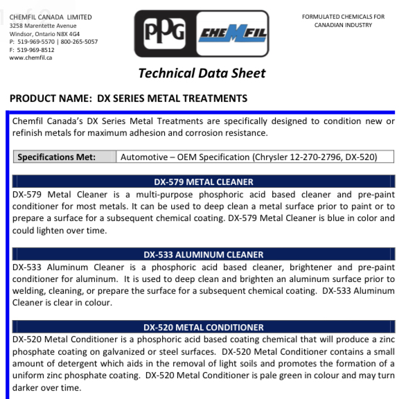

Back in the day - I used a DuPont version of these PPG products (see info at bottom). I found they did a great job keeping bare steel from rusting. Yes, the conversion coating sometimes left what looked like a little flash rust after it dried. But if I wiped that off, no more rust occurred. Once I left a piece of bare alloy steel (Reynolds 753) in a damp basement for nearly a year and it remained rust free. I would sometimes seal the metal with an zinc chromate etch primer before doing body work. I think today that type of primer is outlawed, so shops I trust will shoot catalyzed epoxy primer over a bare metal chassis (conditioned or not) before commencing with body work. Apparently body filler sticks just fine.

Hey John,
I assume you are talking about the DX-520 metal conditioner, right (not the cleaner)? I remember the Dupont metal conditioner, but can't seem to find the same product today. The one I find now talks about rinsing it off as part of the process, but I remember just "wiping" it off and leaving the residue on the surface. That is similar to how the Picklex works, too.

Hey John,

Yes, the SX-520. I have NOT used this myself, it the guy who did my Alfa HTv body says it works fine.
The old DuPont stuff was 5717S then 5818s. It had to be cleaned off with a wet rag. Once dry, there was often a bit of hazy residue and a little flash rust. I would clean that off ‘dry’ y running down with m gentle scotch bite (white) and paper towels.
10 years ago I bought some new stuff that’s more environmentally friendly. It recommended rinsing over wiping. It seems to also provide great protection on bare metal.
