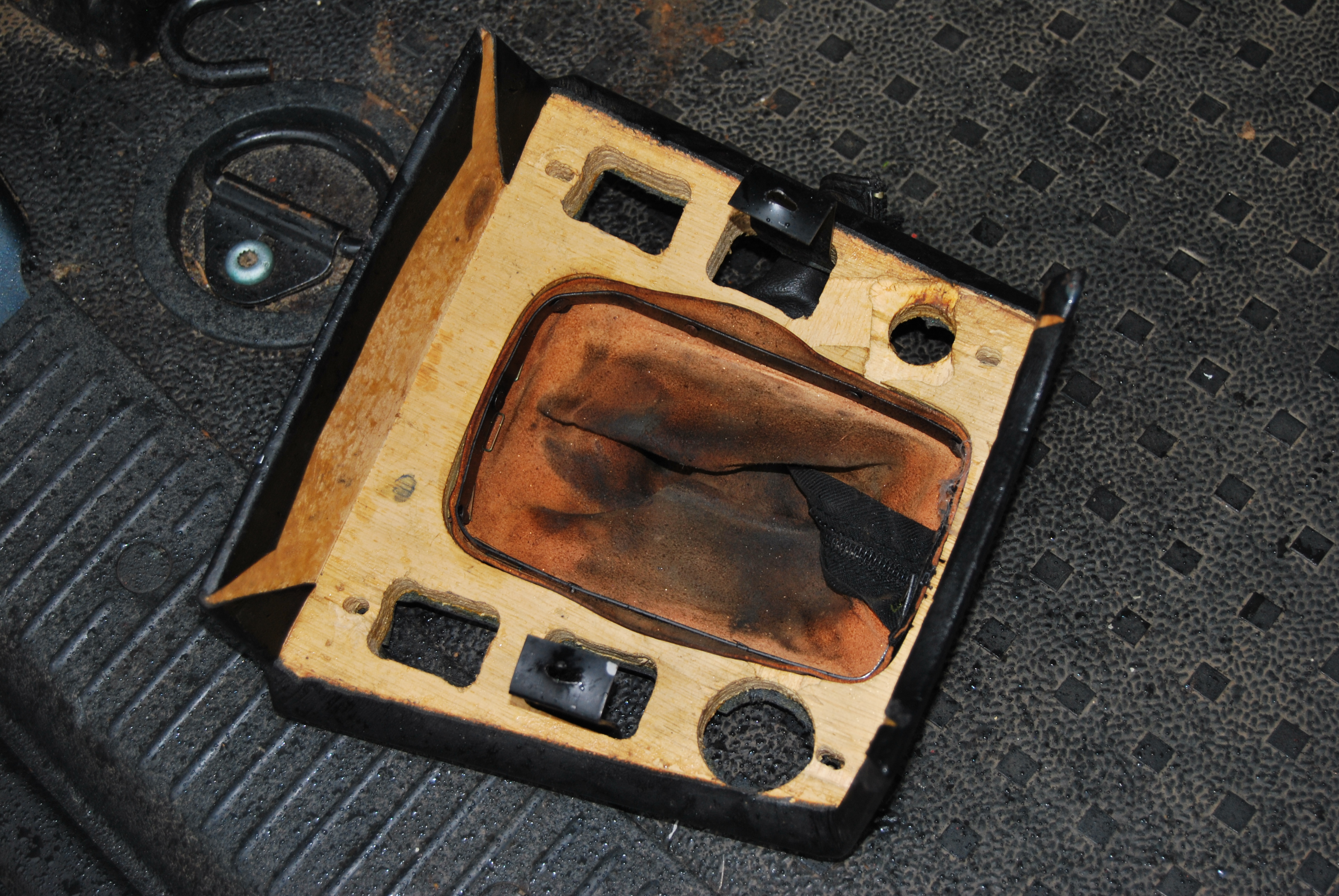

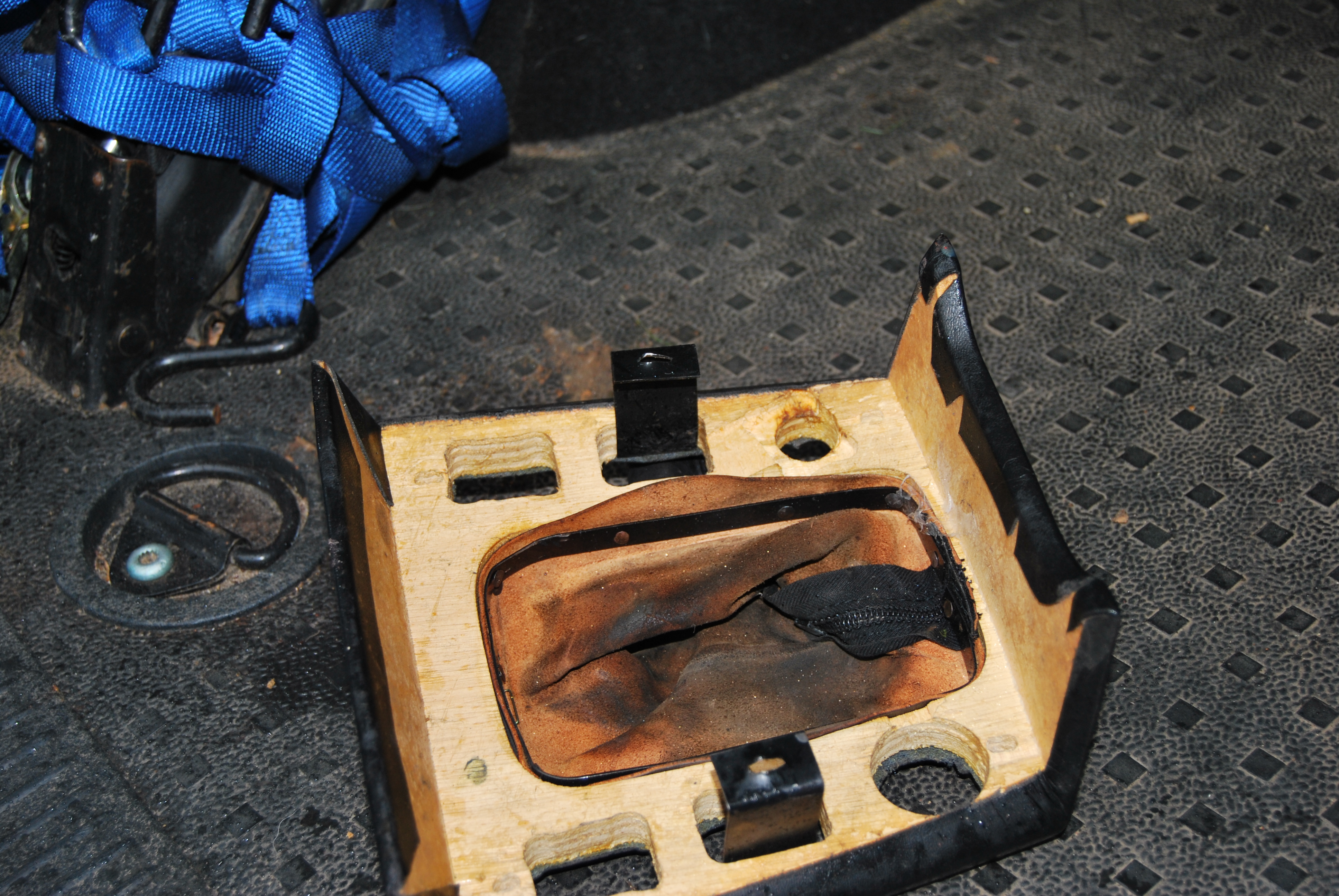

Hi the trim has two pins that push through holes in the console. the pins then have a spring clip pushed over them to grip it to the console. you have to remove the console to get to them easily
Mark

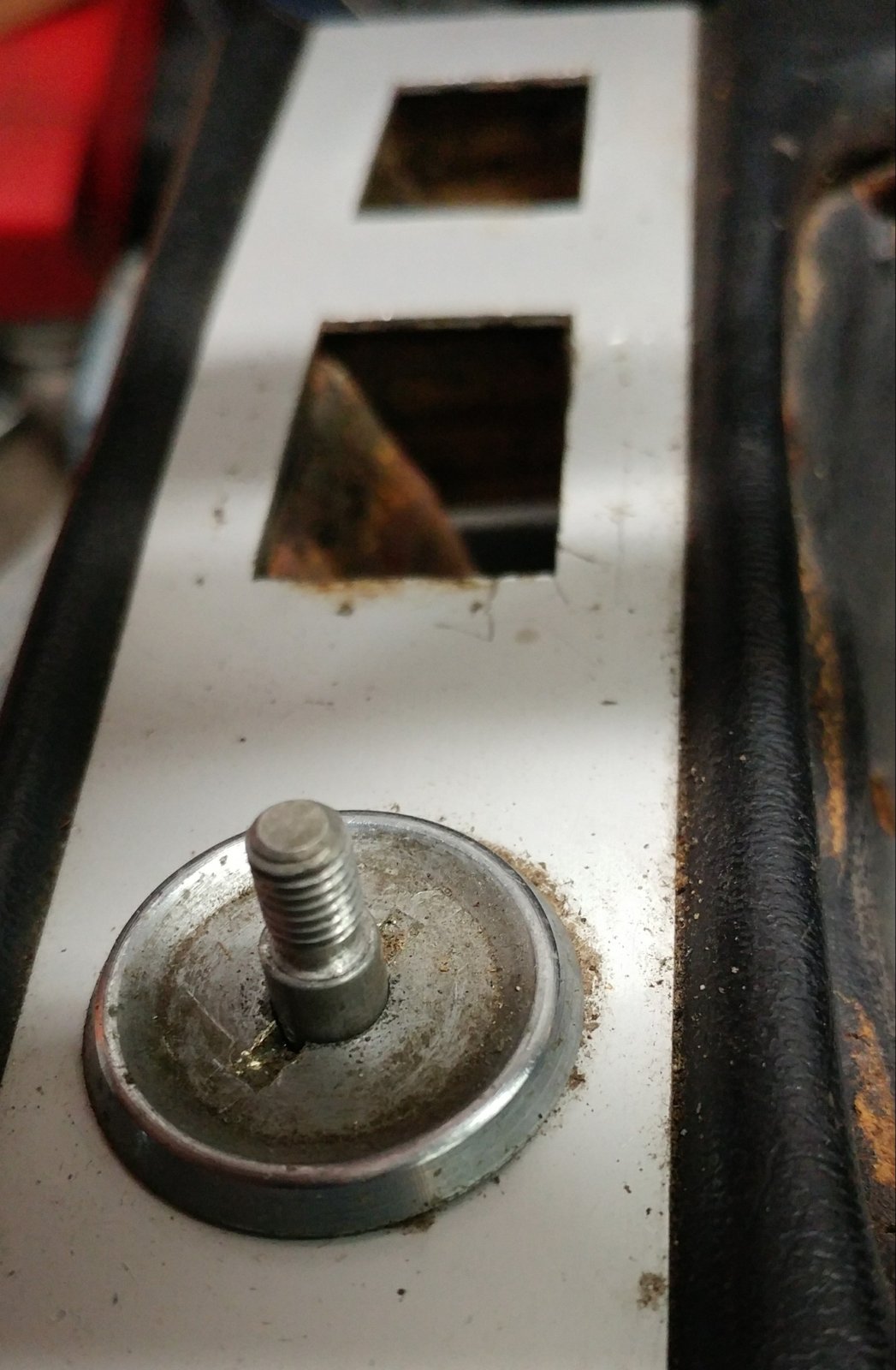

The trim has 2 posts on them over which a metal speed connector slides on to hold it from underneath.

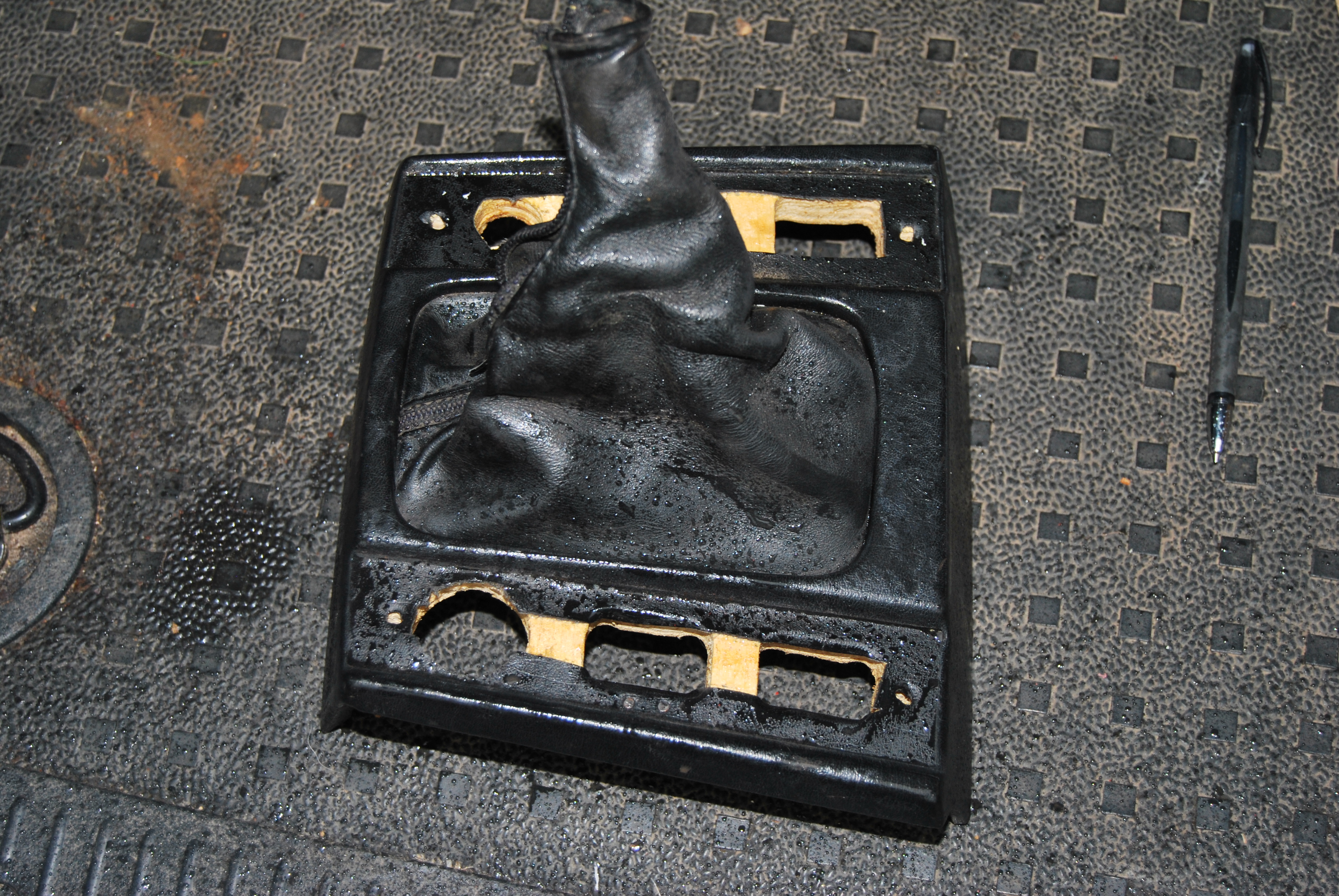

in order to remove the shifter surround, pull the switches in the middle of the panel. you will find a small screw below on each side ... you have to remove that screw and then you can lift the panel up. there will be wires to the window switches and the wiper speed and cigarette lighter that will keep you from moving the panel too far.
Remove the two switches for the rear windows to get to the screws that hold this part to the transmission tunnel
If you can't find the speed clips you could always glue them down, it's unlikely you will ever need to take them off again.
Cheers. John
One trick with speed clips, if they are solid material, there is a good chance that you can cut a thread on them and use a normal nut to secure them.
Can be used for the trunk 2800 / 3.0/ Cs/ Csi /CSL badges as well.
Cheers. John
please don´t
yes, this is the right way :-)
