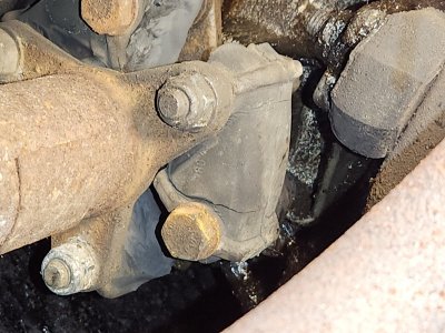

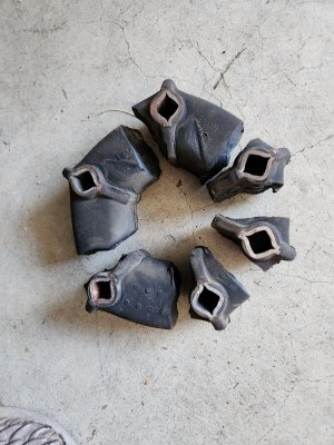

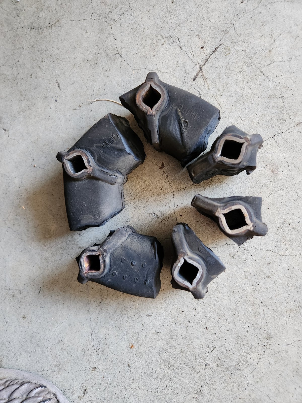

Has anyone had this problem before?
The rubber prop shaft joint has given way it was a new Meyle 314 261 1101 part that was £55.00.
It went with a Bang…..
The original manufacture was a German one made by Goetze that I took off the car when I restored it – did not use it as it was probably circa 1980s…
I have now splashed out and got the Original OEM German one but its £160.00…
When they normally fail, the rubber delaminates – not the steel shatters…..

Meyle is a decent brand, better than MTC. It’s still just a $30.00 Guibo.
German rubber being what it is, I prefer the reinforced versions over the “grenade”

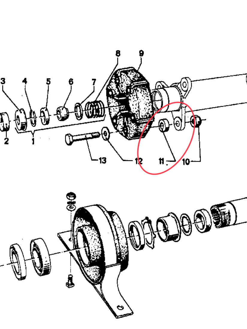

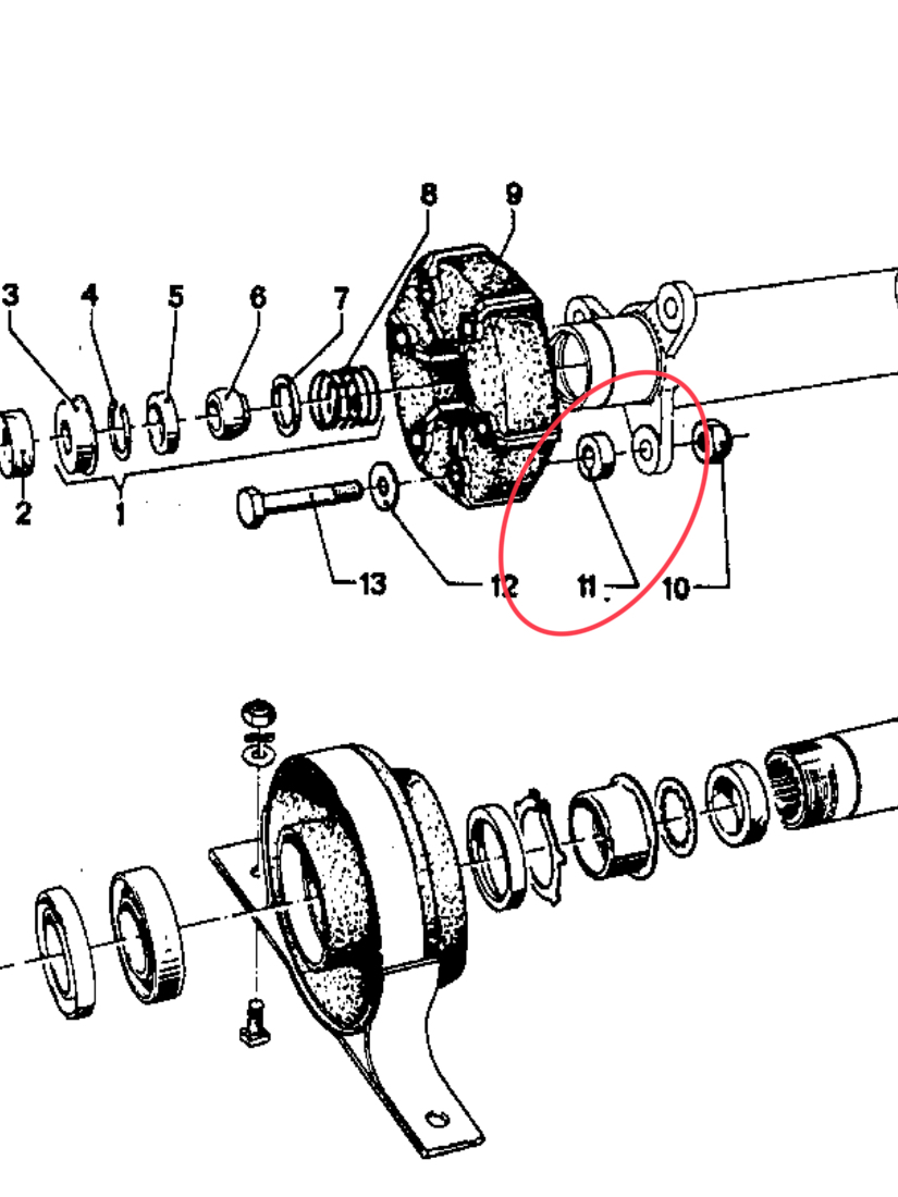

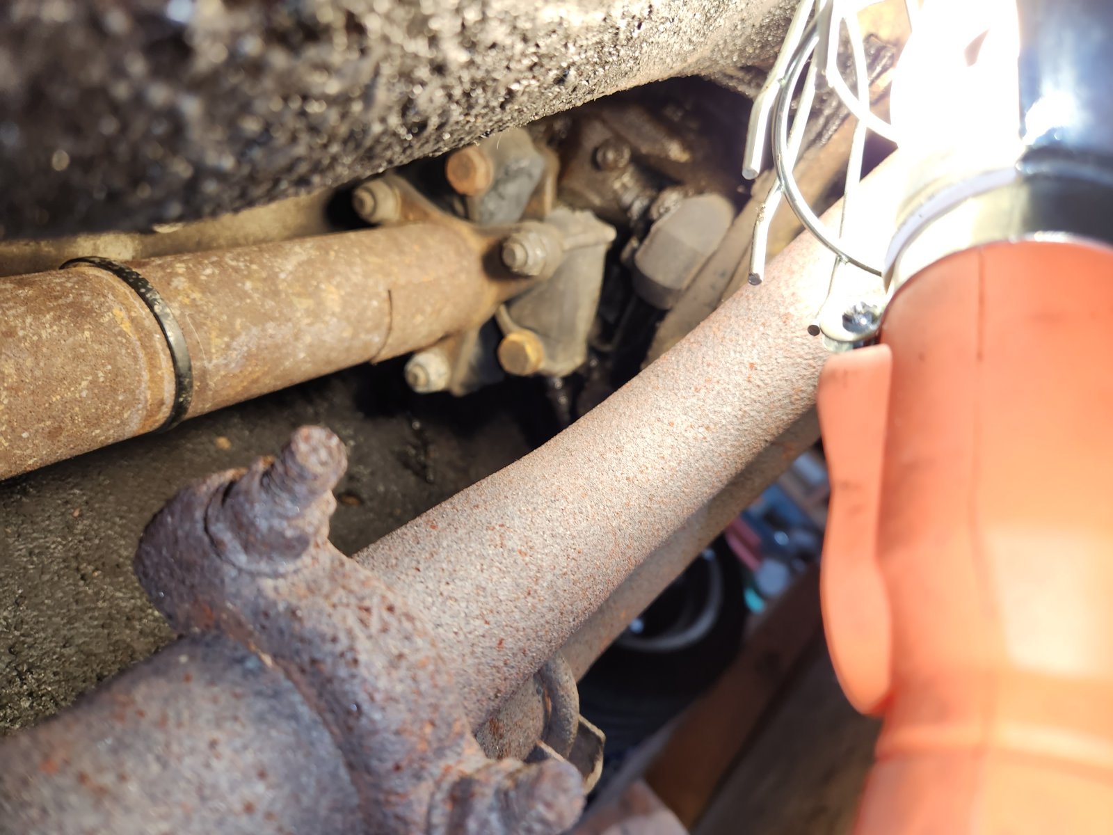

Mine did not have the part no 11 spacer washer when i took it to bits - plus the bolts i have ( picture ) only just show threds through the nut.
What i have forgot - and now its a pain - is washers on the bolt end as per the picture (12) - looks like 2 big jubilee clips to compress the joint...........dam.....

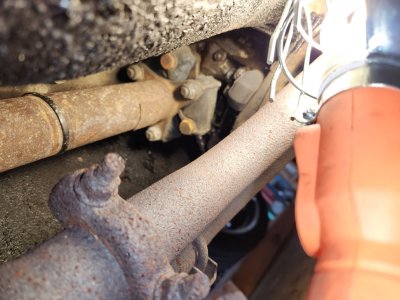

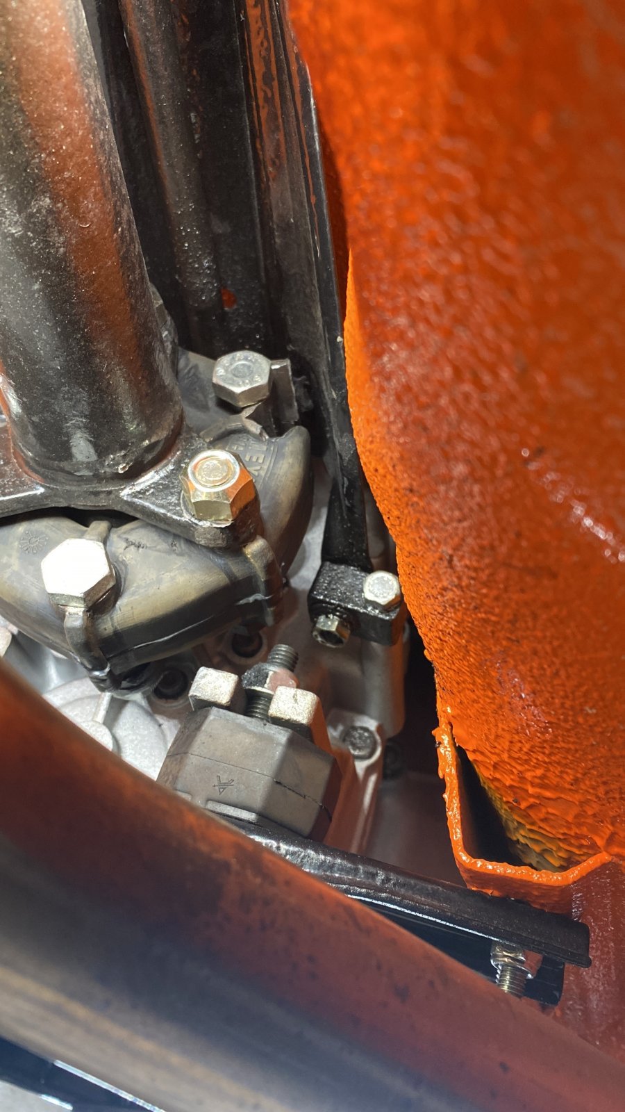

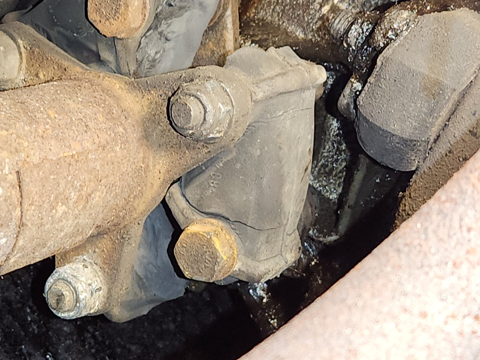

Hi @Marc-M, mine also went out recently, I only discovered it whilst investigating an intermittent clunk sound when releasing the clutch. Was a PITA to replace.
Regards,
Adrian
