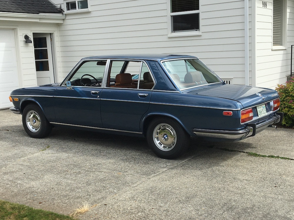

I’ve had several BMWs that were originally equipped with XWX’s and inner tubes. Although the tubes probably offered more protection against road hazards, they doubtlessly added unwanted unsprung weight, so I was glad to eventually replace them with tubeless versions. It has been too long to be sure, but I believe some of the tire carcass sidewalls actually specified that they be used with inner tubes. One suspects that inner tubes were somewhat necessary if the rims upon which they would be mounted were not air tight. Spoked-wire wheels spring to mind and, along those lines, one site dealing with Borrani wire wheels states as follows:
