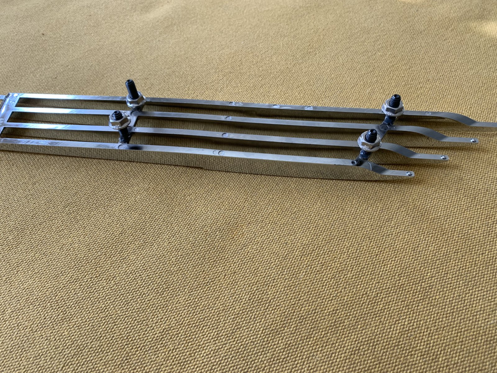

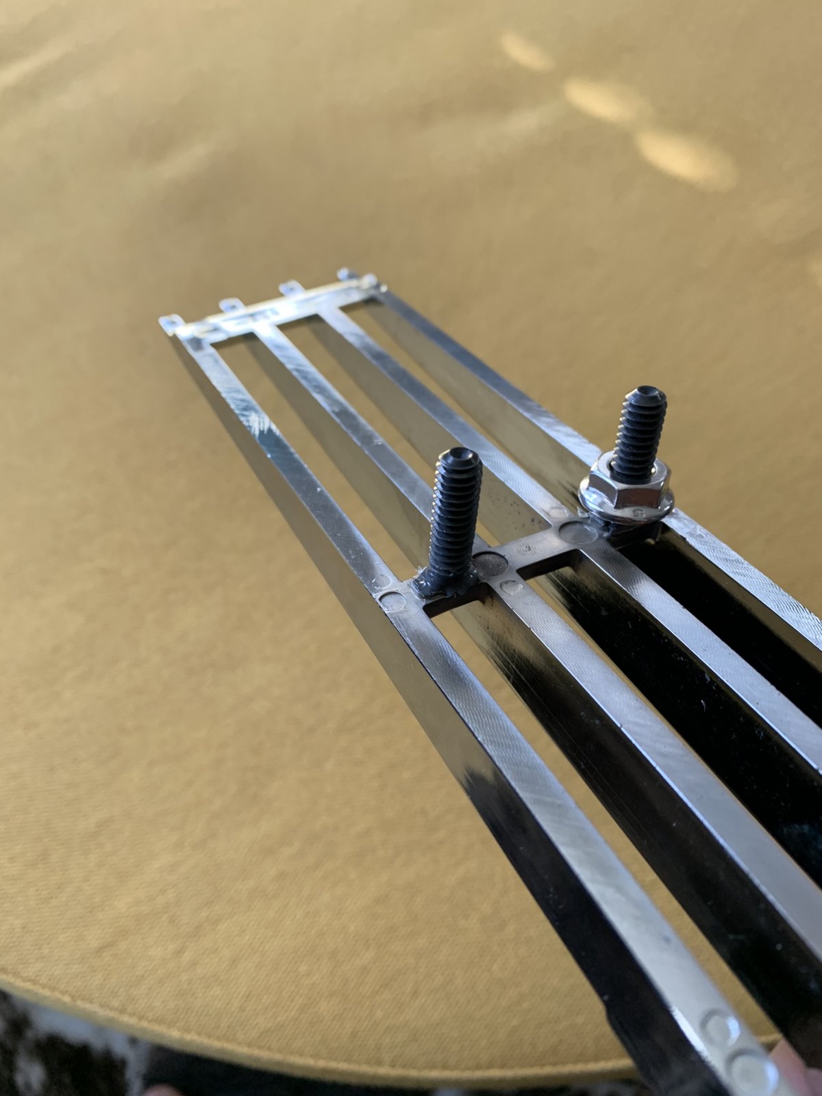

As many of you have experienced, the stems on the side grills typically break off during removal if used with the BMW fasteners.
I tried a couple different things to fix this -
- tiny grommets
- vinyl vacuum tubes
- threaded rods
What I eventually went with was 1/4” socket set screws. Simply drilled out the opening a little bit more so they would slide over what was left of the ABS stems. Then bonded them on with JB weld and attached to the car with flange nuts.
I did have to widen the holes on the car by just a smidge. But overall an easy upgrade and a much more robust long term solution IMO.

I'll be interested to see how this turns out. I attempted something similar, but with nylon screws. I used a plastic-rated epoxy to set them. They lasted about 3 weeks on the car before falling off (luckily it happened in the garage). Maybe JB weld is the answer!

it looks very nice
Nice idea, especially when the tabs have snapped off.
