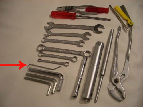

Hi guys,
In the Cs toolbox there is one tool missing. The one highlighted with the red arrow below.
Don't even know what this tool is for but if anybody has a spare for sale to fill in the gap I would appreciate it a lot.
Many thanks in advance.

Hi Philippe,
it's the tool to adjust the valve excenters. You can easily make it yourself, if nobody (including me) has any to sell.
Just buy a piece of round steel (3mm dia) and bend it according to the supposed contour in your tool box. That's what I did.

A shirt hanger from the laundry is about the right size metal
