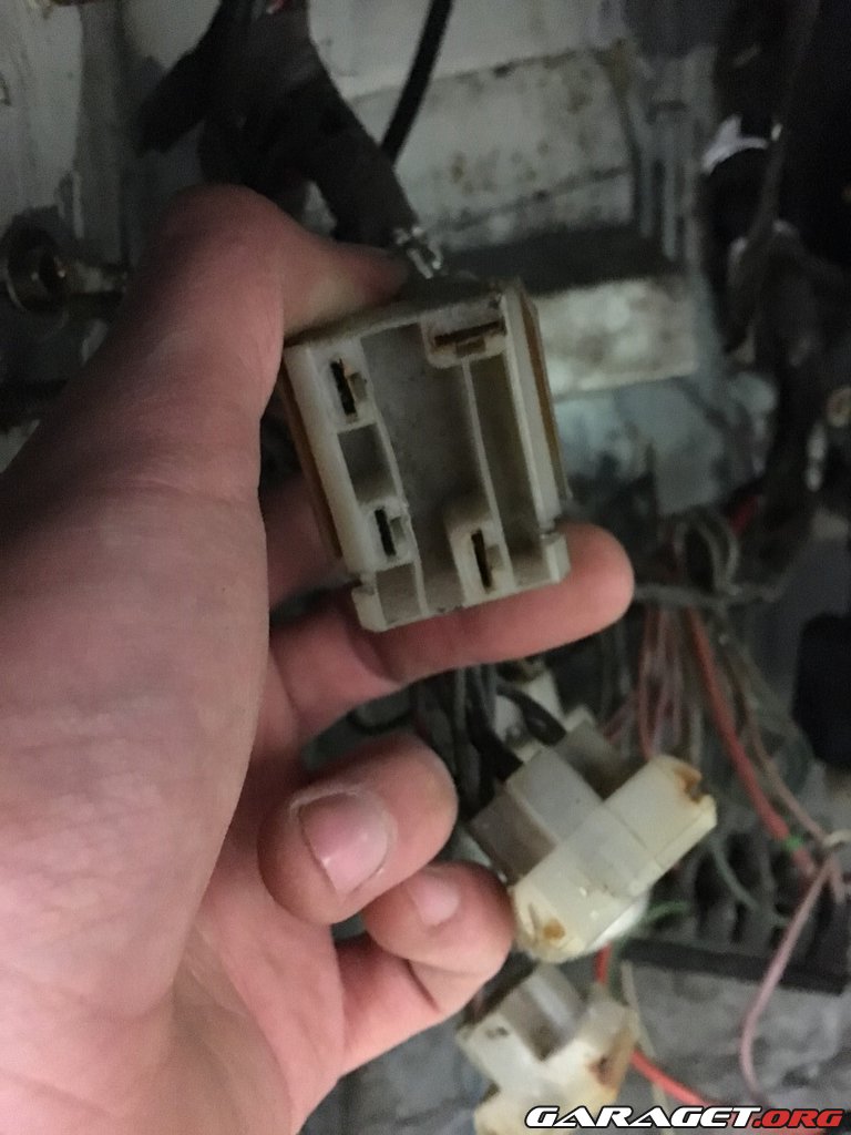

While we're on topic of relays and plugs, do you know where I can find this relay?
