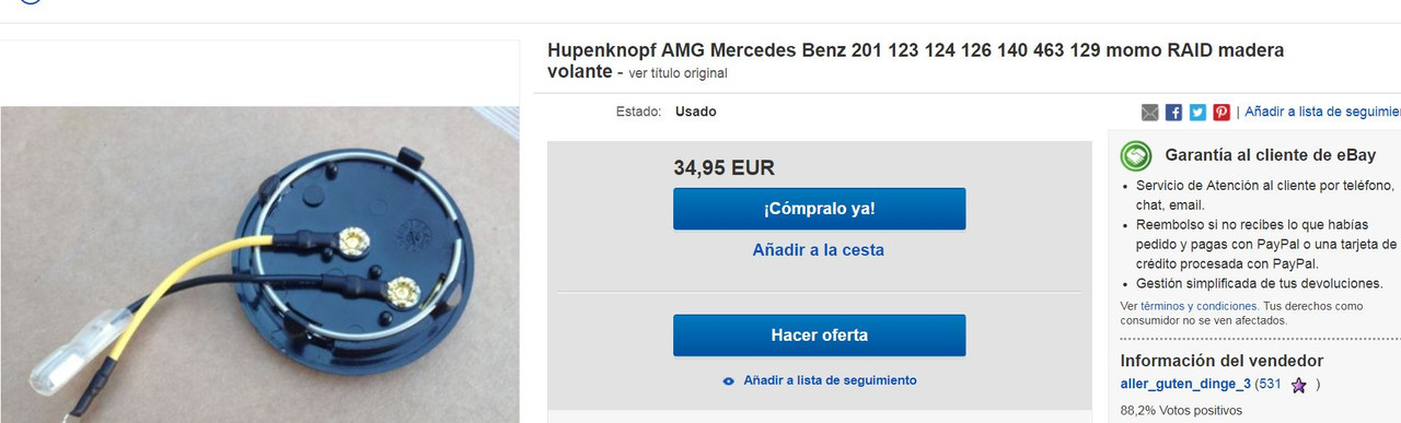

just to add a clarification to this button
the connectors are not correct for the e9 or e3
not in this add, but in his other add for AMG button there are more pictures, you can see how this button is made, he added 2 terminals to the back of the button:
the button has no perimetral contact ring for ground, so you can not use it or you have to make your own ground in your wheel
this is why this button does not work in our cars
probably that is also the reason for his bad feedback ?

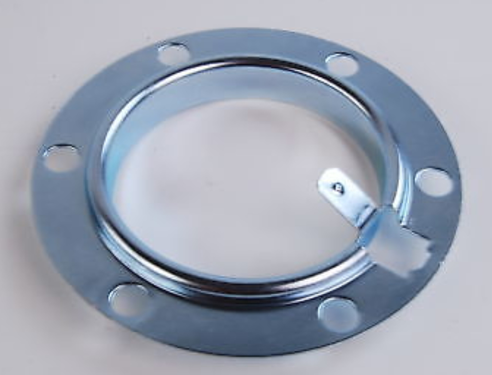

You can still use those two wire buttons with a horn mounting ring. The primary purpose of this ring is to secure the horn. Later momo hubs are lug centric don’t have a lip to center the wheel and mount the horn. This ring has the needed lip, but also has a ground tab that the second wire can fasten to.
The ring is upside down in this pic.
