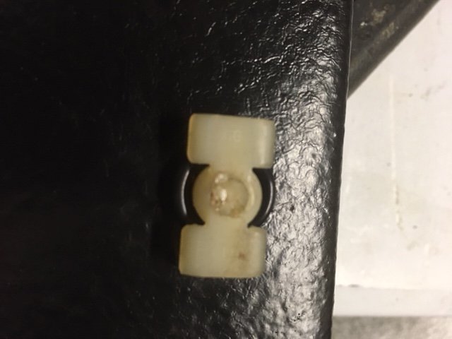

1) As already posted, one can use a nylon washer under the "H" clip (size/thickness?) or what I used (see image) , a #11 N-Butyl O-ring. Both allow the clip to protrude out to engage the trim. I also applied WD 40 to each clip which really helped to get the molding to snap into place. (I also sprayed WD 40 along the entire molding to make it easier to remove when I started this process).

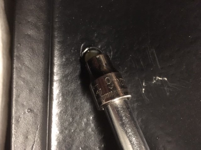

3) Sometimes the clips would not engage despite using an O-ring and pushing down on the molding with a lot of force. Even though I supported the back of the rocker panel cover with a socket when knocking in each plastic "H" clip, still it caved in a bit and I realized it made the molding snapping into the "H" clip difficult. Thus, after each "H" clip installation, I used a 9mm socket on and extension on the inside of the rocker cover. The 9mm fits over the "H" clip flared part that holds it in place. Banging out each gently, allowed the "H" clips to protrude enough to engage the trim (see image).
