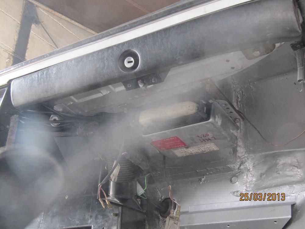

Here is the situ in my car:
http://i1160.photobucket.com/albums/q491/arnie911/cs resto/zusammenbau/IMG_3804_zpsa88b970f.jpg
cheers
Ingo
