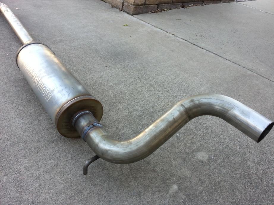

Just as a follow-up, here is what I ended up with:
Magnaflow 12646 (6" diam, 18" long body), Magnaflow glasspack (4" diam, 26" long), 2.5 in piping with mandrel bent tail pipe due to the tight bends.
Observations (and my rough guesses) compared to my stock 40yr old muffler with the same 26" Magnaflow glasspack:
-idle is ~20% louder
-cruising on the freeway is somehow about the same with no drone at all
-accelerating normally is ~25-30% louder
-accelerating hard is ~50% louder
-less torque on the bottom end, but with better breathing and a gain above 4k (I think it maximized the potential of the long-tube header)
I've read on e28 forums that this muffler can be really loud, but I think the big glasspack really helps it out.
Thanks for the comments and suggestions earlier.
