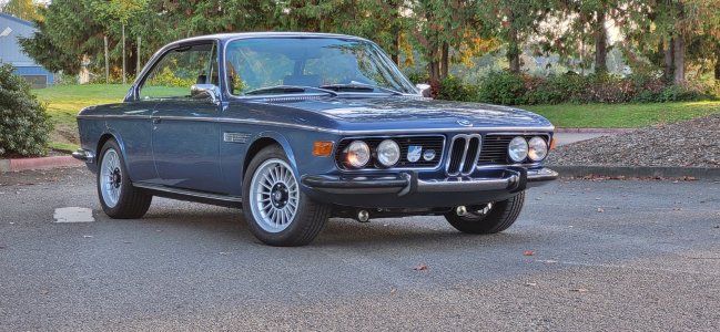

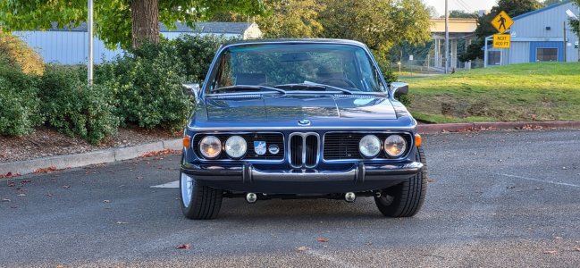

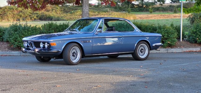

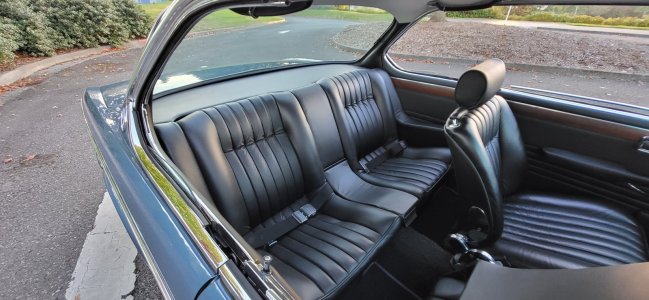

My car is finished- after nearly 6 years of work.... :)
lip277
859
636
Seattle
I had this buried in a different thread but thought I would post this info in its own thread (Had a couple of folks say they never saw my earlier post, so - here we are all by itself).....
This is an edited version of what I had earlier....

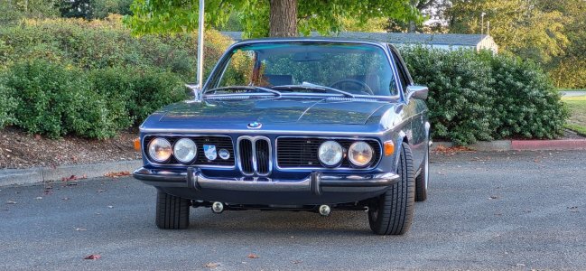

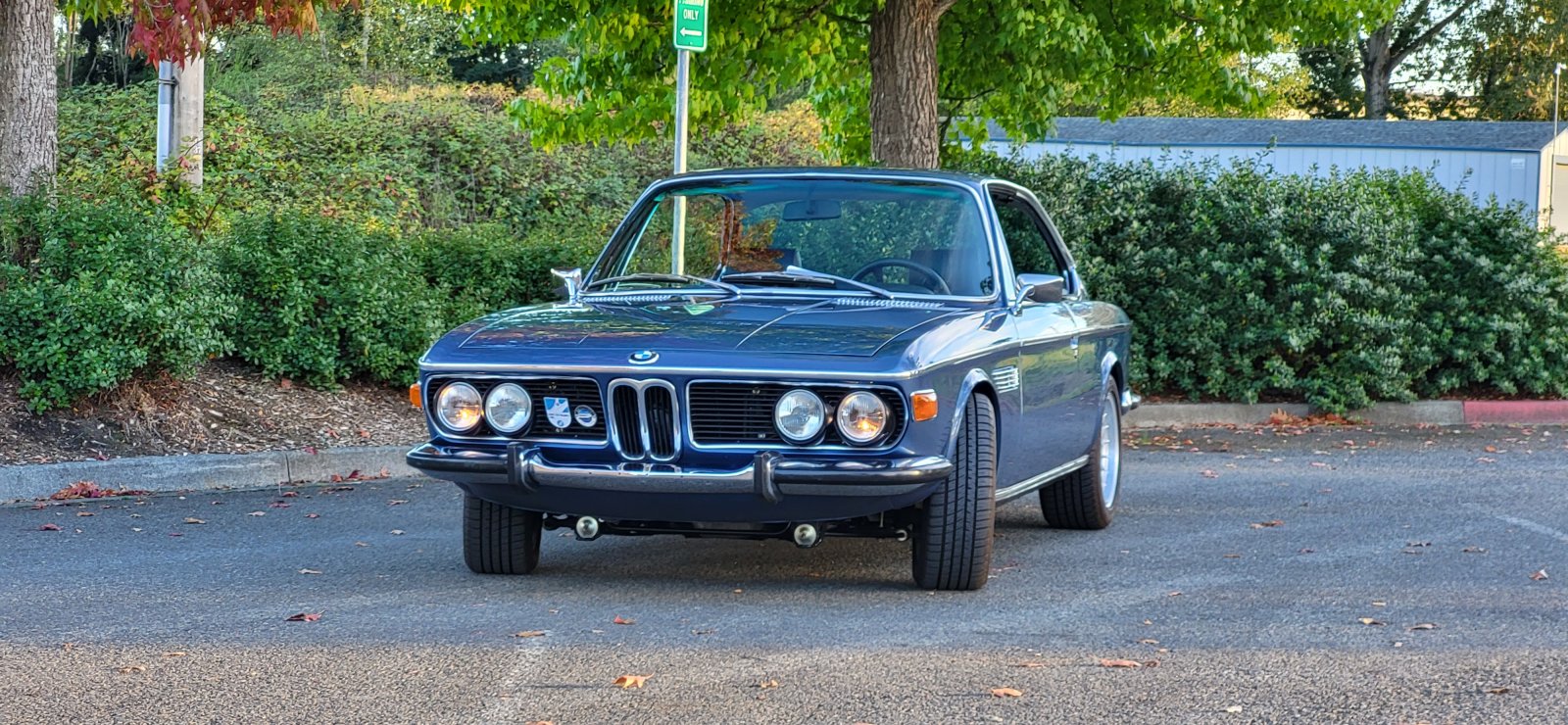

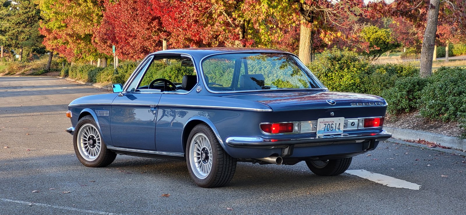

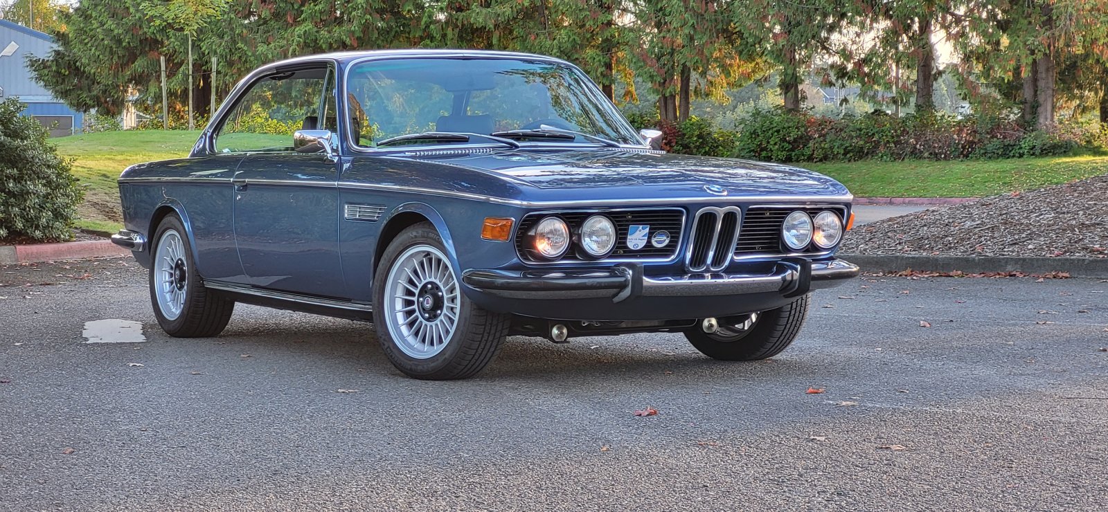

In 2008 I purchased a 1970 CS from Tony (Velocewest here on the E9 forum -if any of the oldtimers remember him).
It was a decent driver quality car - but that was all I was wanting. It was a fun car to have and turned heads everywhere I went.
But it had issues... Trans crunched... engine over heated... heater had to be bypassed as it leaked, there was an electical short in the dash... All sorts of fun stuff you have with a 50 year old car.
I had been visiting with SFDon a few times about what he could do and in 2016 finalized the plan.

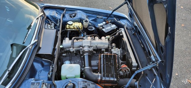

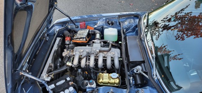

The original 2.8L carb'd engine was toast, so I had Don put together an M90 with Megasquirt for me.
Tony provided me a Getrag 5-speed when I bought the car - so that would go in.
The AC as installed was non-functional, so I was going to have Don get that going....
And, I was also having the brakes updated to the later E9 setup. I had the trailing arms as well (also from Tony).

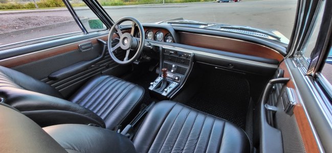

Basically - My intent was to keep the body and interior mostly 'as is' while jazzing up the running gear and taking care of the mechanical stuff.
Basically make it a bit of a hot rod. :)
The car goes down in October of 2017 and he gets started.
So what started out as the intent to have a hot rod with a 20 foot paint job (with nominal expense) became a 'full meal deal' restoration resulting in a car that will look as good as it goes.
The 6 year part of this is a combination of circumstances... on both ends (Don's and mine - and COVID) and in the end worked out as well for both of us.
Well, long story short... To fix the A/C, the dash had to be removed.
In so doing, rust was discovered. That and the other things the folks doing the restoration found that 'should' be fixed had me give the green light to a 'full meal deal' restoration (so to speak).
Those that know Don will smile (and know how this sounded) as I explain how the day unfolded when the rust was discovered.....
~10am - Don calls me to say that as they are removing the dash they found some rust. Concerning, but not crossed the line to having any other impacts.
~Noon - Don texts me that the dash is almost out and more rust found. Still not 'crossed the line'
~3pm - I get a two word text. "You're F*&^ED" LOL

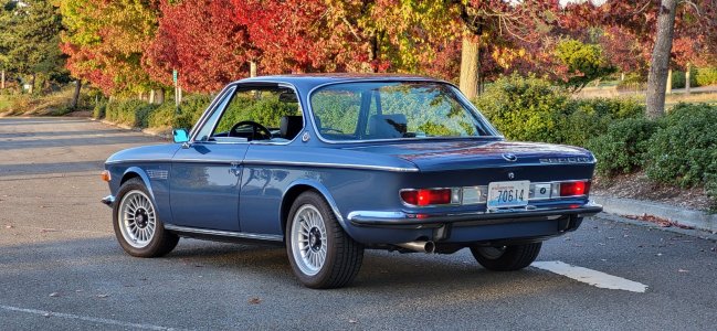

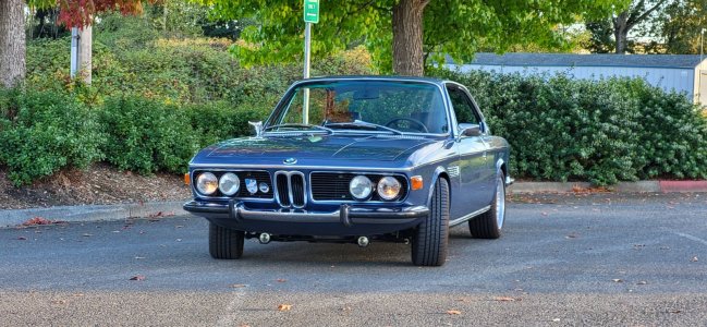

So... Now instead of a 'below the radar' car with a bit of HP under the hood, it is a 100 point concourse worthy car that I will sweat like crazy every time I drive it - LOL....
Kind of like the Mustang I have in that regard. But drives a whole lot better. The rust was repaired and other minor body stuff fixed. The paint was redone in its original Baikal by a shop near Don that usually works on million dollar Ferrari's and Bugatti's - and as this was going on just when they had a bit less business working on those cars, so they were able to do my car without too much fuss. They did an awesome job. Yeah - I paid for it - but in the end, the body now matched the quality of the rest of the car.
While I did not intend to have a 'trailer queen' quality car - I am glad I did it. And more glad it is finally home.

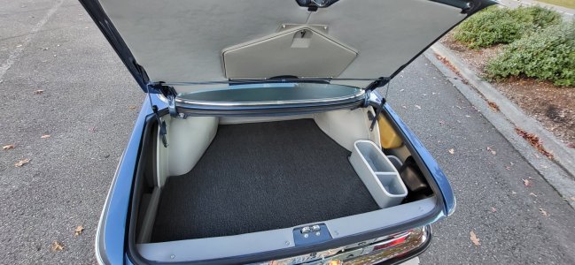

On a side note, I had been collecting parts off and on since I got the car.

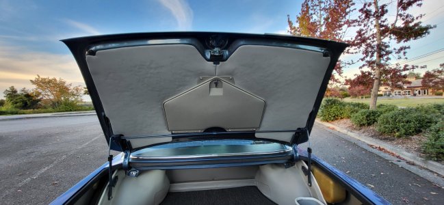

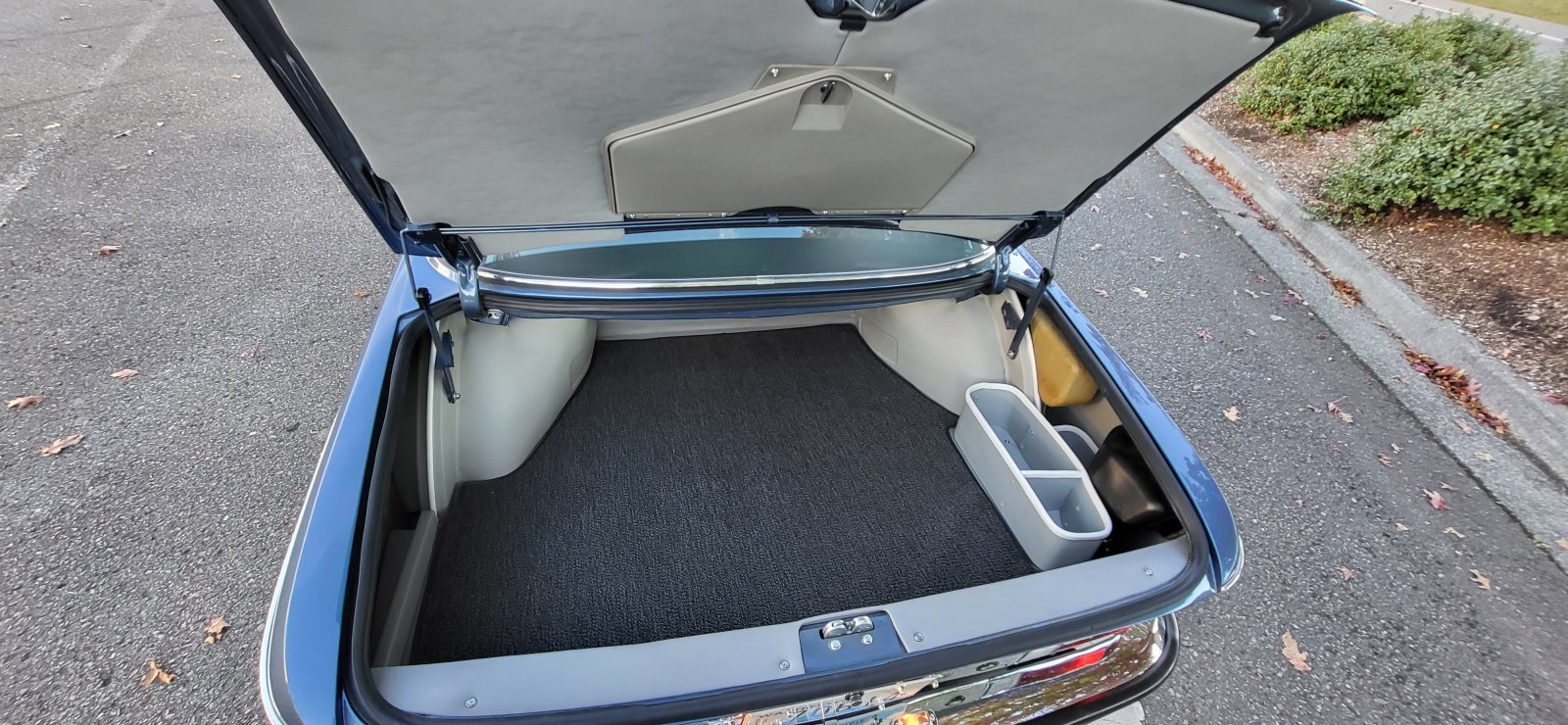

One of them is a new toolbox (that I got when BMW started making them again - several years ago).
One of the others is a new (to me) coolant expansion tank. I bought it from Murray Fowler (Bluemax) when he had a 'garage sale'. I had Don fix it up and install in place of the original one I had. I l love the brass polished look it gives the engine bay.
See pics below....

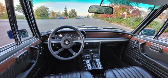

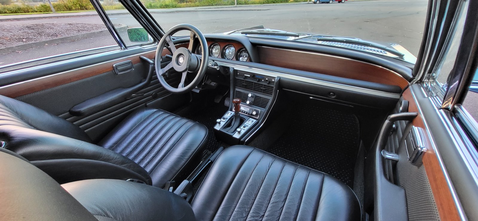

  • @bela22 Did the dash wood for me back in 2016/2017 or so. Looks GREAT. I had the hole for the center speaker removed and had the wood run straight across the front. I really like the cleaner look.
  • Speaking of the speaker (or the stereo anyway) - I purchased a reconditioned Frankfurt Blaupunkt radio (from http://www.vintageblau.com ) and installed two speakers on the panel below the rear seat. Not audiophile at all - but when I want to listen to a Mariners game - I can. :) And had the original 1970's look (with aux/Bluetooth input - I think - although I have not played with that yet).
  • I had Don install a USB phone charger in the glove box as I found the cigarette lighter in the console does not play well with the chargers we have these days for cell phones or such. Works great. That allows me to have my phone on the dash connected with a short cord going to the closed glove box (there is enough of a gap around the glove box door that the cord is not pinched in do doing).

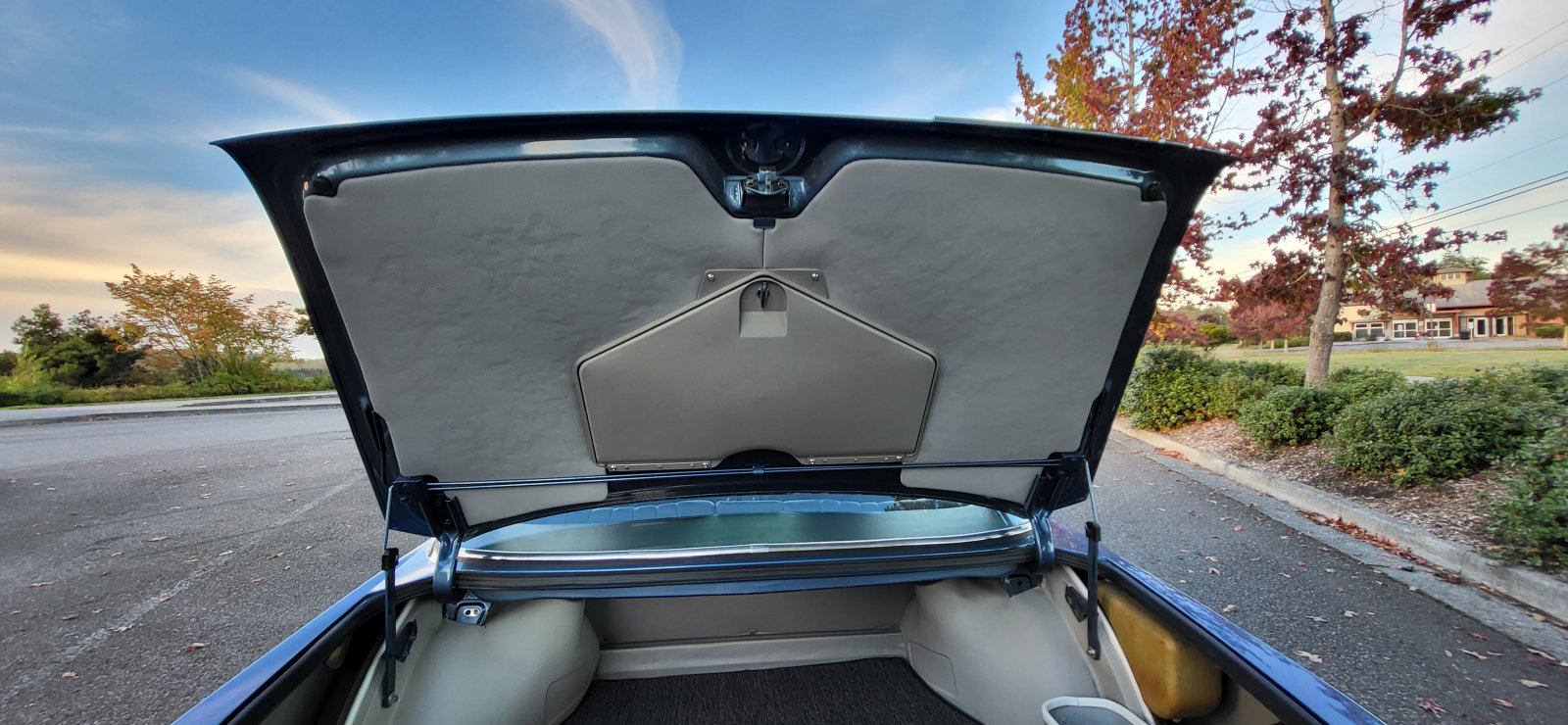

  • I do not keep tools in the took kit on the trunk lid as... I just don't want that much weight there.....
  • The car went to Don with a set of decent reproduction Alpina wheels (F/R same size). While there, he worked a deal for me with another car for upgraded staggered (and nicer) repro Alpina wheels - with good Michelin Pilot Sport AS tires. That makes my E38, E23 and now the E9 all with those tires. I should write Michelin to see if they want to sponsor me. LOL He placed my wheels and tires with another car that he had. We're all friends . LOL
  • The AC actually blows cold. Decently so.
  • I still have the muscle memory for that whenever I try to start it - I keep wanting to pump the throttle a few times, then I remember it is now fuel injected.

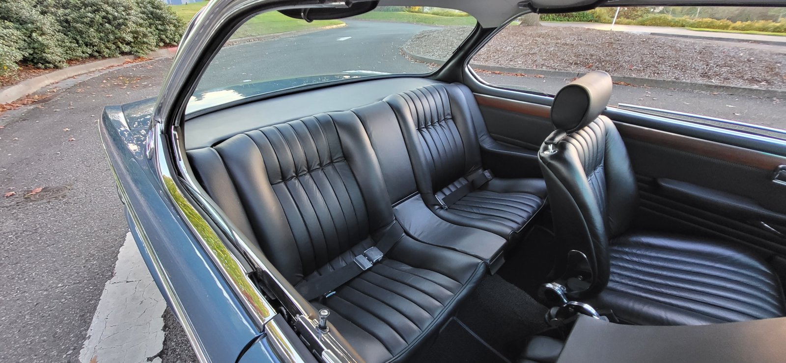

  • Don (Chris actually) installed sound deadening material all throughout the cabin. Not that it is as quiet as my E38 - but it is decently quieter than it used to be. That material and new door and window seals did their job.

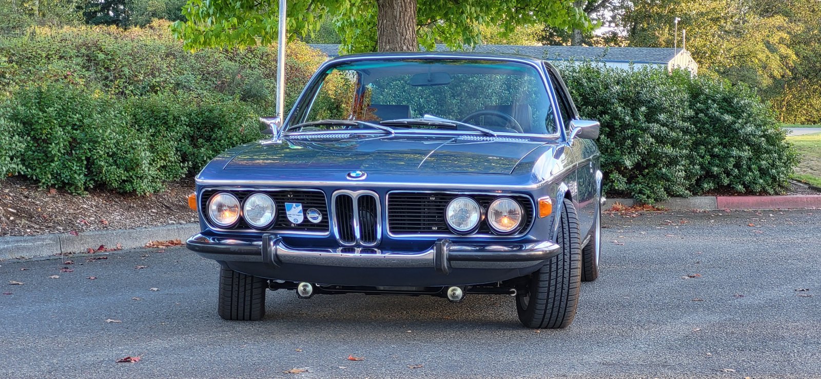

  • The headlights... WOW. I have driven it once at night now -and... :) Love them. I believe Don used the OE European set up but ran power for all bulbs straight from the battery (through relays and such). Very nice. The lights here give my E38, 997 and my Escalade a run for its money (and I think is better in some respects). Looking forward to some evening runs when the weather permits.

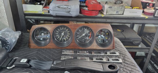

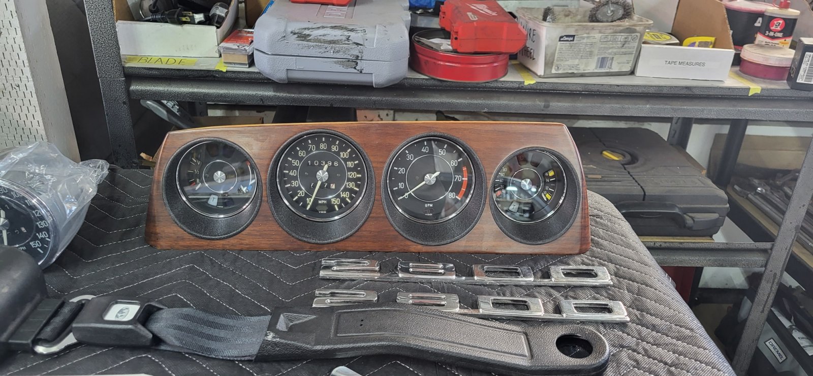

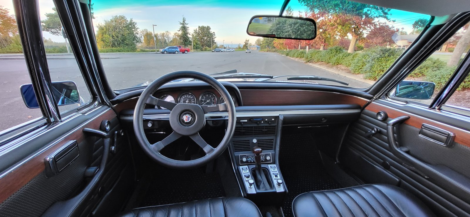

Oh - and one more mod I had Don do...
I found (on eBay I think) another fuel/temp gauge for the E9.
It was converted it to show volts and oil pressure instead.
I removed the clock from the right position on the dash and installed this in its place.
I had that info on my 2002 (VDO gauges installed in a custom console face that I made) and found it very handy to have.
I wanted the same info available to me in the Coupe...
So... Another 'thing' to do when the car was down there.
Here is a pic of the cluster before it was installed.
Right now - none of the idiot lights are doing anything (not hooked up)
