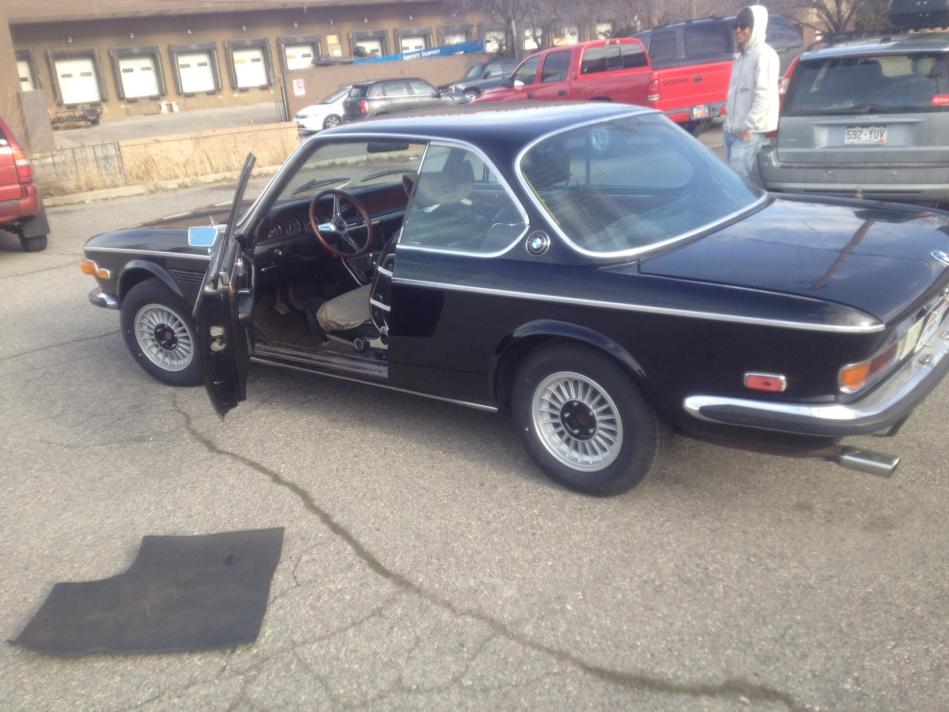

I purchased it last year. The previous owner put in $12K of mechanical work 3 years ago, stored it after the work was done...then i bought it and have basically dry stored it since Jan 2012. I drove her today. Started right up on first try after 5 months. I put re-finished alpinas on it today, then back in storage.

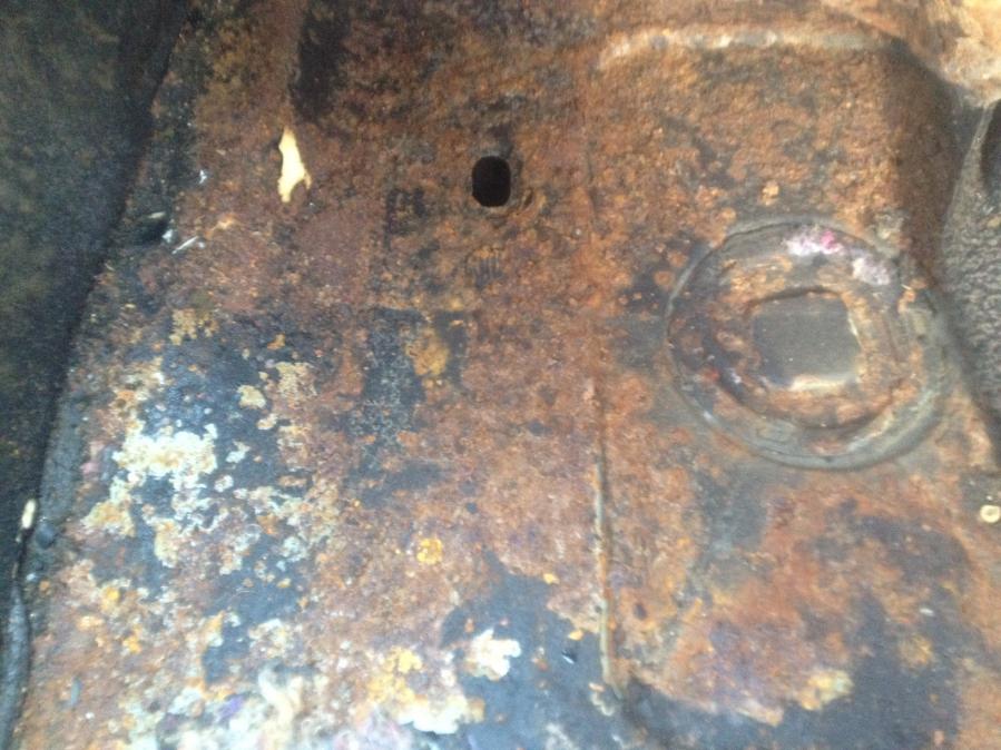

Body/Rust wise: the paint is very tired. originally night blue, now black. no bubbling and without being an expert, rust looks minimal in some of the trouble areas, EXCEPT...the floor boards. Holy cow. I only lifted the passenger carpet and deadening, not the driver. I'm SURE there is rust in other areas (of course there is, but I can't see it), but looking around nothing is noticeable besides the floors in the typical trouble spots (wheel wells, pillars, trunk, etc). But LOOK below at the passenger floor board photo taken today. Mein god!
My plan WAS to have her stripped, repaired, and painted next winter, but I wonder if based on these rusted out floors and an ASSUMED extrapolation that rust is certainly in other areas... if people would advise taking the stance of driving her as is until she expires without fixing the floors, etc, OR putting in $15K of body work, etc. I have no idea what floor replacement costs??, but can only imagine... The puzzle here is that mechanically she's really really sound, especially with all the new work (see below). The interior is solid, refinished wood, seats and trim and headliner all tidy.
I don't know how bad rust will be in other areas when stripped, and basically I'm at a point of TOTAL confusion and in need of advice as to what to do. Can anyone relate?
A) Invest and go all in, resurrect her (guessing $15K, maybe that's off?)
B) Drive her 'as is' until she expires one day.
C) Sell her (unclear to me even how much she's worth--I paid $12,300)
Advice and/or condolences?
I was planning on the strip and paint and had budgeted $7-10K, but now seeing the floors and guessing there is more rust lurking, I just have no idea where that could run...

From the picture attached, which as you said does not represent everything, I would not let that deter me. The seats and carpet are easily removed and if you can get it on a lift you can do some pretty extensive poking around. You can pull off the rocker covers (sharp Philips screwdriver) and then look in all the trouble areas. Again, from what I see... you could drive it and fix little things as you go. Just my 2 cents. I attached a picture of my floors and I took the entire car to bare metal after I found this. There were a few holes in the spare tire well and that was all. The front floor replacement cost me about 600.00, which was 399.00 for the floors and less than 200.00 to have them welded in by someone who knew what they were doing (a friend who did lots of mustangs), but this was his regular rate. Go for it- whatever you choose!

Thanks Peter! That photo is probably representative of what mine looks like peeled away (i'm guessing) and makes me feel a bit better about my investigative work this afternoon..!

That floor might not be so bad. Hit it with a hammer and see if you can go through. If it only dents, clean it up both sides and cover with something like POR 15.
novel approach there Bob ... i would try tapping to see how solid it is, then hit it. rust has a definite different sound than solid metal.

Rust is a funny thing - sometimes it only attacts selected areas. Floors can rust because the carpets and insulation were allowed to stay wet (does your car have a sunroof or a plugged A/C condensate drain?). If you are lucky, the floors may be the only rust area. You won't really know until all the paint comes off the car.
Certainly add floor replacement to your "to do" list while the car is in the bodyshop. But as others have written, the floor replacement won't be big bucks by itself. Your $7-10K budget may be on the light side - a lot will depend on how much disassembly/reassembly you do yourself, and of course, how much additional rust the shop finds.
The dilemma is that once you strip off the paint, if you do find more rust (or poorly repaired accident damage), the value of the stripped car is low - you really would need to finish the body & paint in order to sell it, but it would be tough to recover that investment. My advice is to not look at coupe ownership from a strict economic perspective!
Pull the rocker panel cover (runs between whells wells with a chrome strip attached to it If you find swiss cheese there as well you can plan on spending some duckies. Replacement panels are available and this is doable. can you weld? As nice as the rest of the car cosmetic and mechanical, IMHO opinion the car is definitely worth restoring. My friend here in Florida recently sold his cherry 2800CS for $36K.
