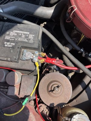

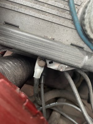

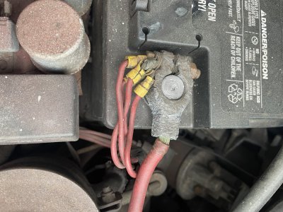

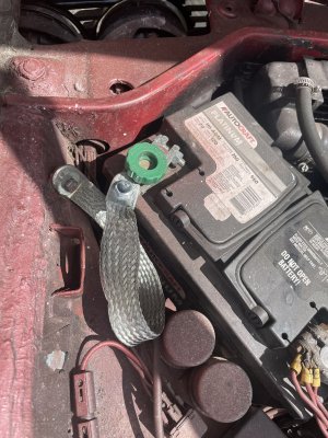

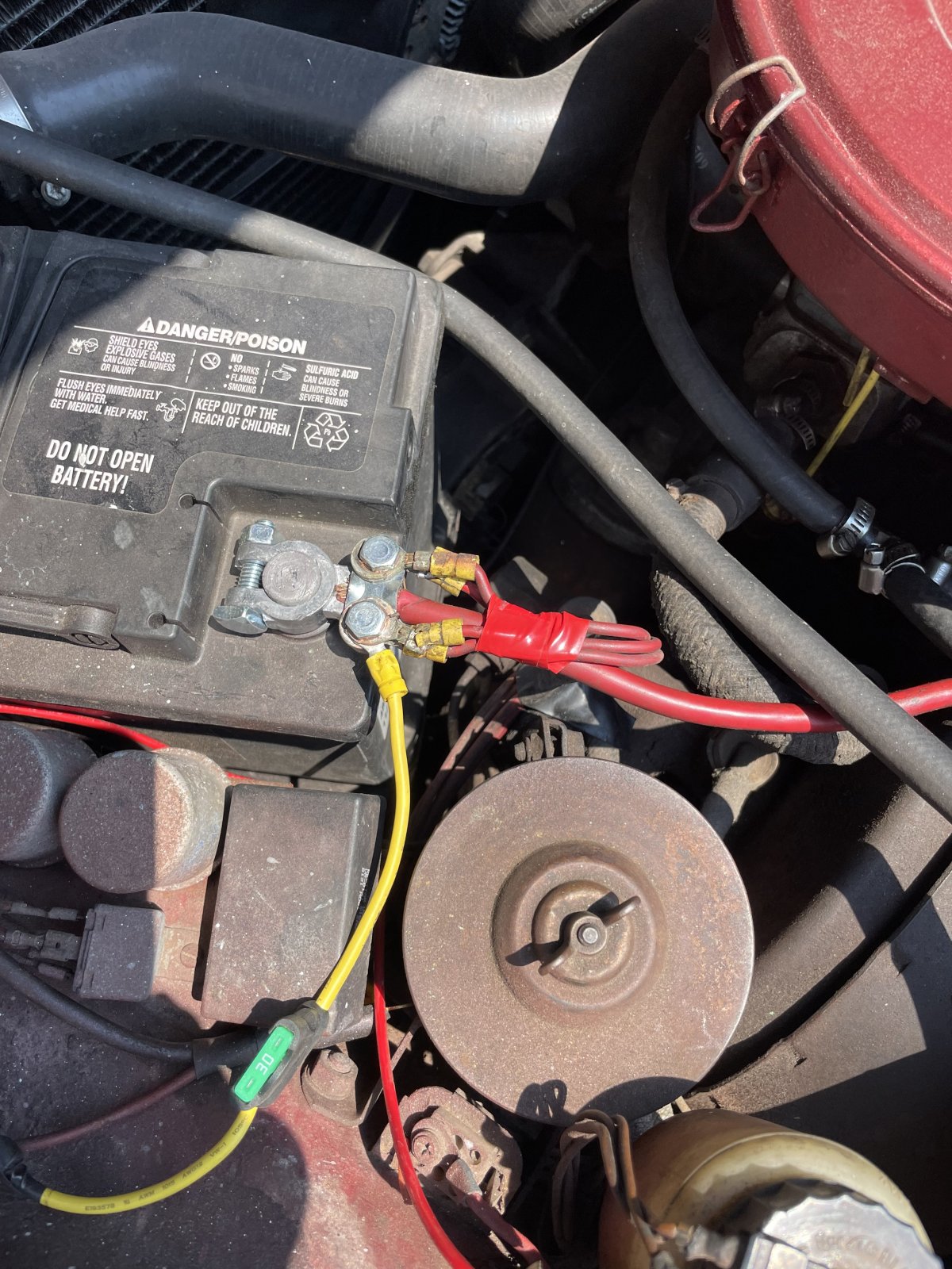

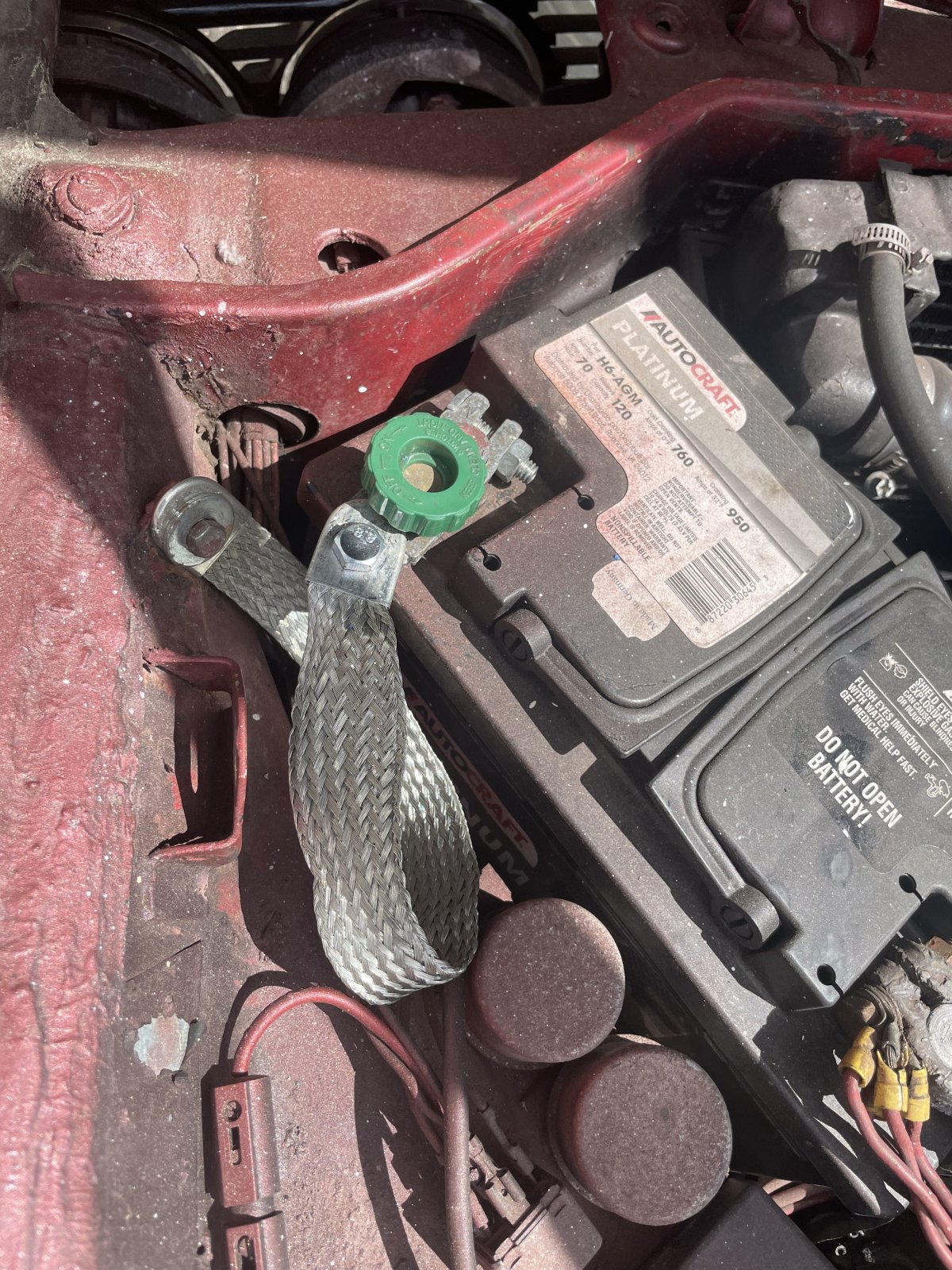

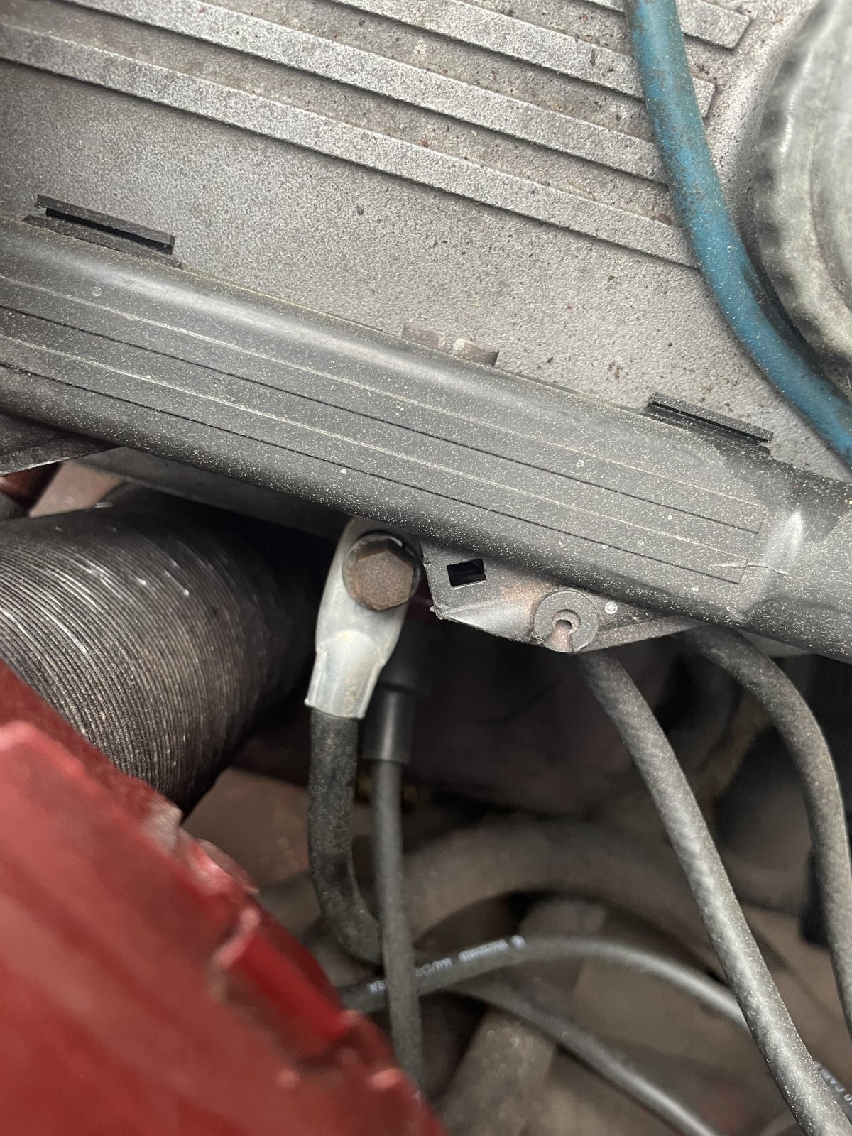

I did a few things over the weekend, more or less to narrow down what might be causing this issue.
First, I replaced both ground strap cables, one at the battery terminal and the other on the passenger side of engine block.
Next I cleaned up the positive battery terminal, putting in a new connection post and re-attaching cables and wires. Additionally, I ran a new fused wire directly from battery terminal to the push button switch that activates the starter.
Since these "upgrades" I'm batting 6 for 6, with no start failures as yet. (famous last words)

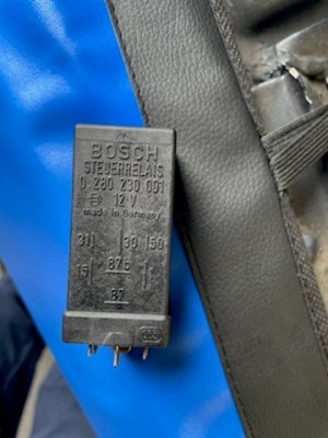

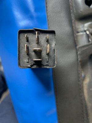

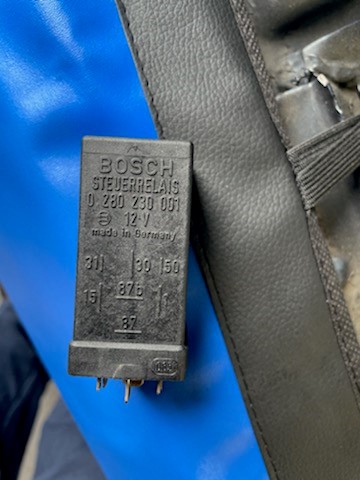

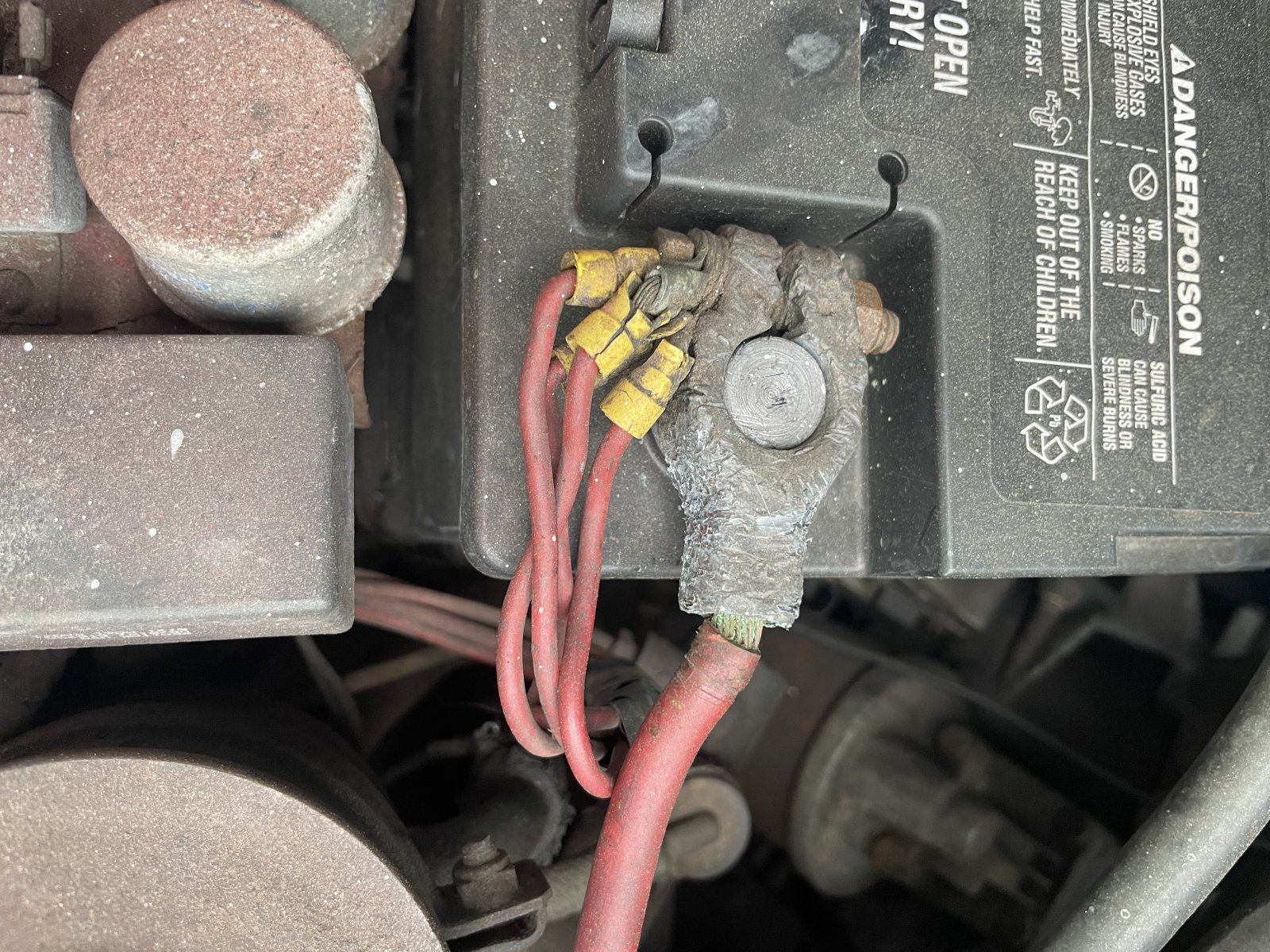

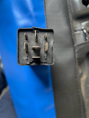

Sounds exactly like the issue/symptoms i had with my 1975 E9 CS. Was especially bad if not driven for 2-3 weeks or if cold weather. Battery checked ok. but car would usually start if added a jump pack or jumped from another car battery. Fuel pump would run. But wouldnt get the 'click' when turning key. dash lights would dim. when it finally started, it was flooded with too much fuel. Once it had started once, it would start OK until left for a while and cold.
Started with the items you list to try and diagnose. In the end, the Auto electrician eventually diagnosed it as faulty relay (old dry internal circuit board). The large complicated relay, Bosch 0280230001. Bought a good second hand one on ebay as they were extremely hard to source new. - haven't had any issues since. Maybe worth checking on yours?

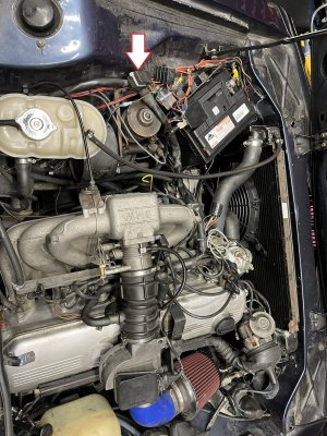

Wow. Another wrinkle.
Can you tell us where that specific relay is located?
And many thanks for your input.
(Right now, I'm 10 for 10, but haven't driven much due to weather concerns up here in Boston)

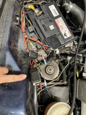

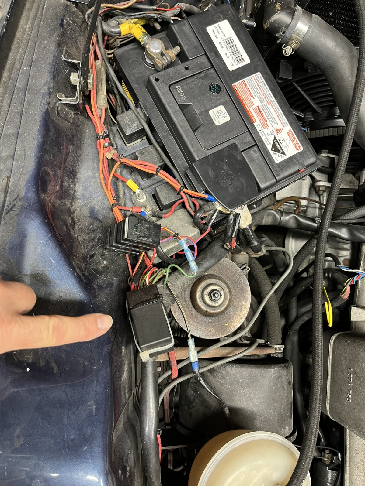

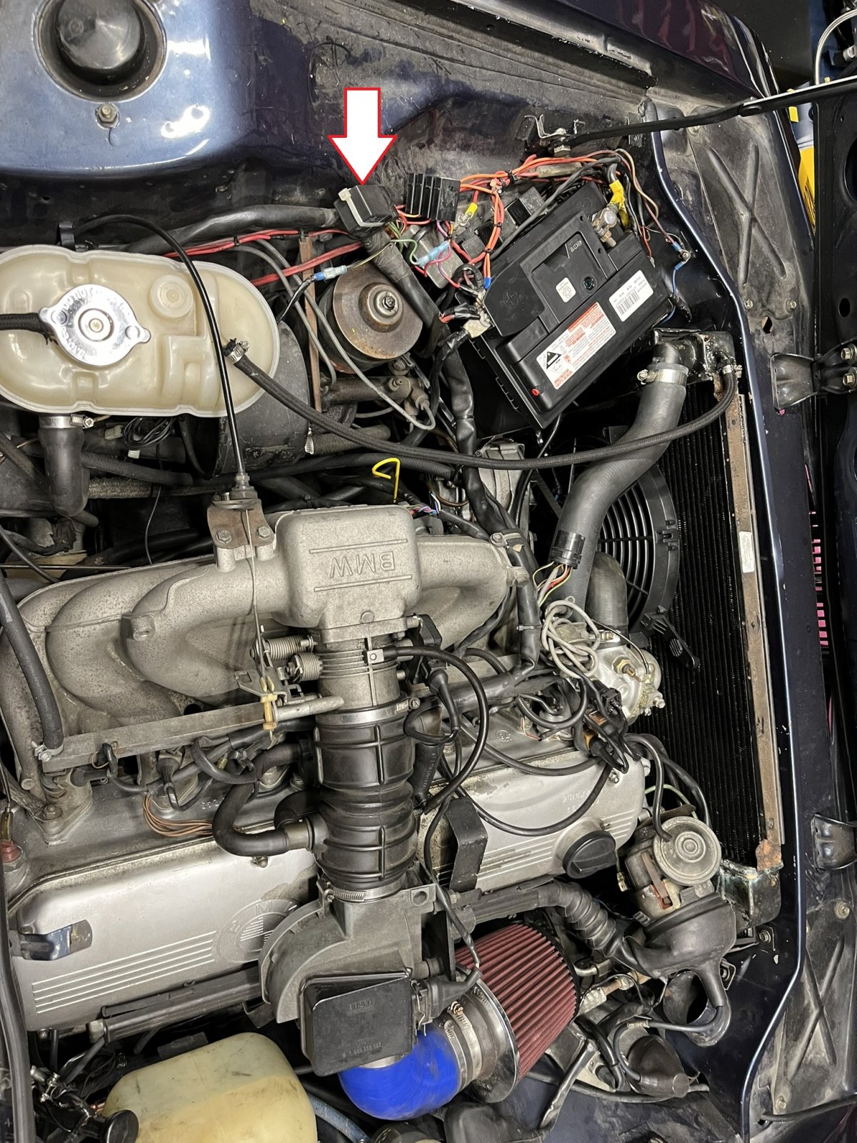

My car has been messed with a bit. but see attached images. large relay next to battery. Must have been located near here originally although mine is no longer secured. I have RHD car. But dont see why it would be different in LH Drive.
