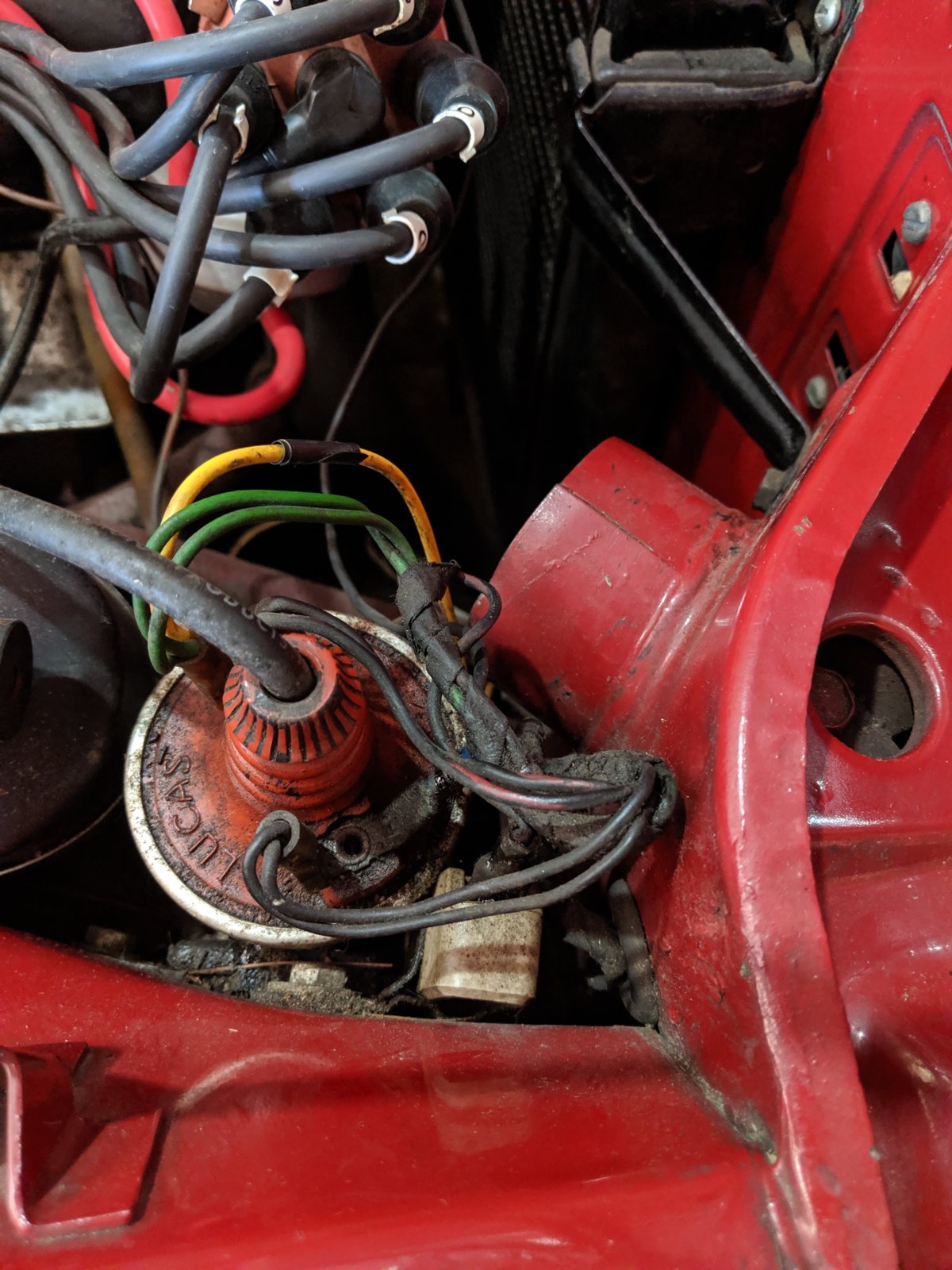

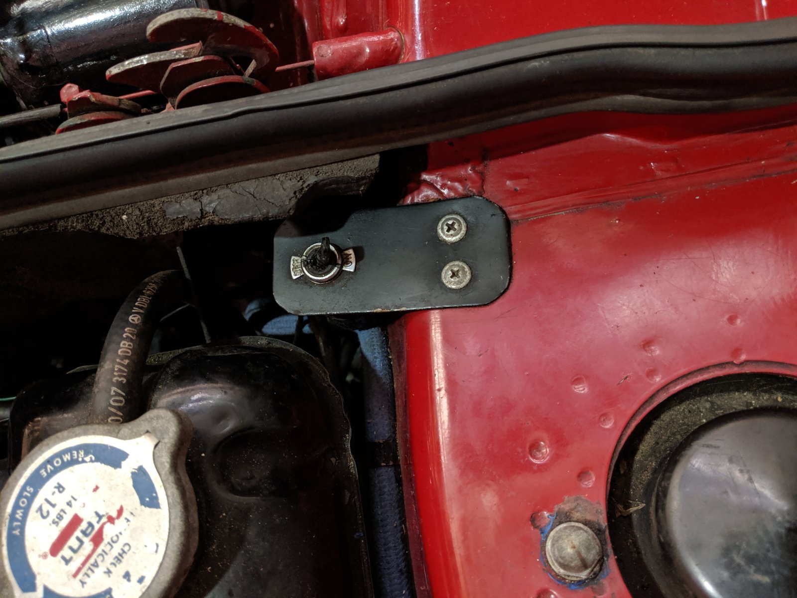

There's a mystery part on my 1970 2800CS. It has an on/off switch and two wires. One grounding to the valve cover and another attaching to the coil. Any ideas what this is?

Grounding the coil will defeat the ignition but I would have interrupted the power wire instead, why send power to a ground even if only while cranking?
Looks like it was an extra wire spliced into the distributor side of the coil. It's getting removed, regardless. Not keen on creating a purposeful short circuit.
