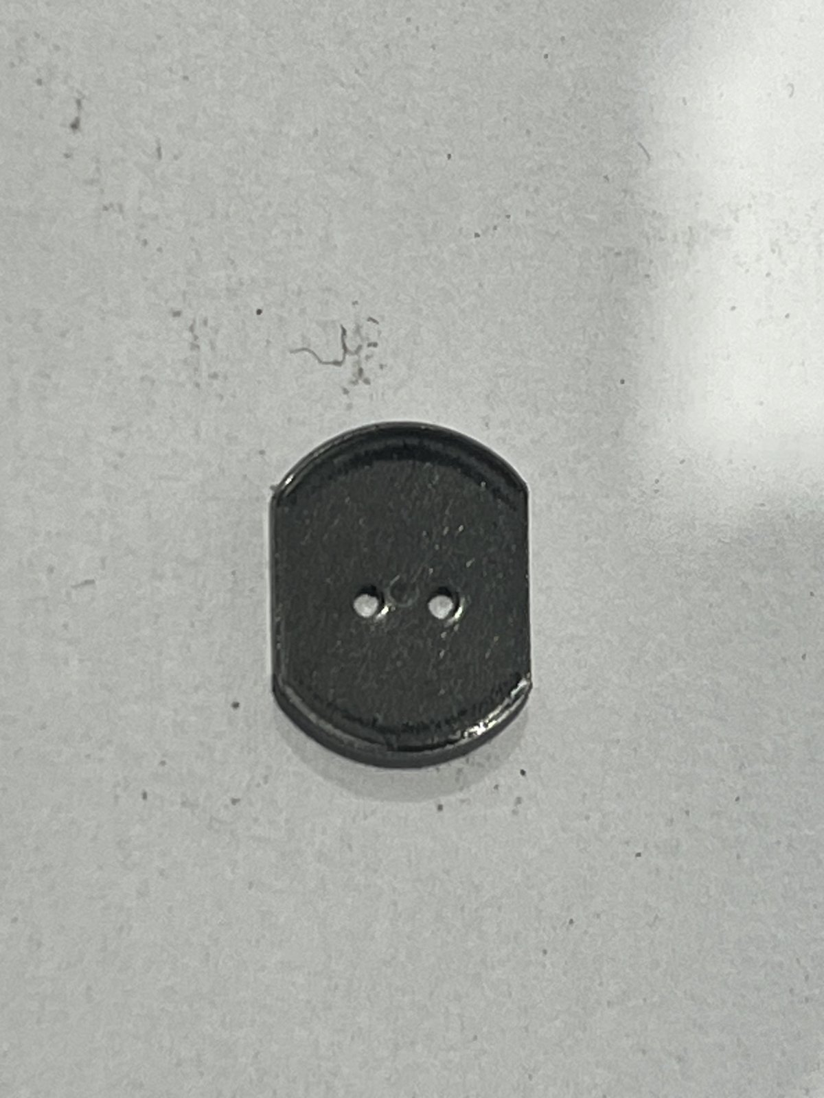

I pulled my m30 down and saw this sitting in the wash up tank. What is this and where did it come from?
Thank you in advance for your guidance.

The banjo bolts of an oil spray bar don't have lock plates.
(If there were lock plates, more M30's would be alive today)
Ai b.s.
Can't think of another answer though.
Looks like a plastic piece?
Not sure about the diameter but from what it looks like I would suggest looking at the oil filter bypass or the oil pump pressure valve. Both have a spring loaded valve that has a plate holding the spring similar to this.
Thanks for the response to all. My first concern was that it was a restrictor that could be essential for oil distribution, i.e not allowing too much flow into some area. Anyway it doesn't look critical and the chain tensioner is going to be upgraded to a non hydraulic system.
