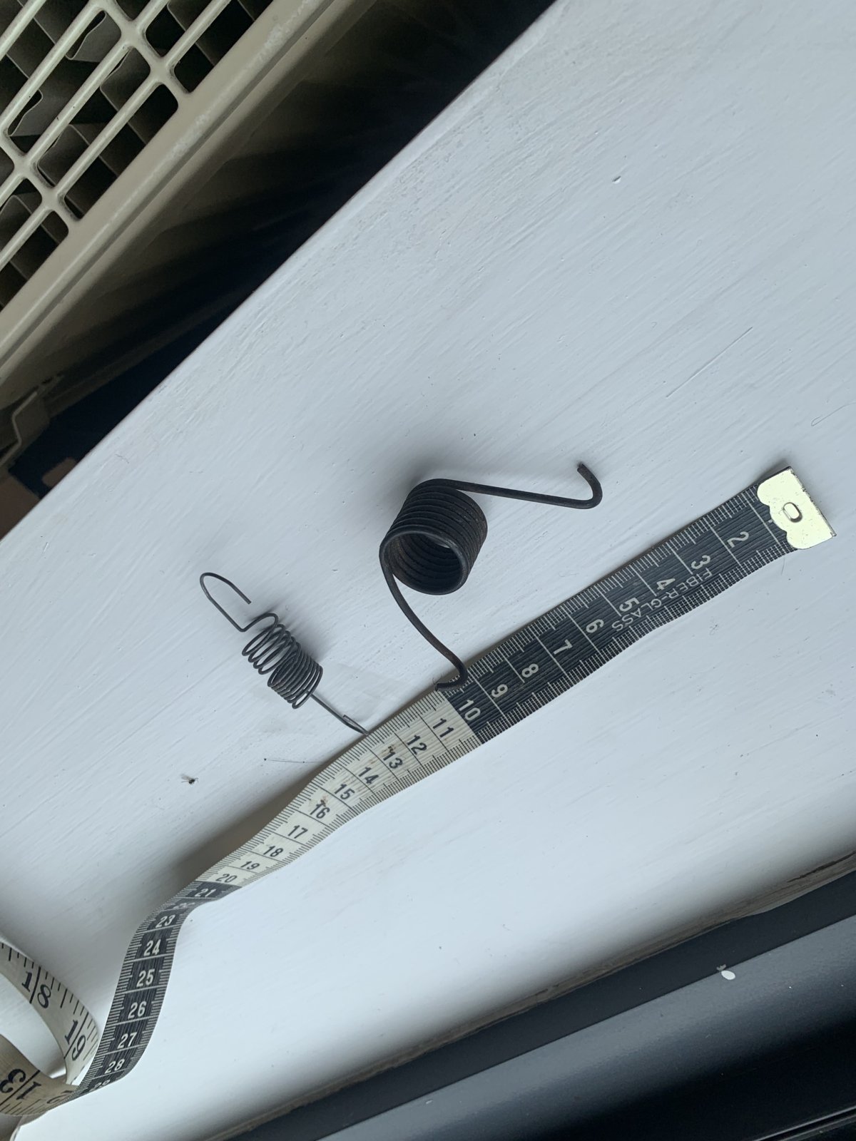

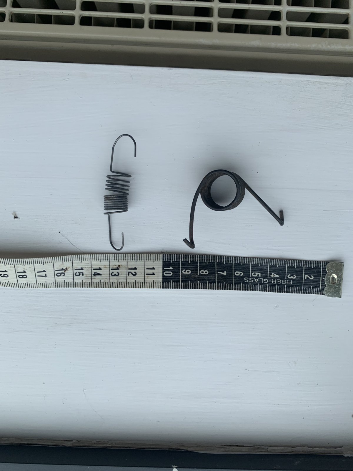

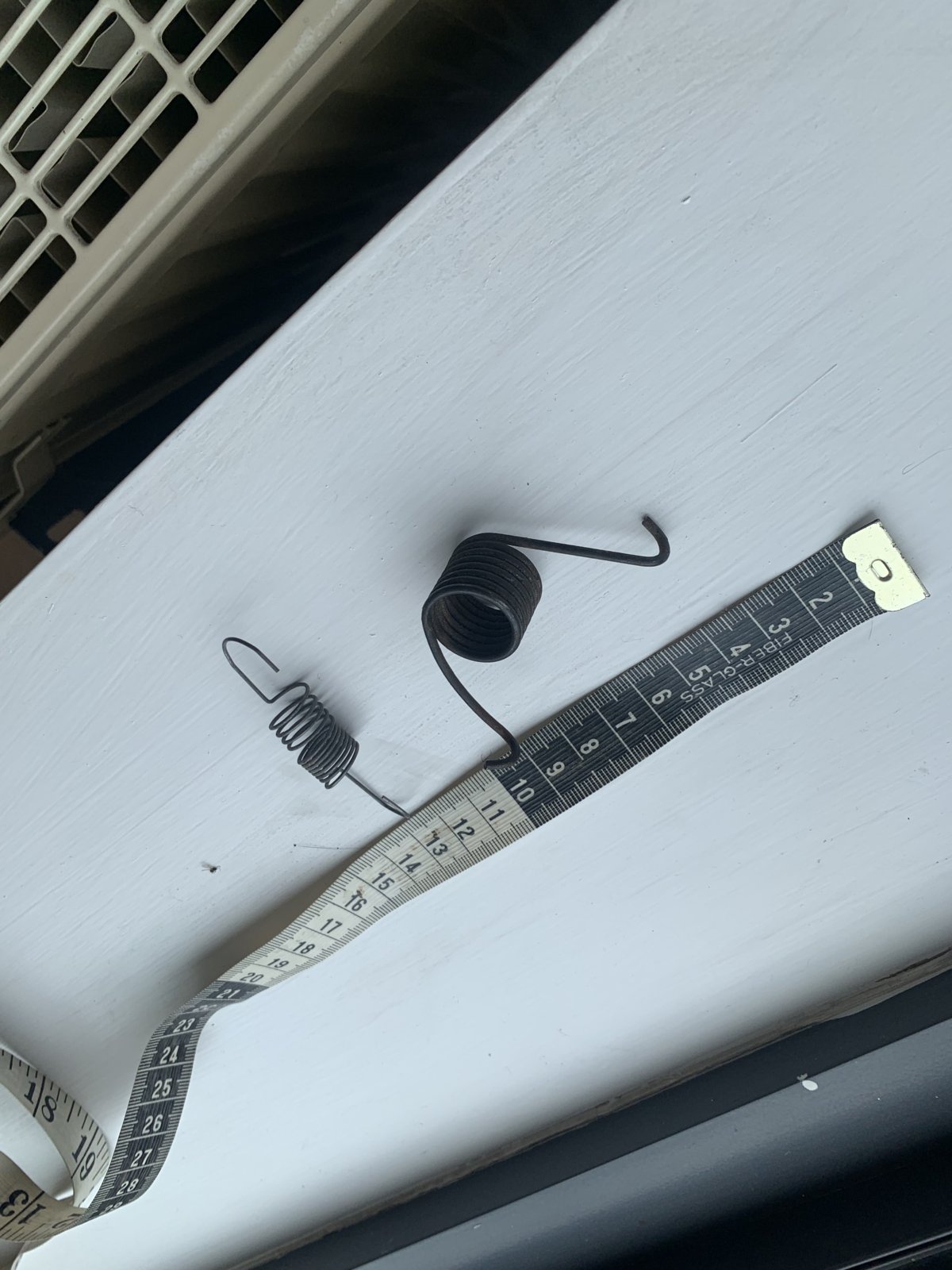

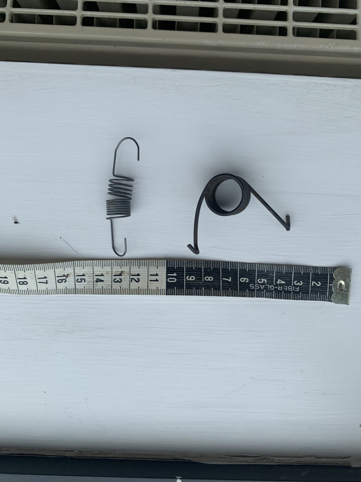

Rek Well-Known Member Messages 1,264 Reaction score 496 Location Islington London England Apr 25, 2021 #1 These were left over after putting my car together. many ideas where they might be from? Attachments CF645138-B40A-4034-805F-1419A70460E5.jpeg 210.7 KB · Views: 227 7F24D500-1FCD-4DD8-B4D6-EB4085AF0A79.jpeg 186.9 KB · Views: 235
Stevehose Well-Known Member Site Donor $$ Messages 13,765 Reaction score 6,744 Location Sarasota, FL Apr 25, 2021 #2 the one on the right looks like a throttle linkage spring
Rek Well-Known Member Messages 1,264 Reaction score 496 Location Islington London England Apr 25, 2021 #3 Thanks. I ditched that for EFI so that’s a relief.

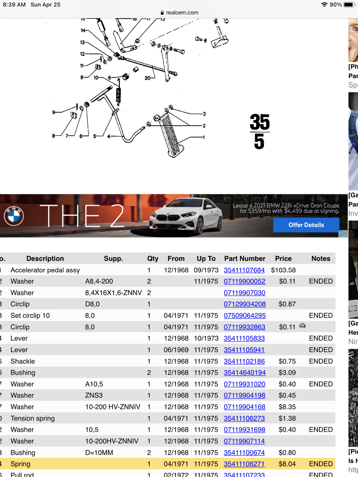

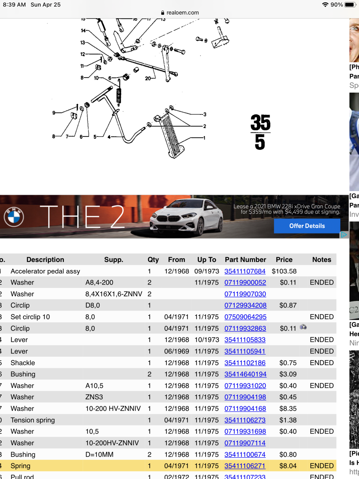

sfdon Well-Known Member Site Donor $ Site Donor $$ Messages 10,170 Reaction score 7,018 Location sfbay area Apr 25, 2021 #5 4 springs needed for proper pedal feel on Csi at pedal at bell crank 2 at throttle body
Rek Well-Known Member Messages 1,264 Reaction score 496 Location Islington London England Apr 26, 2021 #6 I have one there but did not replace the bushes. I will add that to the tasks. Thanks for the help.
