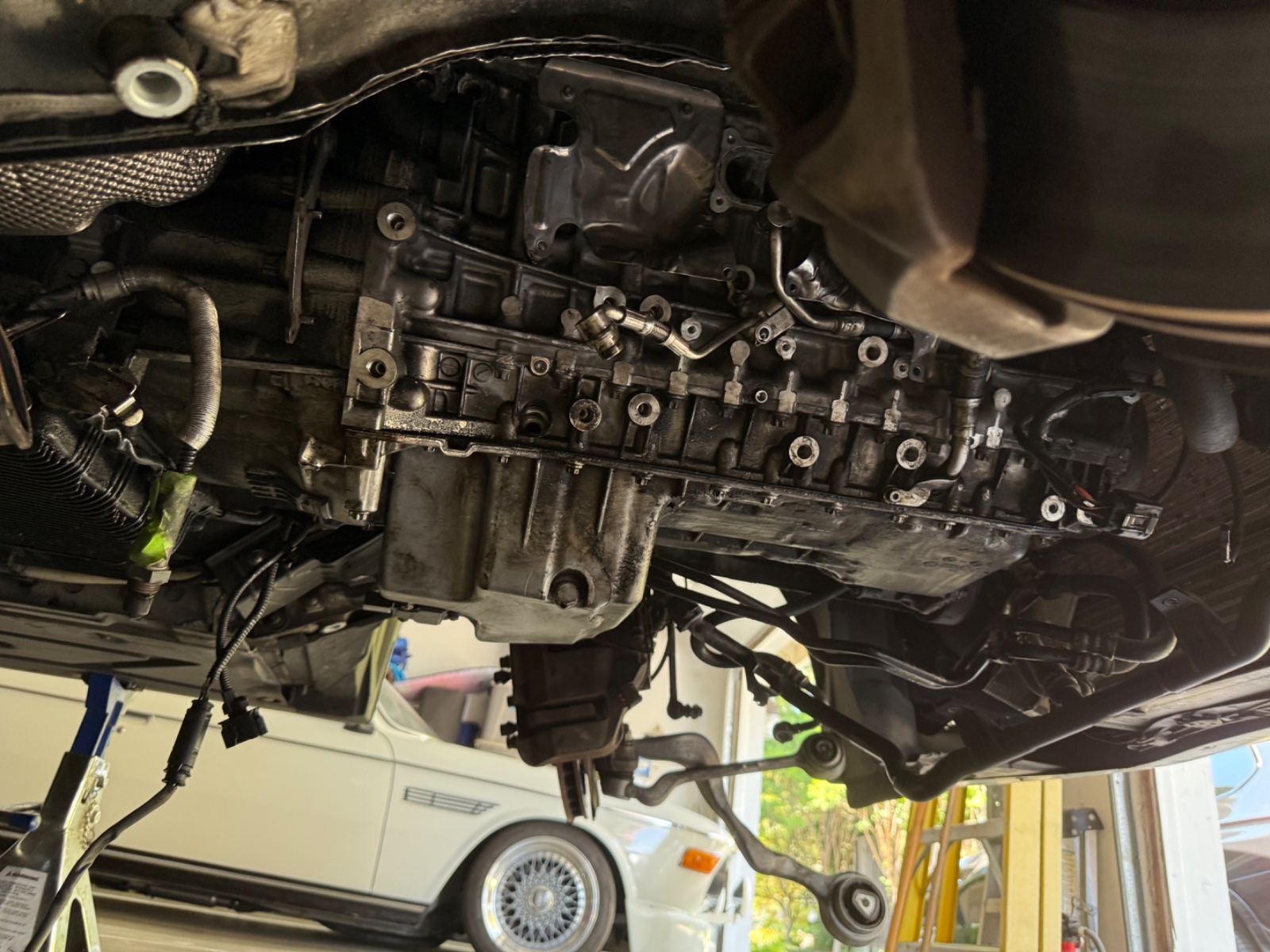

BarryG Well-Known Member Site Donor Messages 964 Reaction score 300 Location Nor*Cal - Rocklin, around the corner from Dan Tuesday at 10:44 AM #1 M30’s are so easy to work on This is my 07 335i with 200.000 th miles Oil pan leak & rear turbo cooling lines fail

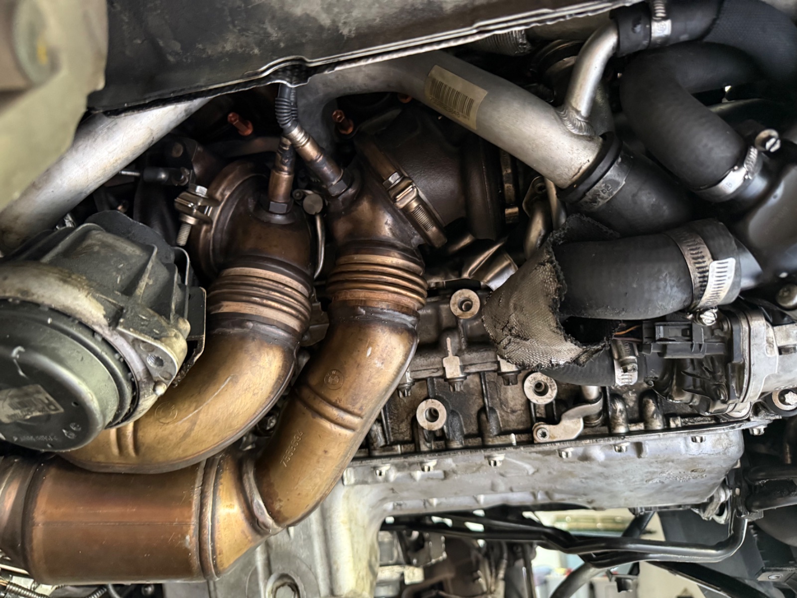

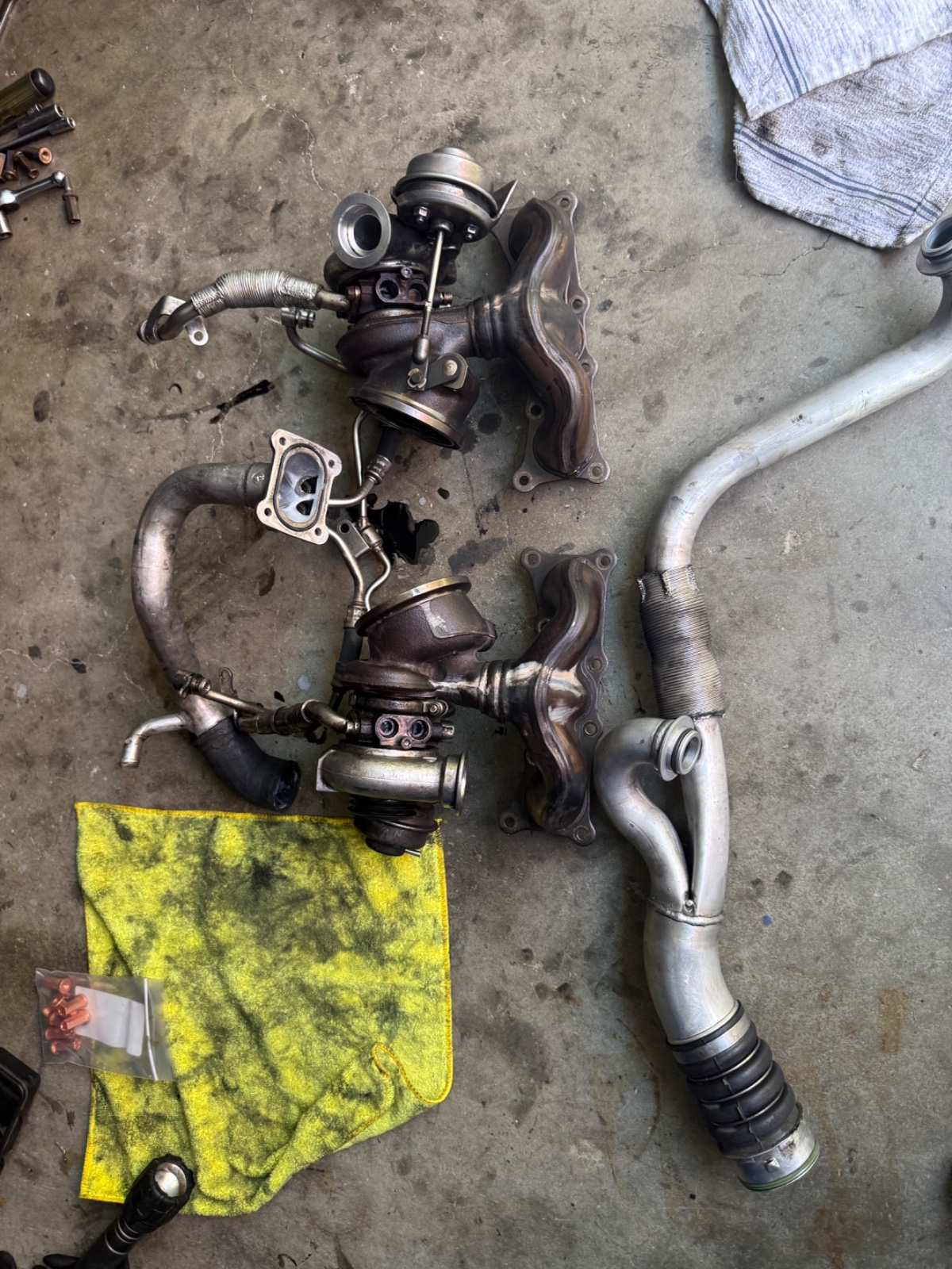

BarryG Well-Known Member Site Donor Messages 964 Reaction score 300 Location Nor*Cal - Rocklin, around the corner from Dan Tuesday at 8:55 PM #3 Well today I found out you need to remove both turbos to get the oil & cooling lines attached. Both go in together with the oil supply line attached Need more o rings
