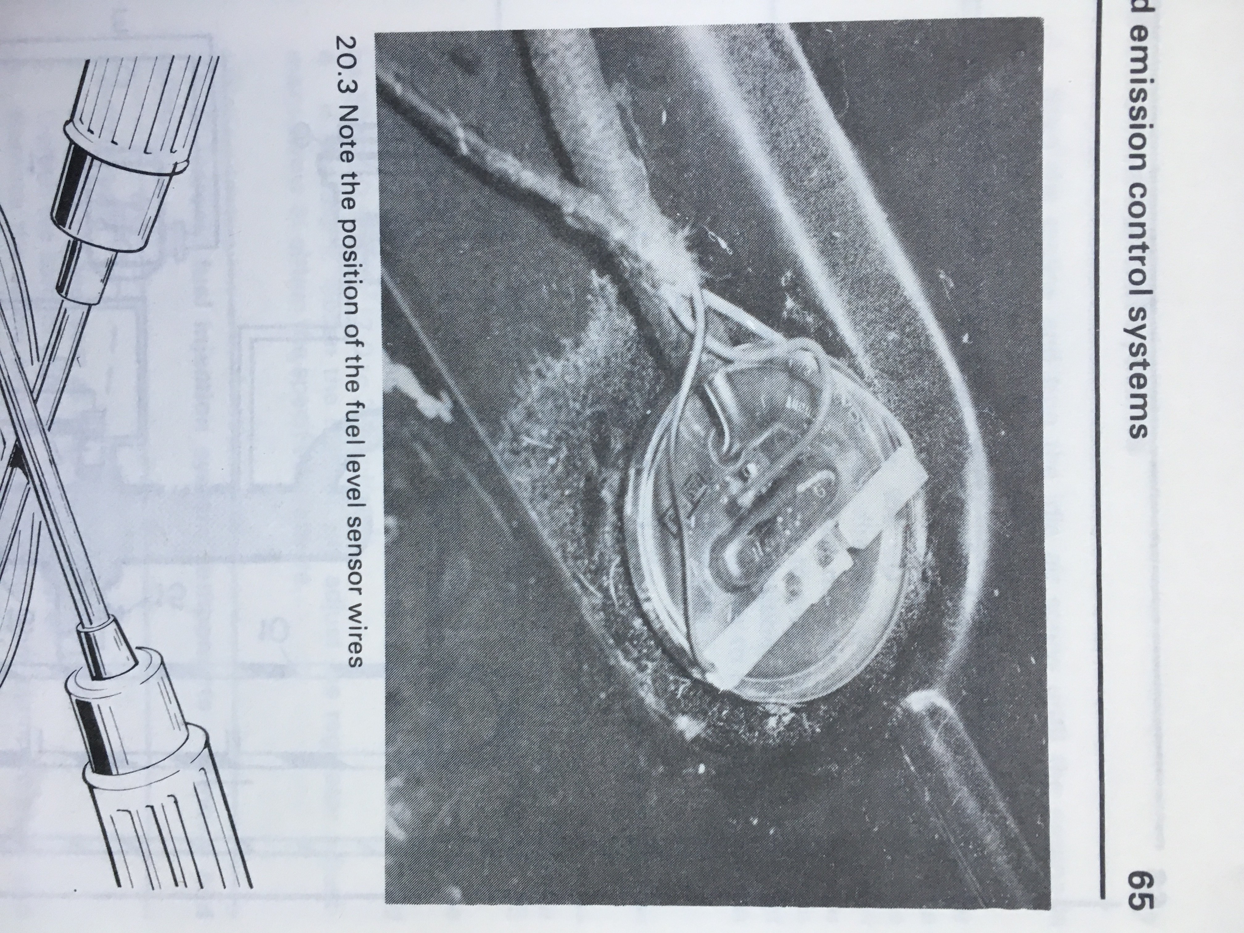

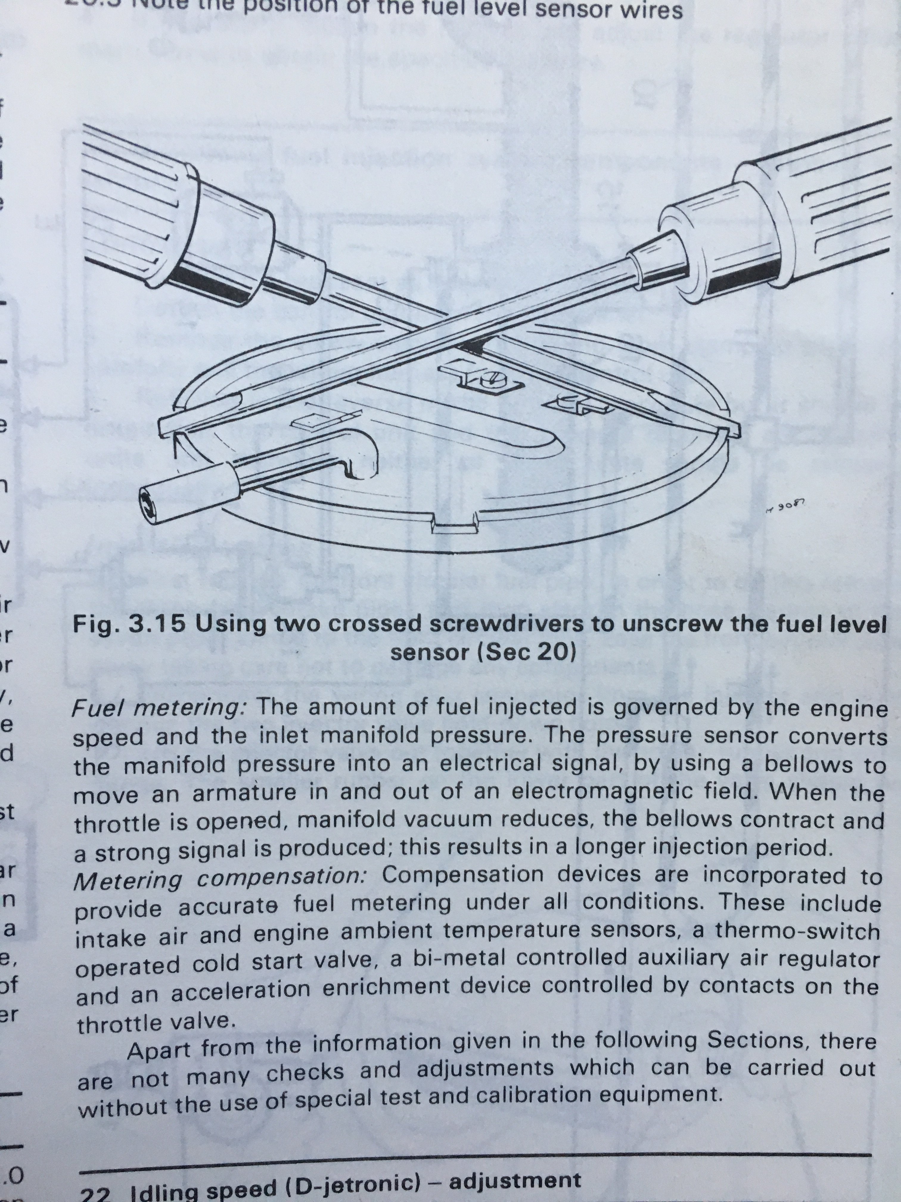

You have to remove the sender unit from the top of the gas tank (under the right side trunk floor panel). I cleaned the mesh screen with spray carb cleaner.
