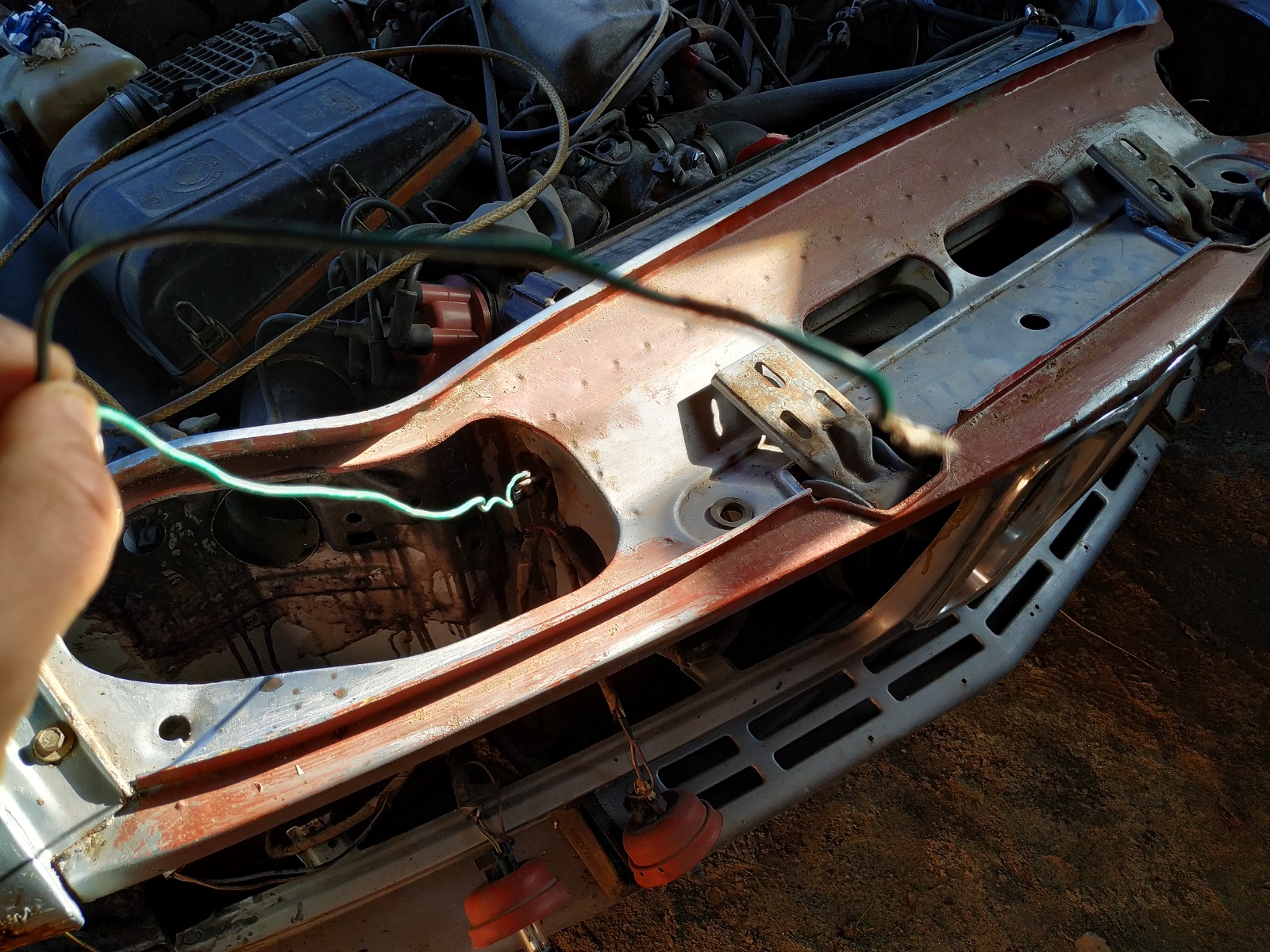

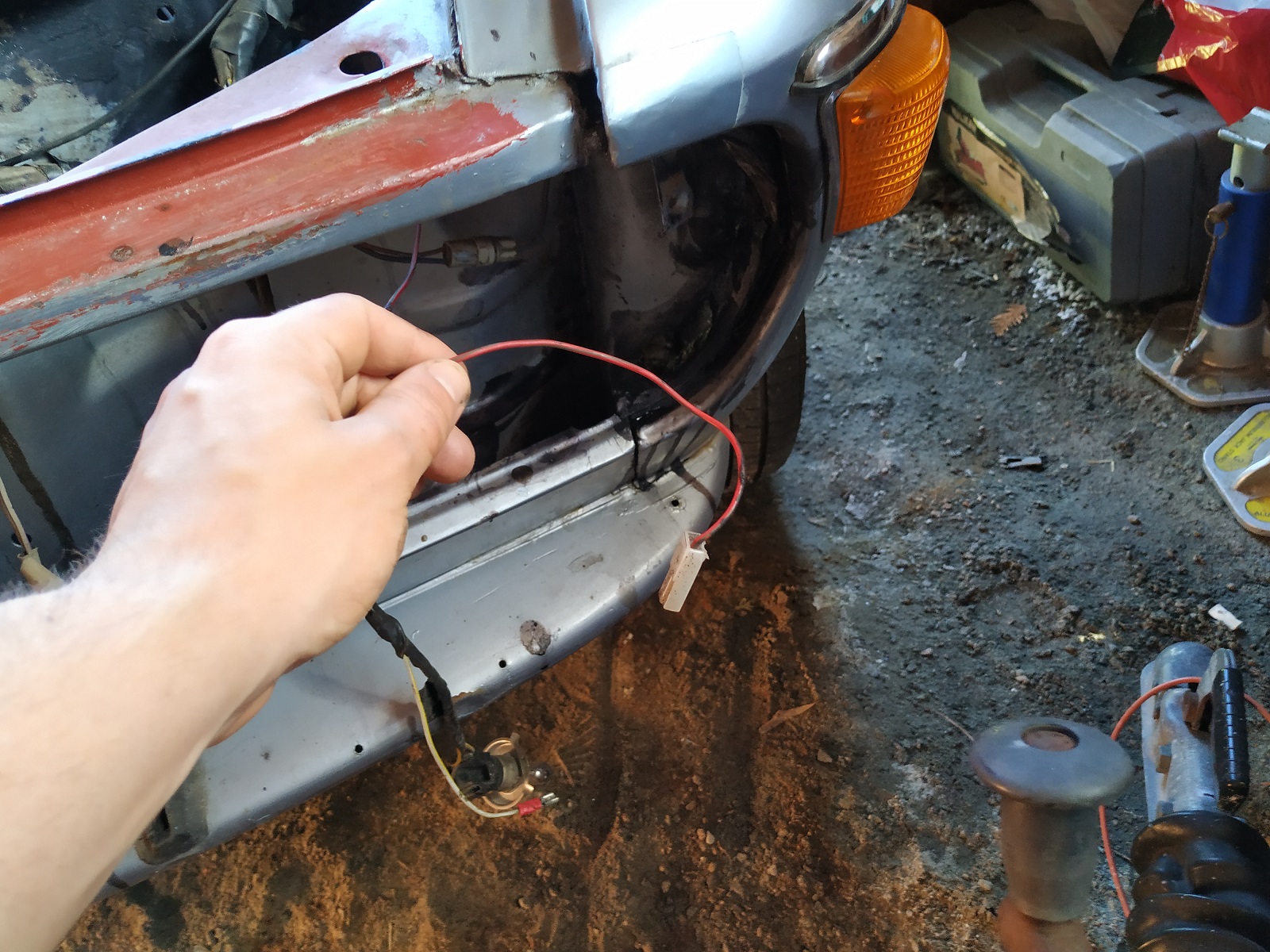

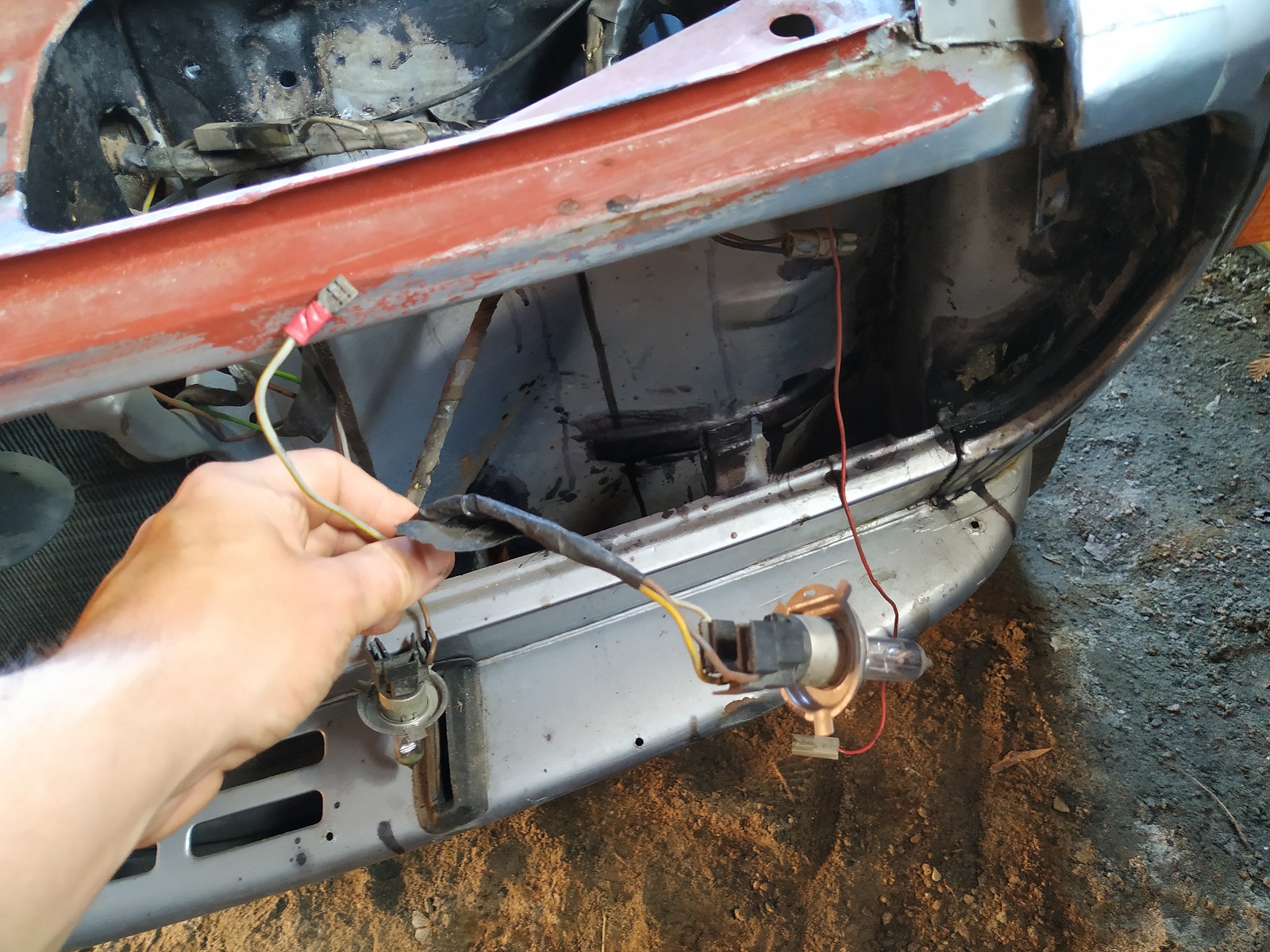

As I said previously I am trying to get my old BMW e3 in working order. The car has stood dormant and partly dismantled for years, which has posed a problem given that I don't really have that much knowledge about it. One of the issues I have is with the electronics. More specifically in the engine bay (also some in the interior, but I will focus on that later) where there are a bunch of wires and cables that hang loose and which I don't really know where they are supposed to go. I was therefore wondering whether someone here could help me figure it out?
The lighting is kind of poor here and my phone is struggling to focus on the thin wires, but hopefully it is possible to make out what we are looking at here.
I have circled where the loose wires are:

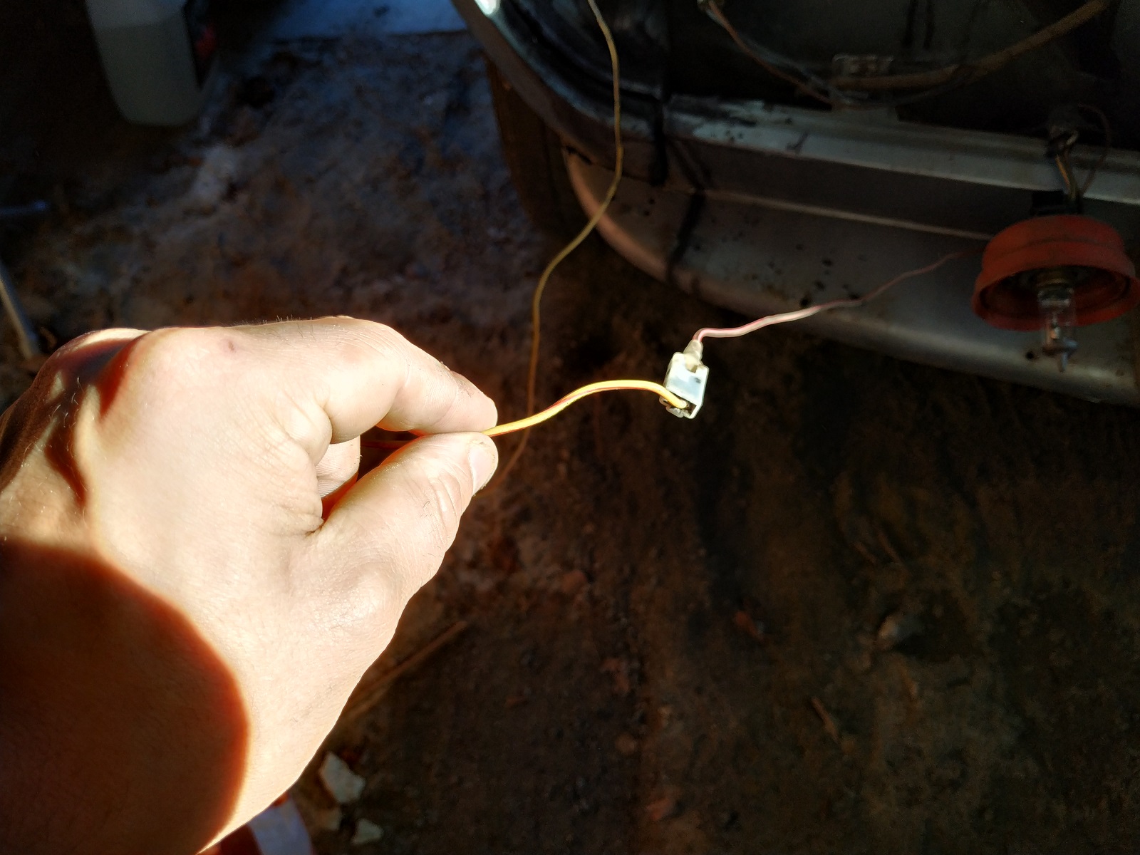

The wires in the red circle. I thought that this was maybe the ground for the headlight assembly, but I can't for the life of me manage to attach it to the loose wire that comes from the headlight bulb (as far as I can tell it don't fit at all). I also can't see anywhere else where it could go. So what gives? If they are supposed to attached together, how do you do it? :oops:o_O
The wire in the green circle. I think this is perhaps for the washer fluid system that are attached to the hood, but I just wanted to be sure.
The wires in the blue circle. The situation here is basically the same as the first set of wires - to me it looks like the ground and it looks like it is supposed to be attached to the headlight assembly, but it don't seem to fit. I also can't see any other places where it could be attached.

Someone hopefully will have a wiring diagram to share. Buy a multimeter. Brown is always ground.
Green looks like it goes to the coil as it is switched power. Yellow is low beam, white is always hi beam, ground is always brown.

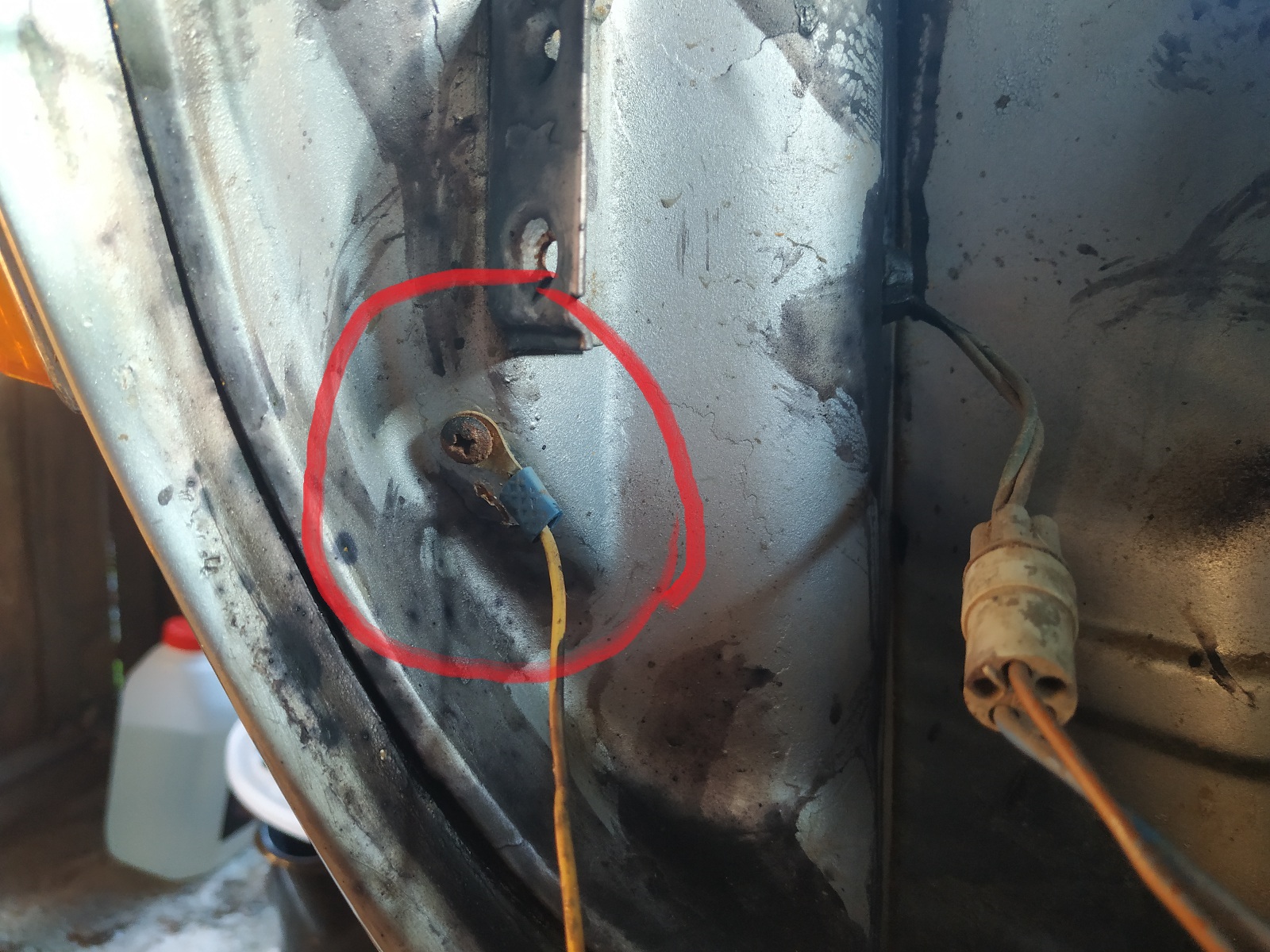

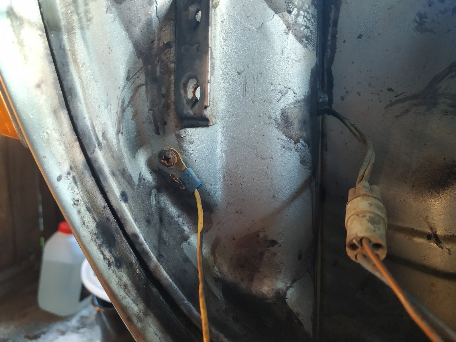

Here is a also close up of the wiring I am looking at on the left side (red circle above). It's yellow/black wire on the left that I need to attach to something in the other end. Surely this have to be the ground, as it only appears to be attached to the body here? And I guess based on the "colour chart" above, it is supposed to connect with the low beam?
I also assume the set with wires on the right are for the turn signal (but they are attached)?

That plug is part of the emissions system that was attached to the coil, it’s no longer needed
Are you here referring to the wire on the left? I think you are maybe thinking of the one to the right? As surely the one on the left is not part of the emission system?
That is not a factory wire or spade terminal, the round plug hooked up to the silver box known as a speed relay below your coil which controlled the dashpots or magnetic switches on your firewall. These affected vacuum advance and retard.
But you are talking about that plug thing to the right, right? Or have I misunderstood you now? You don't happen to have any pictures of another E3 and how it looks like there for reference?
In your last pic the yellow grounded wire I assumed went the the round plug. If it doesn’t someone has swapped out a wire as yellow is Never a ground wire. Did my other wire color suggestions make any sense?
The yellow wire is not connected to the round plug. I don't think it is connected to anything at all beside the body of the car. It's possible that it is not original - as said the car have had an engine swap and I assume at least some part of the electronic had to be changed with the engine.
