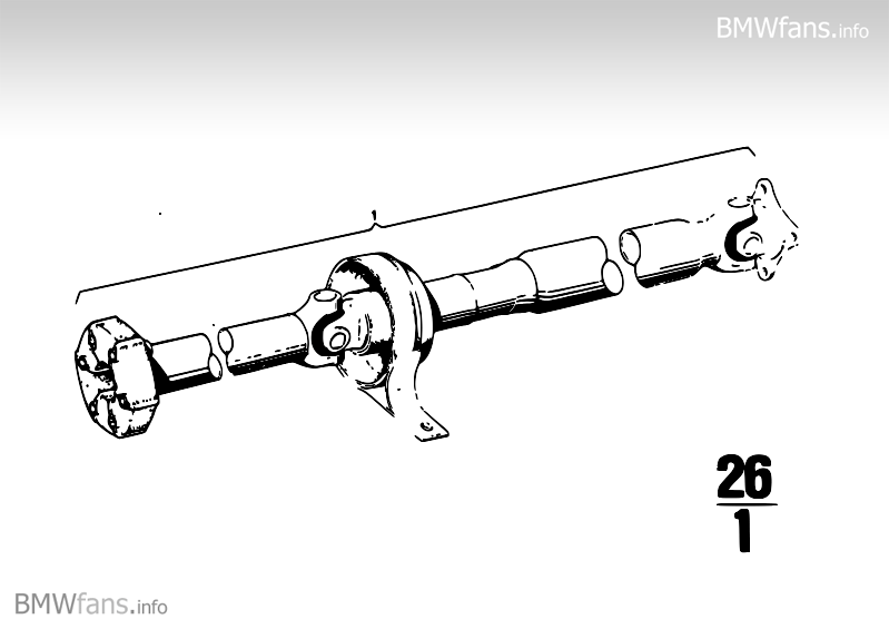

The fact that your former mechanic's efforts worked for a while suggests you are/were on the right path. Unfortunately, it sounds like the welding of the drive shaft was poor from the beginning, and that possibly too much heat was used to weld the drive shaft, making some of the metal too brittle and unable to handle normal drive shaft stresses.
As a reference point, look at the first illustration. Notice there are three joints: (1) the rubber disk at the far left, (2) the metal universal joint in the middle and (3) the metal universal joint at the far right. To my mind, a hardened front coupler usually refers to (1) the replaceable rubber disk (Giubo) that connects the drive shaft to the transmission. If it gets too hard from age, heat or wear, it can develop cracks or worse - causing noticeable vibration. It is something you might be able to observe, as distinguished from the metal yoke that retains a universal joint. "Putting joints in oil," suggests metal was re-welded or heat treated and then being quenched to prevent it from becoming too brittle and susceptible to fracture and distortion. A spinning part that becomes distorted can become unstable and unbalanced leading to vibration.
In theory, there shouldn't be any problem with using a drive shaft part from another car, including an e46. But when working with metal that is being machined and/or welded, it has to be done properly. If you change the character of the original metal to the point where it looses the strength and rigidity necessary for the job, it may be time to ask someone like Zeus to make it work.

The fat donut style is older and probably absorbs drive line shock better than the later style pictured. However, the later style, which is reinforced, is probably far more durable.
