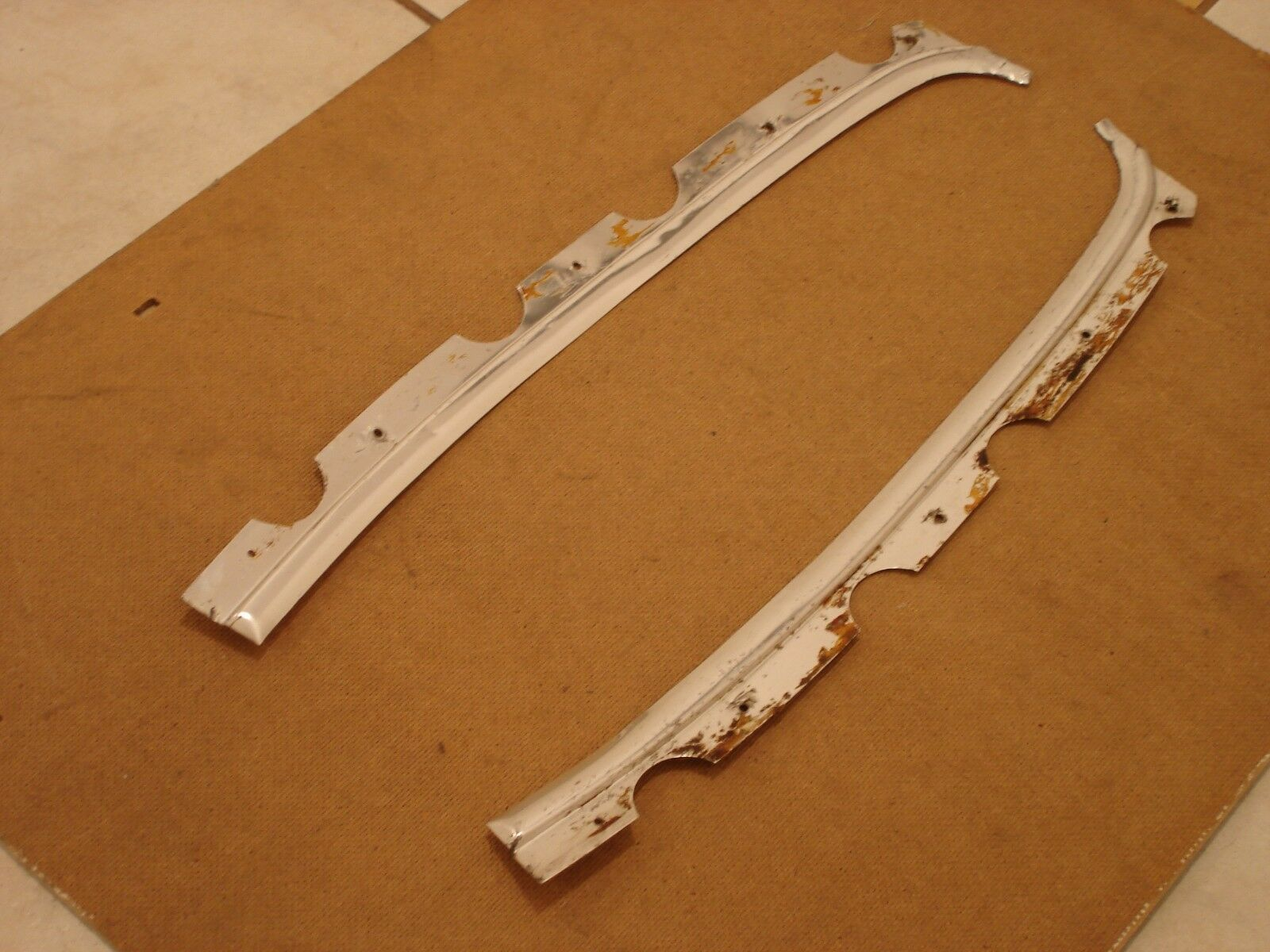

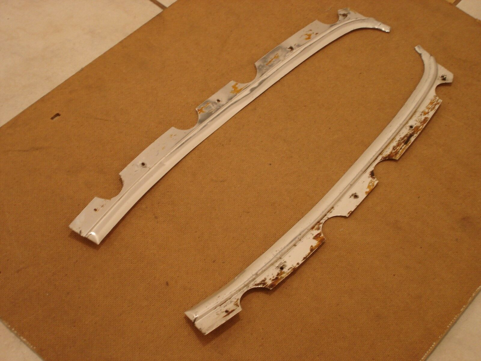

Need a part number for that pictured. Cannot seem to locate on RealOem. Tx
The orange parts book failed us. I flipped through every page while waiting for cheap pizza. It’s possible that it is in band 1 but that doesn’t make much sense... Will report back if I find it.

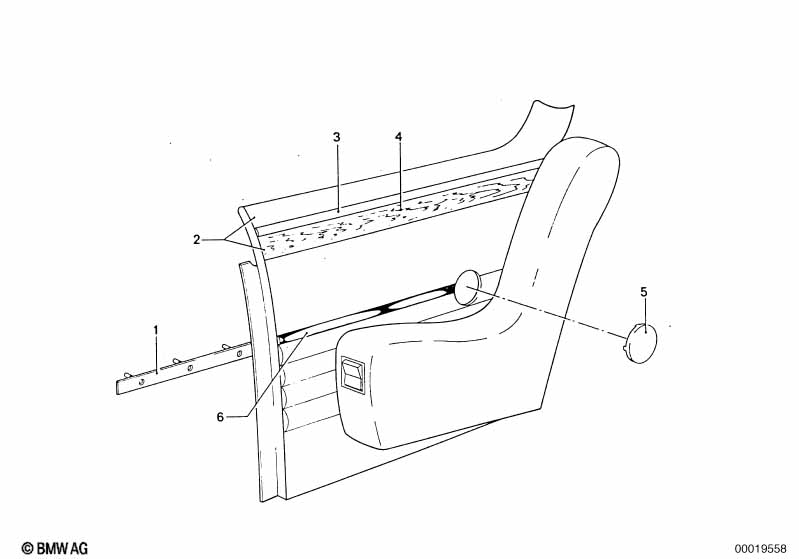

Is it # 2 here ?
Lateral trim panel rear

No.DescriptionSupp.Qty From Up To Part NumberPriceNotes
01Holder212/196810/197351411811196ENDED
02Bracket151367780097$320.29ENDED
02Bracket151367780098ENDED
03Holder112/196811/197551367740142ENDED
03Holder112/196811/197551367740143ENDED
04Wooden cover rear left112/196810/197351367780197$62.78ENDED
04Wooden cover rear right112/196810/197351367780198ENDED
05CapSCHWARZ251411869871$5.44
06Decorative strip112/196810/197351431811169ENDED
06Decorative strip112/196810/197351431811170ENDED
Notes
  • ENDED = the part has been discontinued (no longer available).

It is the aluminum trim on the leading edge of the rear “door panel”. Rivited to the body,
visible from the door jamb.
Exactly! I would like to find all 4. Spending so much on a rehab, using the ones I have make no sense and I dont think anybody, regardless of skill, can save them.

If that is them it is a terrible drawing.
So the two on the W & N site found by Ulrich (above) are the fronts, the pair Bob has the picture of (abover) are the rears...
Yes they look like the front ones, I just assumed they are cheap reproduction pieces for the rear that doesn't look like the oem ones.
I might very well be wrong.
I assumed the same. However, I think that the half circle cutouts are to clear the holes for the “door panel” clips.
