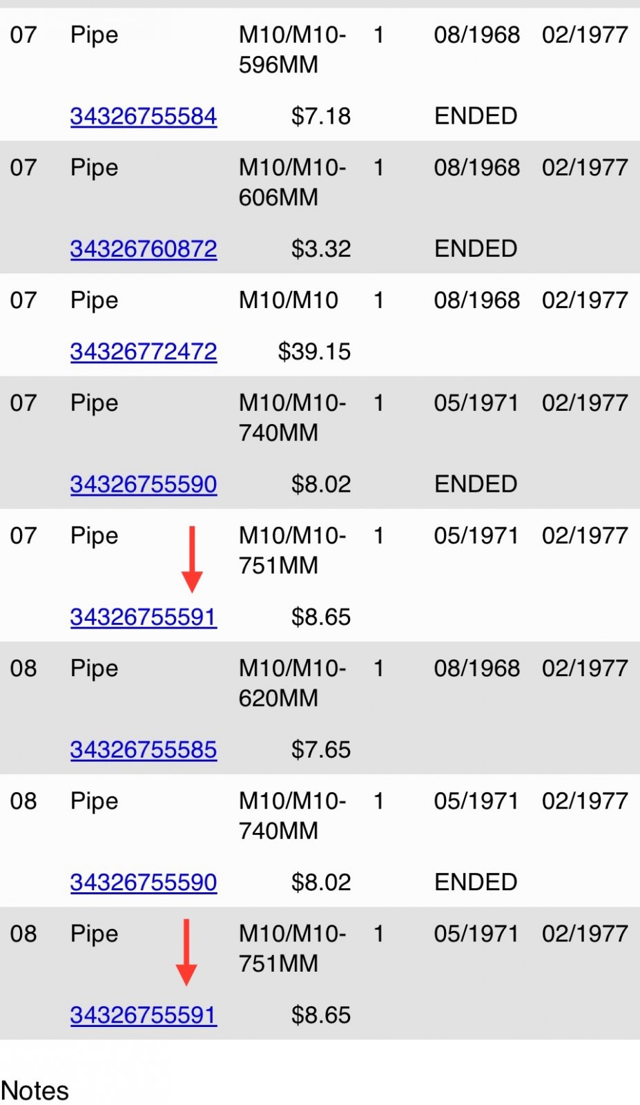

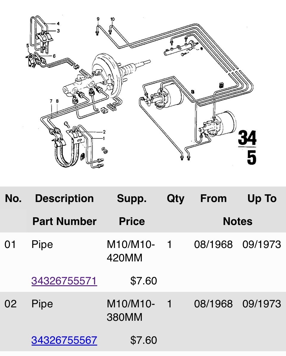

If your car is a 1972 model:
On the strut:
At the master cylinder:
Appear to be available.
Use the appropriate tubing bender.
