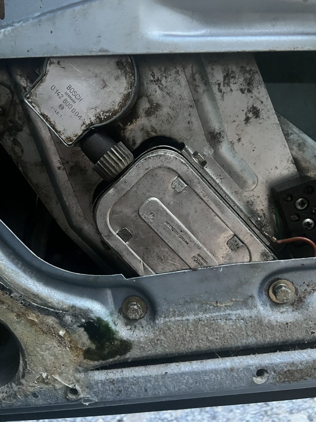

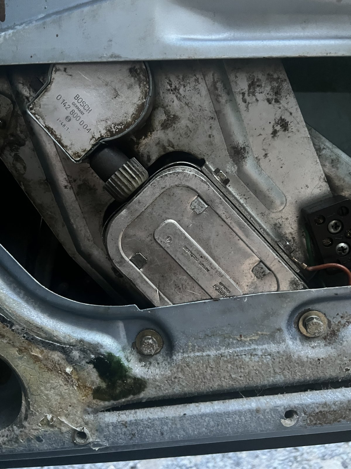

In addition to the circuit breaker thing that Chris mentioned, you can look at your existing motors. If they are the "sardine can" type, with three wires going into them and a separate gearbox, then you have the early style motors and modifications will be needed.
FYI: replacing the 'Tuna Can' style motors with the L & R rear E28 motors will require a template & extra hole drilled for the difference with the mounting screws. Will also have to modify from 3 to the E28 2 wires. If the E28 motor 'sticks' like the Tuna Cans do, it may be possible to get it un-stuck by trying to push down or pull up while trying the switch. If that fails, the motor will have to be accessed to asses the directional failure. E28 motors do not have a tool to assist the like the Tuna Can 'comb tool'.
Took door panel off. I do have the "sardine can" with three wires. The window down works. The up does not. Is it possible to have these motors rebuilt? Or only solution is the E28 rear swap?
mine was the same thing I renew wires and it works when it go down motor just fine just connection is bad I fix my E9with renew the wire and clean connection
