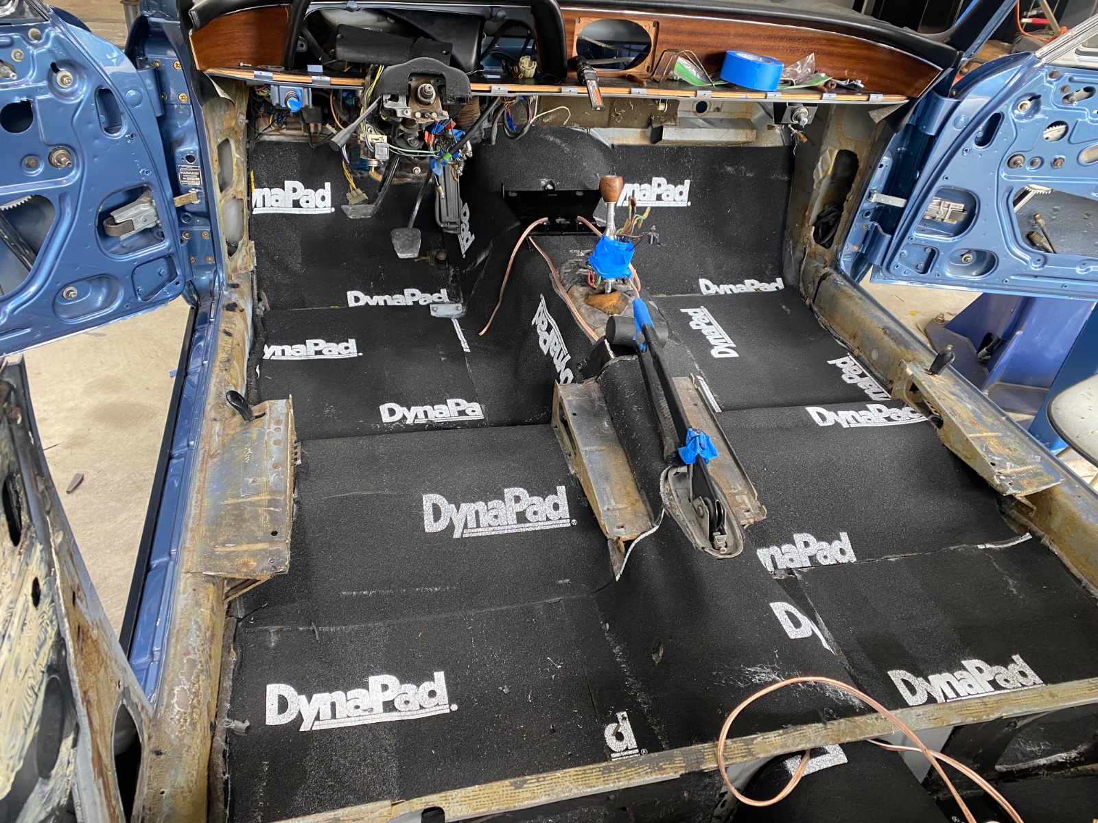

basic option 2 - put dynamat or dynamat Xtreme throughout the interior (floor, tranny tunnel, firewall, under / behind rear seats + doors). then cover with dynaliner
there is a 3rd option - to just put 1/2" dynacore everywhere as its sound and thermal - it also has an adhesive back. dynacore comes in sheets that are 1/2" and 1" thick

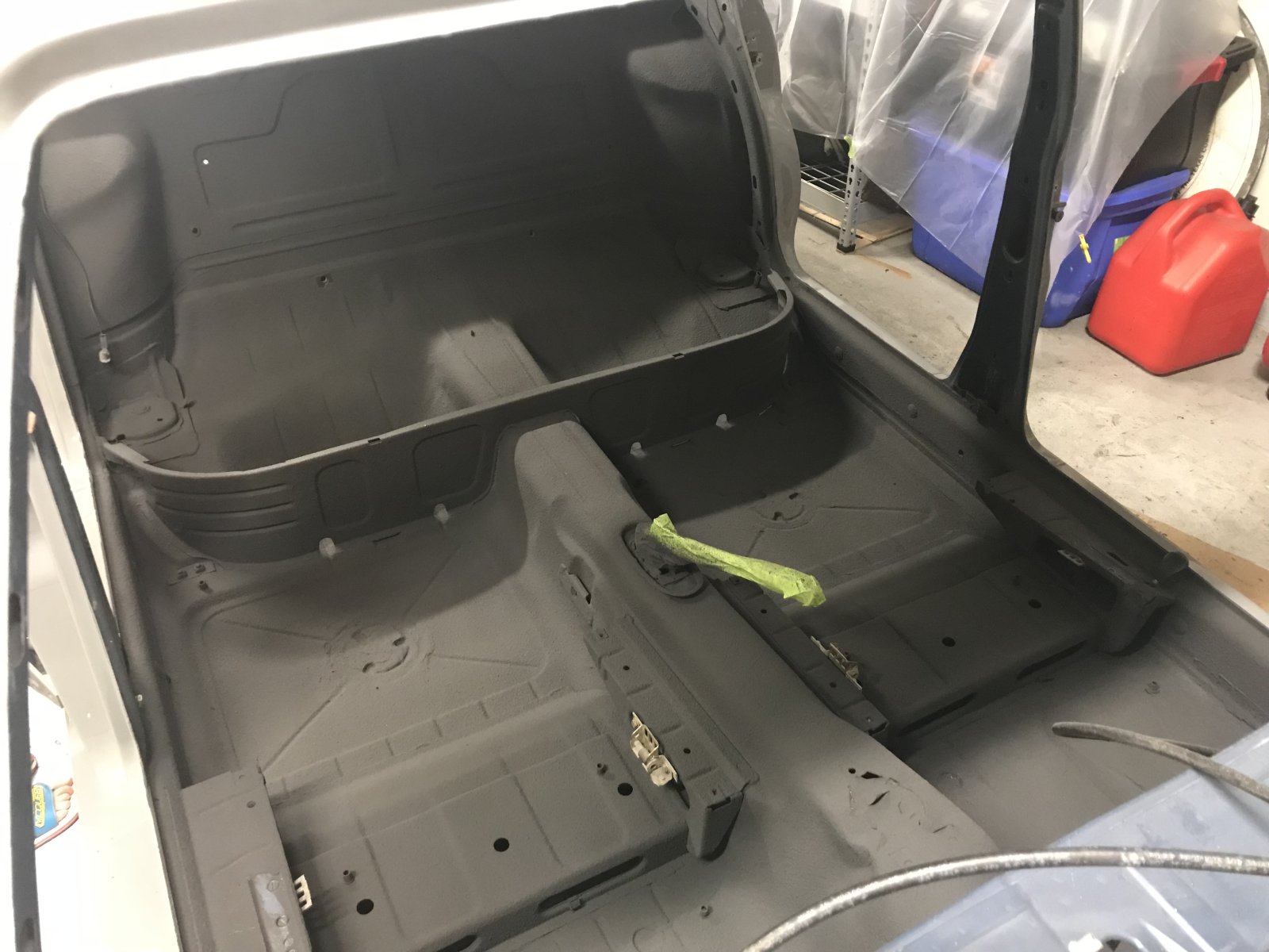

so what am i doing - since my car had just come out of paint, i didn't want to spray anything near the car, so i took the dynamat approach. then i learned that some of the liquid treatments could be brushed on (oh well, missed that one). i am then going to line the tranny tunnel with 1/4" dynaliner and then do the firewall with 1/2" dynaliner. i will probably do everything under the rear seat with dynaliner ... but we shall see. if i was removing / replacing the headliner, i would put 1/2" dynaliner there too. my car already has some thermal insulation on the inside of the door skin and if i make time, i might replace that as well. my recommendation, if you use dynamat, is to buy the 18" x 18" squares - its easier to deal with slightly smaller pieces than stuff that is 50" long.

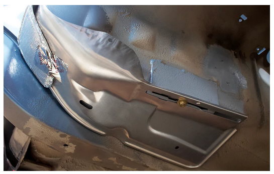

there are also a couple of other things that help with heat
1. replace the thermal insulation on the firewall (engine side)
2. add the metal heat shield on the passenger floor (covers a portion of the firewall and part of the tranny tunnel)
3. have your exhaust header / downpipes ceramic coated
here is Coupeking's firewall insulation and the BMW heat shield
and this is the heatshield in place

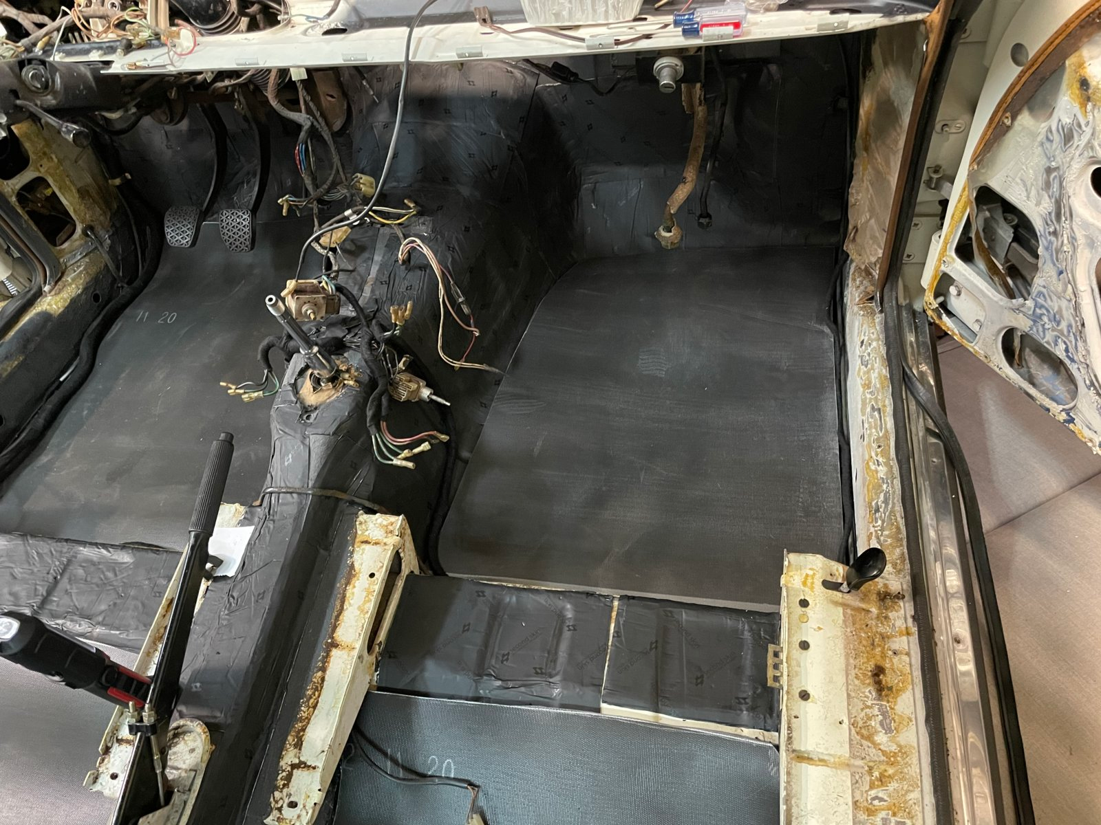

When I did my interior project I added a paint-on thermal barrier inside the cabin, then sound deadening adhesive mat on the floors and inside the door cavities, then a very heavy lay-in mat on top of which went the carpet. The products I used were from second skin audio.
  • Spectrum spray in deadener
  • damplifier pro adhesive mat
  • luxury liner pro sound barrier
  • underneath the door cards and in a few other places I used their "overkill closed cell foam"
In the picture below you can see the sound barrier on top of the adhesive mat.

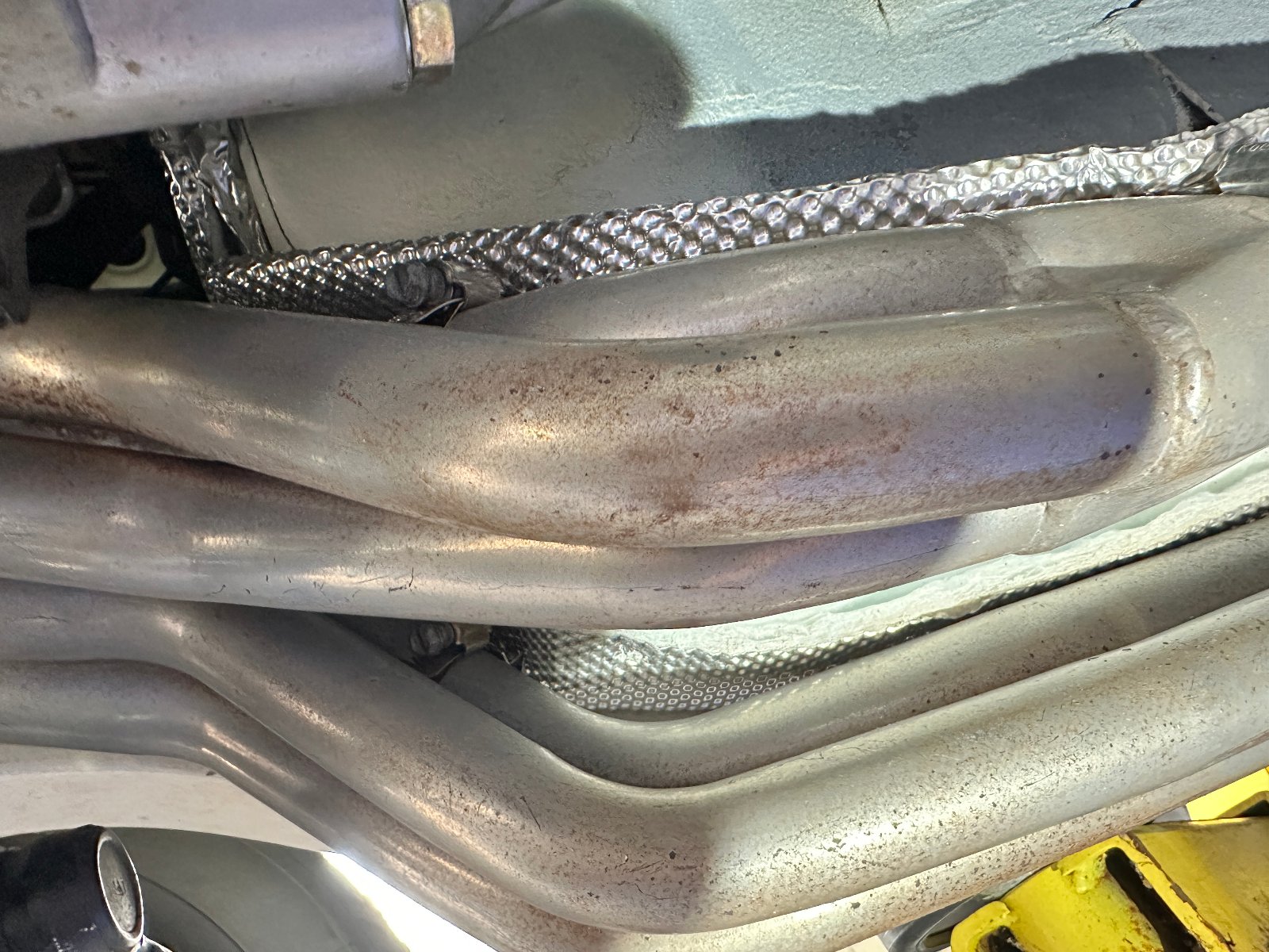

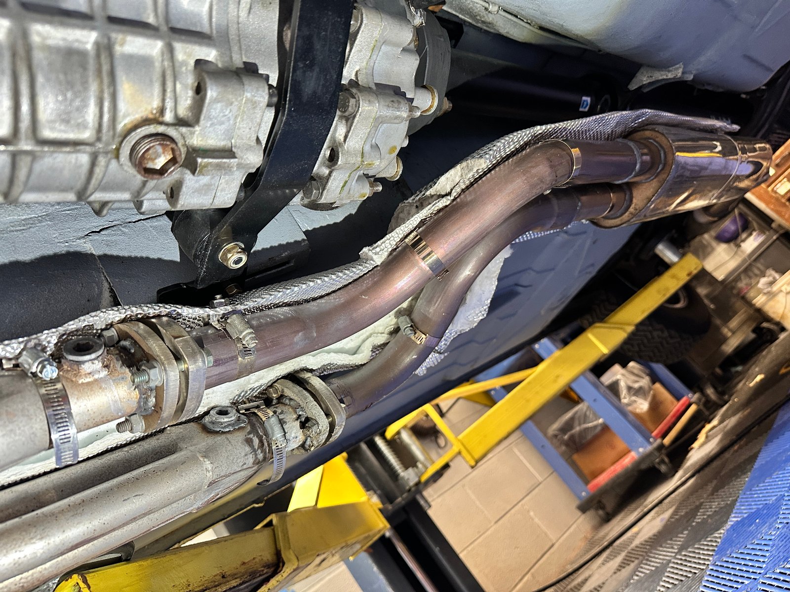

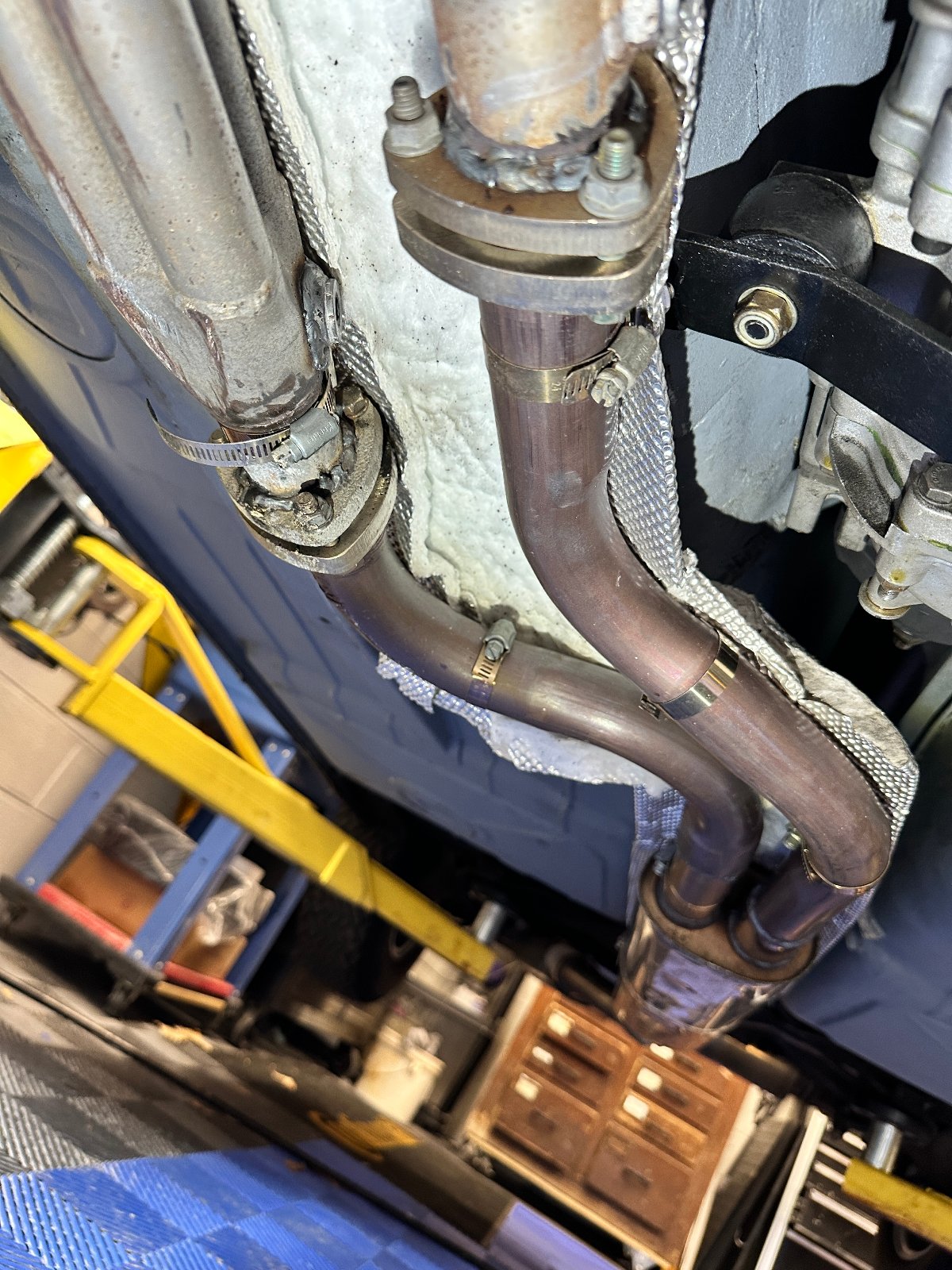

After all was done I still had a lot of heat infiltration from the exhaust, and later added an exhaust shielding that is attached to the headers and exhaust from the end of the headers to about the mid resonator via clamps. This made a huge difference in the excessive cabin heating, especially when combined with an electrically operated heater diverter valve.
