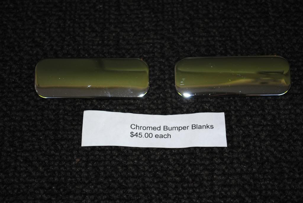

I'm leaning toward the ss bumpers as it seems the the rubber impact strips aren't as hard to come by as I thought, just expensive. Also wondering what people are doing for the license plate lights when doing this mod. Do you use the bumper ones and the '74 body mounted ones or do you get a new panel for the back of the car to delete the side lights? Cover plates for holes?
If you choose to keep the license plate lights on the panel, I have recreated the cover plates
