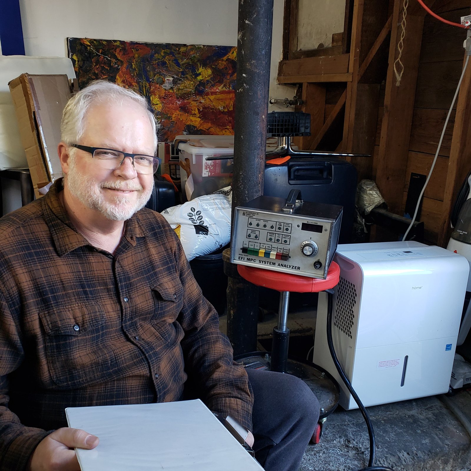

In the conversation with Jeff, the topic of testing came up and he mentioned that he had several testers for D-Jet...even the grand daddy of them all. The EFI MPC 9100 (https://members.rennlist.com/pbanders/Testers.htm#MPC Analyzer). So wait, you have a 9100 AND know how to use it? Of course, he said, I've been using it for years to diagnose poor running D-Jet systems.

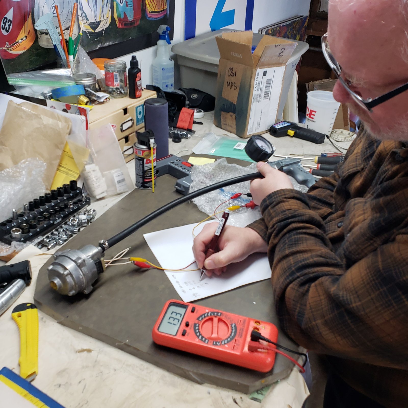

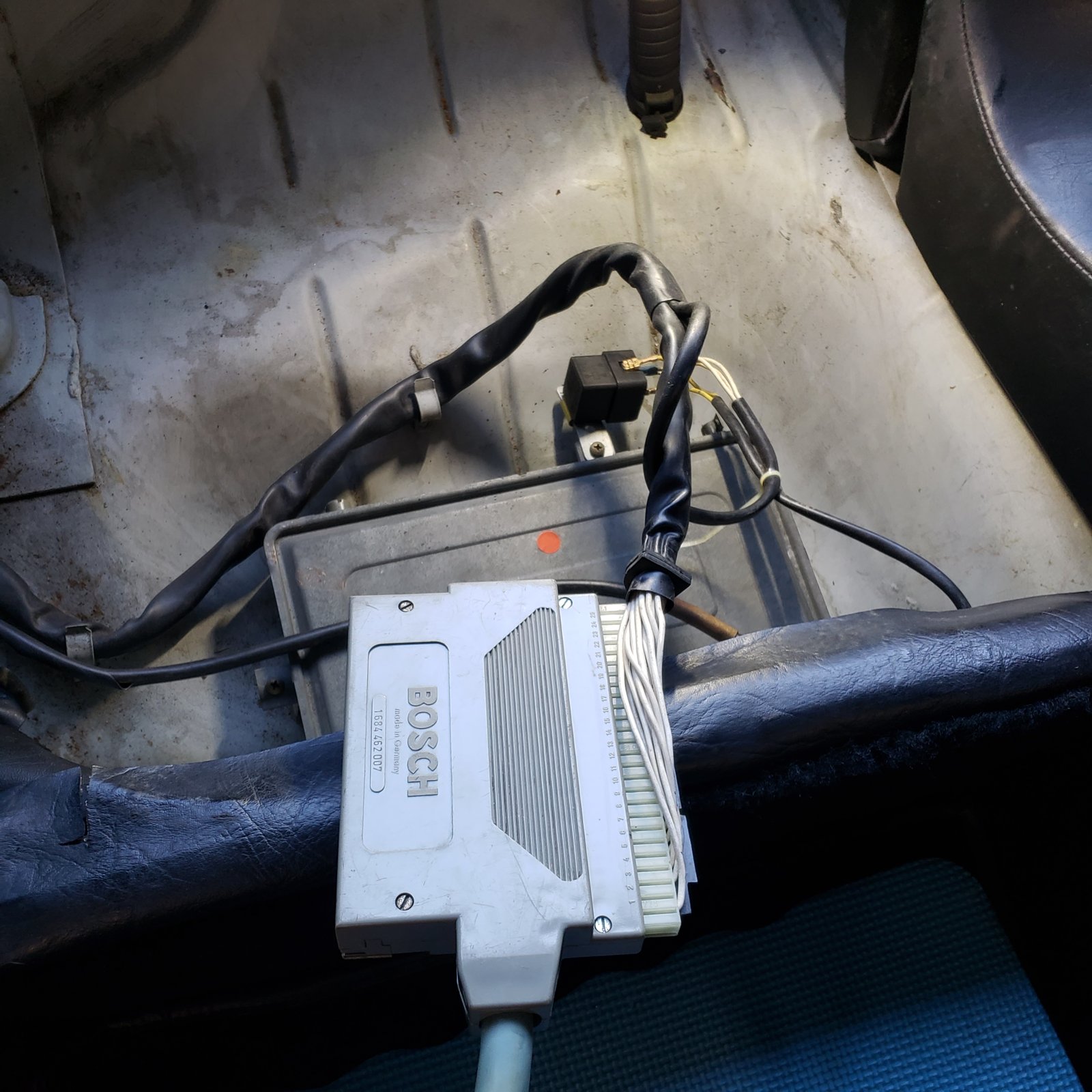

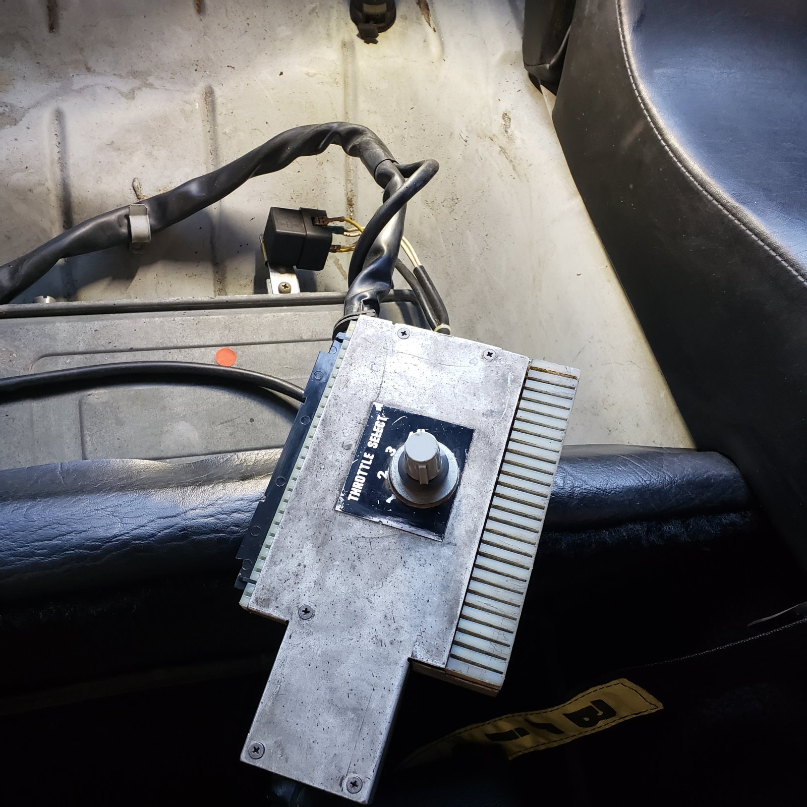

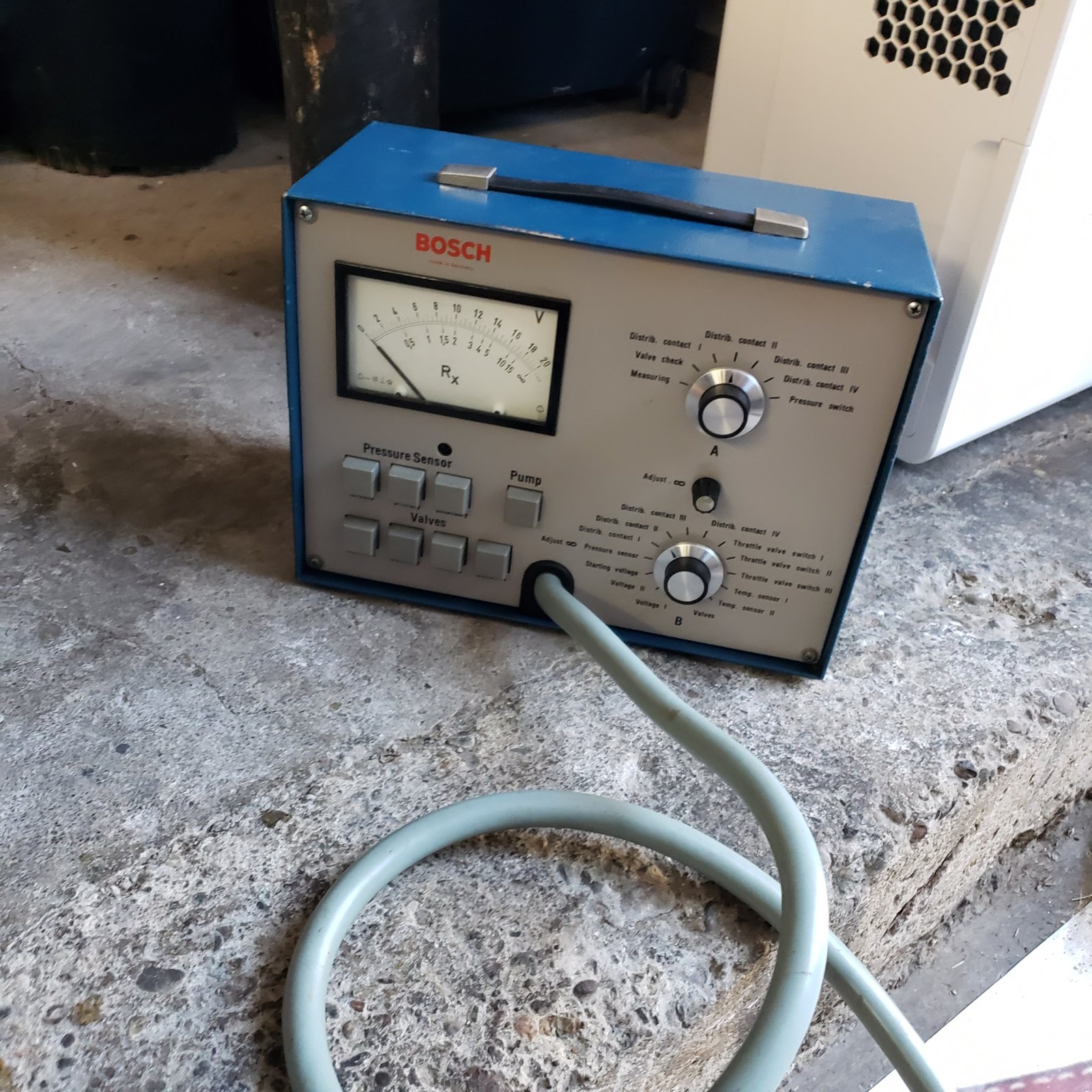

So long story short, and because my car was running poorly about 75% of the time, he agreed to come to me and bring his testers. Both the EFAW 228 that is pictured in the CSi/L manuals and the EFI 9100. Its interesting to note that the EFI interposes between the harness and the ECU and can actually run the car without the ECU if need be. It was all very interesting for me. We did about 2 hours of testing and confirmed the MPS and Trigger points were fine but when we tested the TPS, we located a problem. We ran out of time to run the full diagnostics on the injectors and other sensors in the system but we will be revisiting once I repair/replace the TPS issue.
Needless to say, I was really happy that we could diagnose the entire system without having to guess what might be the issue. Jeff's range of services include, testing individual components, entire D-Jet systems, rebuilding MPS's , TPS's and he is a master at rebuilding the complete D-Jet Harness's. Both 2 piece and the later 1 piece.
Here is Jeff's website which you can use to reach out directly to him. He's a super nice and more importantly knowledgeable guy with a real passion for evaluating and problem solving. Below are a couple pics taken during our session. If you have an issue with your CSi/Si?CSL (who doesn't) definitely reach out to Jeff.

My first thought when seeing the pics is: “Oh thank god Jeff looks younger than I assumed”. No joke, I have anxiety of certain experts retiring before I get to my project.
Given that smile on his face I hope that Jeff is at this another 15-20 years. ;)
