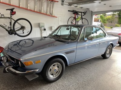

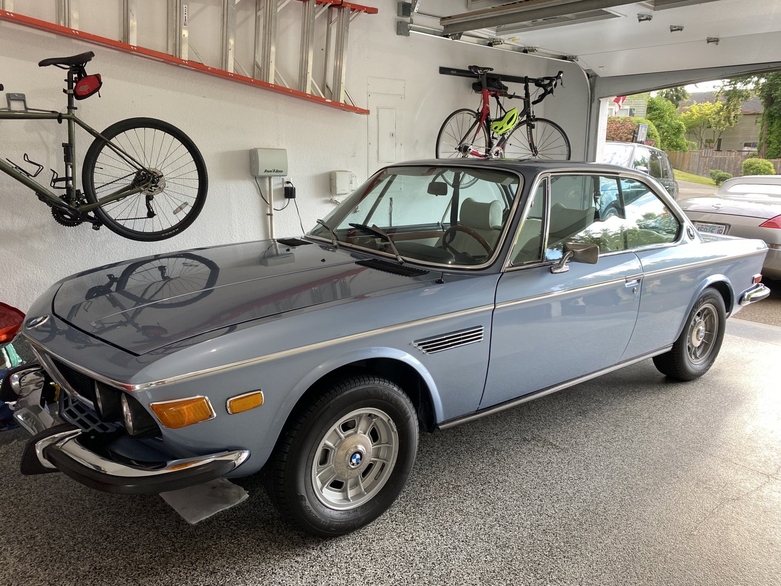

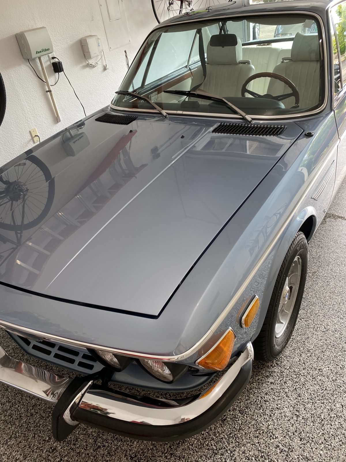

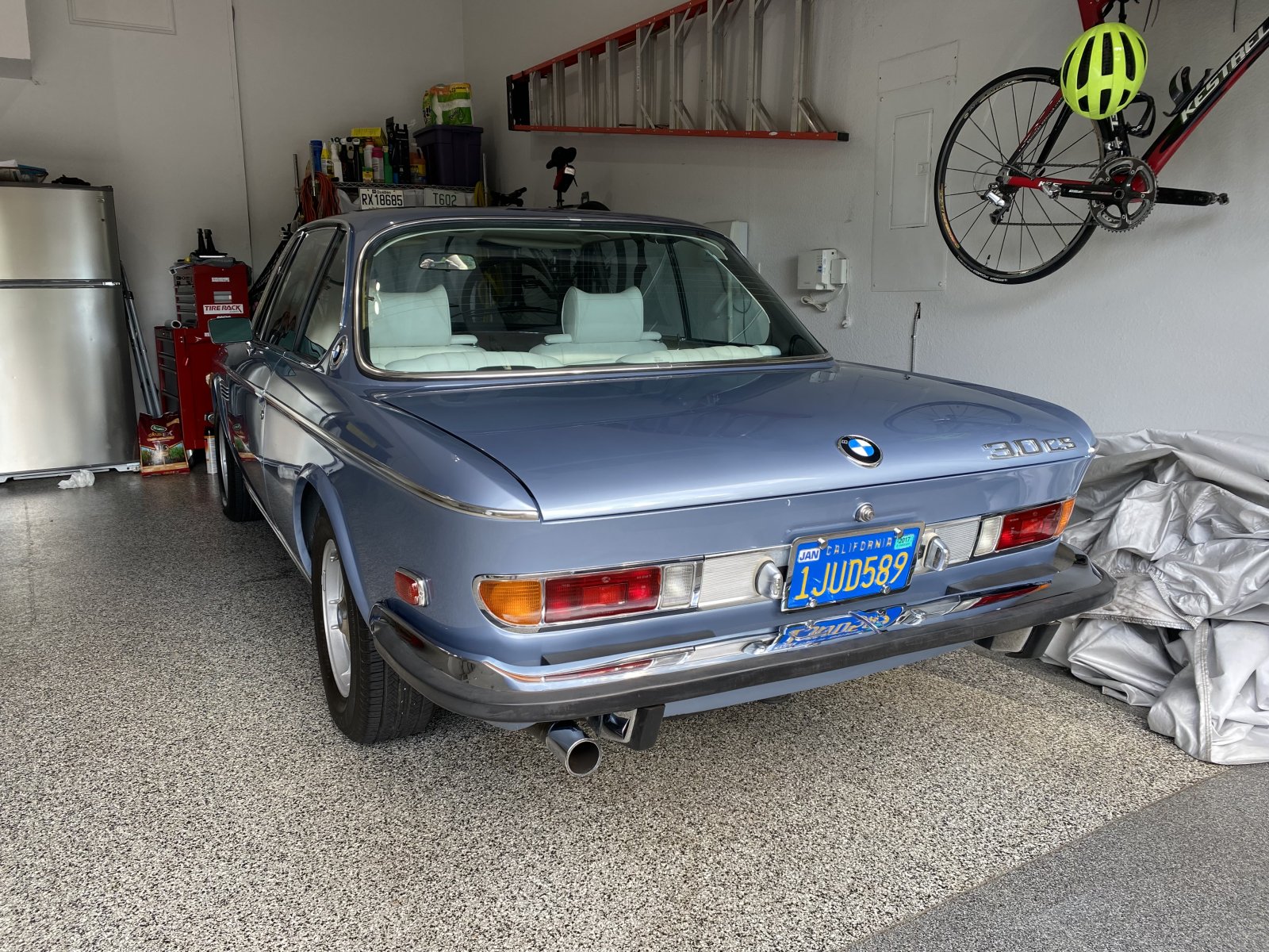

Yeah, I was not clear. It’s in my garage. Thanks for the feedback! I would find 15” or 16” to be the sweet spot between handling, steering response, and ride. I’ve driven a Coupe with 17” and was a bit stiffer than I would prefer.
Beautiful car, white leather works great.
I would do the 5-speed, Alpina rims, Bilsteins, steering bits if needed, and that is it.
paint work looks great
which colour is it ? fjord you mentioned ?
i vote for 14" alpinas with 205/70 R14 tyre
bring suspension a smidge down
and enjoy a perfect ride on those carbs, if you cant fiddle the webers,...we will not comment using factory zeniths
Thank you for the feedback! I spoke with a previous owner who did the restoration. Two stage Glazurit finish, very high quality respray about 10.5 years ago. I have the receipts; many dollars changed hands. It needs some minor paint correction but a clay bar/cut/polish will make it right. I’m so happy to own a fjord car.
I will do everything I reasonably can to get this original motor to sing. Staying confident about the Webers.

glasurit is supposed to be the original paint, yes
an excellent paint work will take many hours prep, paint and polish, not to mention most important disassemble and reassemble, plus wait some weeks before reassemble to get paint dry and stable
10 years ago I assume still solvent base paint which gives correct colour using the old formula
your opinion on the ride should be informed about suspension in advance, non declared sway bars, bushings, springs and shocks are relevant as well as rim /tyre sizes
IMHO, THE CAR LOOKS FANTASTIC when we mention straight lines and good gaps and offsets
i would remove side reflectors and put bumpers in their correct place, it makes a lot of difference

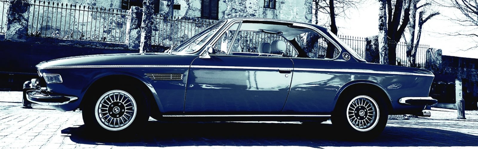

I see and value your points. That (your?) Coupe is gorgeous! What is the width of the 14” Alpina wheel? I’m guessing 7” if it supports a 205 section width tire.
Would it make sense to change the suspension first, then make a final wheel/tire decision?
I have also given thought to tidying up the bumpers and removing the reflectors. That might be further down on the list, timing wise, but considered for sure. I acknowledge that ‘73 US bumpers just aren’t as attractive as earlier/ Euro bumpers. At the very least I’m considering the ‘71-72 overriders in front that are squared off and not pointy. My search prioritized a rust-free, unmolested body/chassis to avoid huge remediation costs. Trim issues are much more manageable.
I’m fortunate to have found a Coupe with crisp style lines and excellent gaps - thanks for noticing! The only body issue found at time of repaint was a “baseball sized area” just behind the passenger door that showed evidence of a dent having been “pulled” and repaired, which was then sorted to modern bodywork standards.

thanks
14” alpinas are 7J yes and tyres are 205/70
it makes sense to start with suspension, keep tyres and check
my way was that, I started with stock rims and 195/70
changed suspension,
bilsteins B6, CN springs, front sway bar to 22,5 i recall, rear to 19
