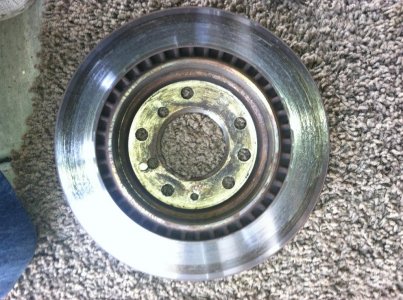

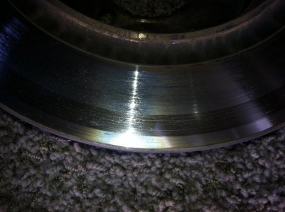

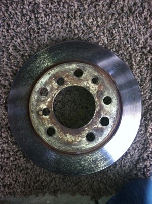

I took the wheels off all 4 corners but didn't see anything obviously wrong. Pads had meat, no suspicious marks on the disks. Checked the torque on the bolts holding the calipers to the axle and steering knuckle.
