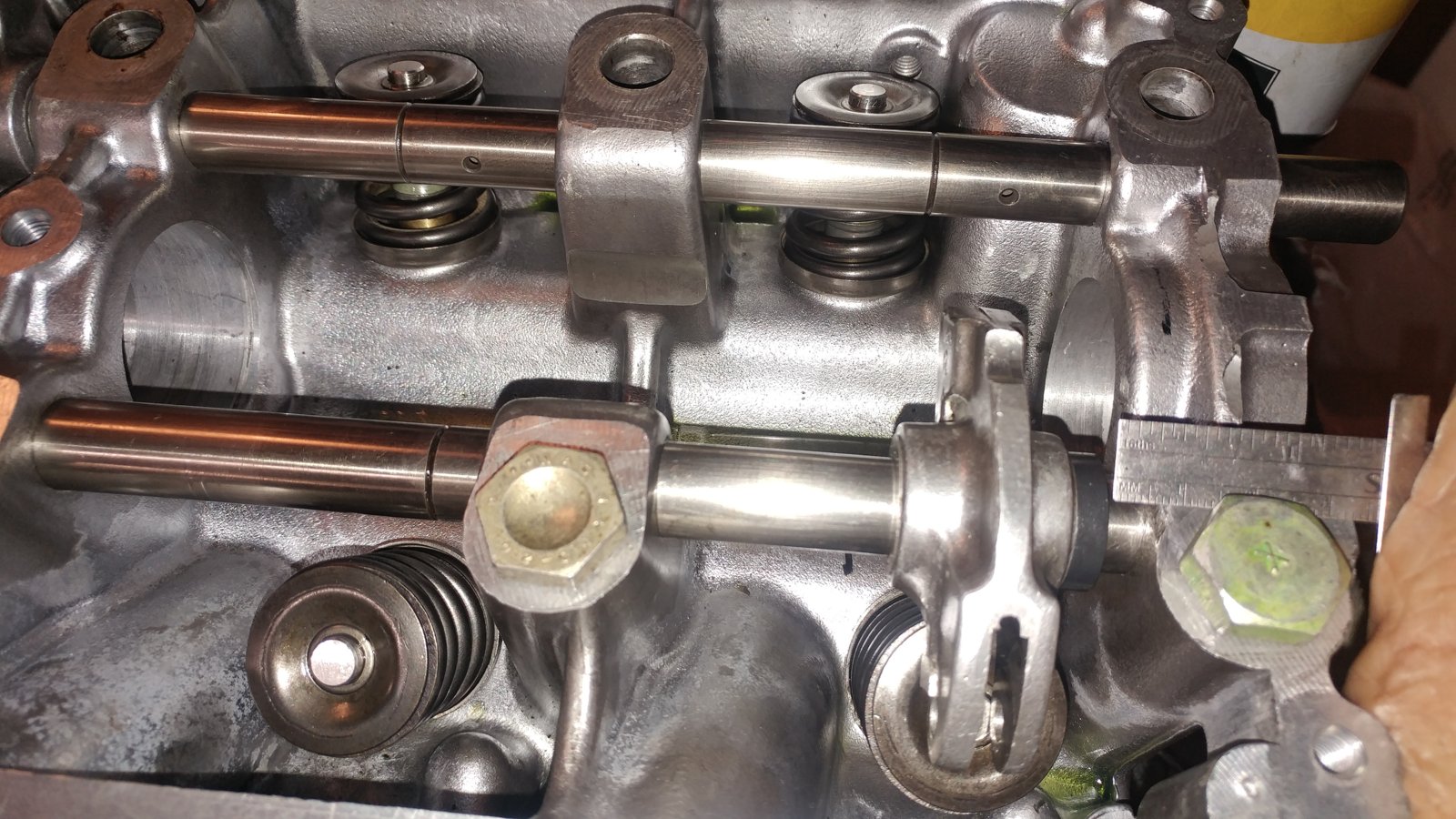

Upon installing rocker shafts and arms, we found the shafts are moving due to the spring tension on the rocker arms. This causes quite a misalignment of the rocker arm over the valve stem. See photos below. We are at a loss as to how to fix this. Not even sure new shafts would make any difference. Its the bolts. So what do we do?

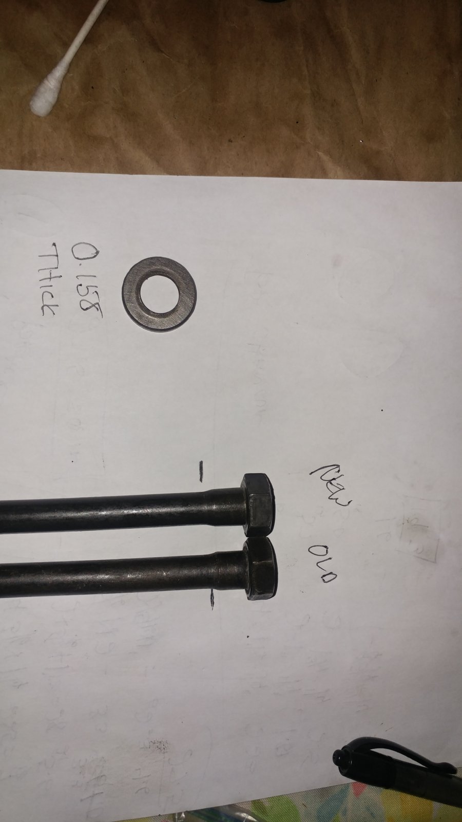

Here is a photo of a new bolt and an old removed bolt (which was even worse) showing the lenght of the larger diameter. The new bolt has a lenght of approximately 0.4" (10mm) while the older one has .360 (9mm). The washers are 0.158 thick (4mm).
The depth of the cutout locator in the head is approximately 5/16" (.312") or 8mm.
So adding the washer to the bolt and dropping in the head on the bench, the locating larger diameter of the head bolt only penetrates into the head by (10mm - 4mm washer thickness) or 6mm, barely engaging the rocker shaft cutouts, if at all. It looks like only the the taper from the larger diameter (~.485") down to the bolt diameter of .418" is engaging the shaft cutout. The threaded end is about .460"

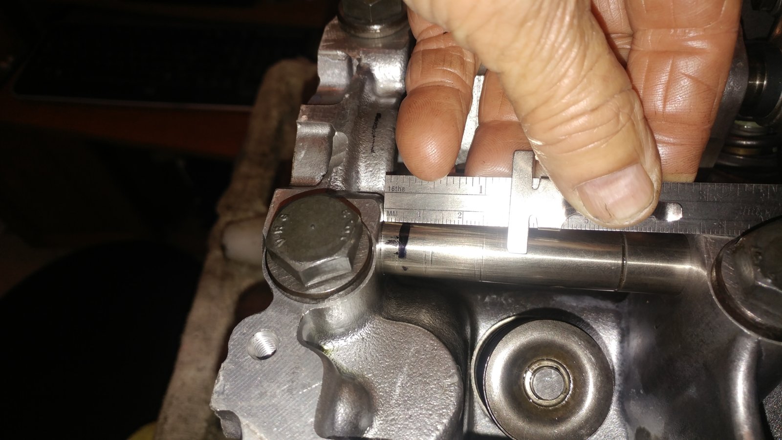

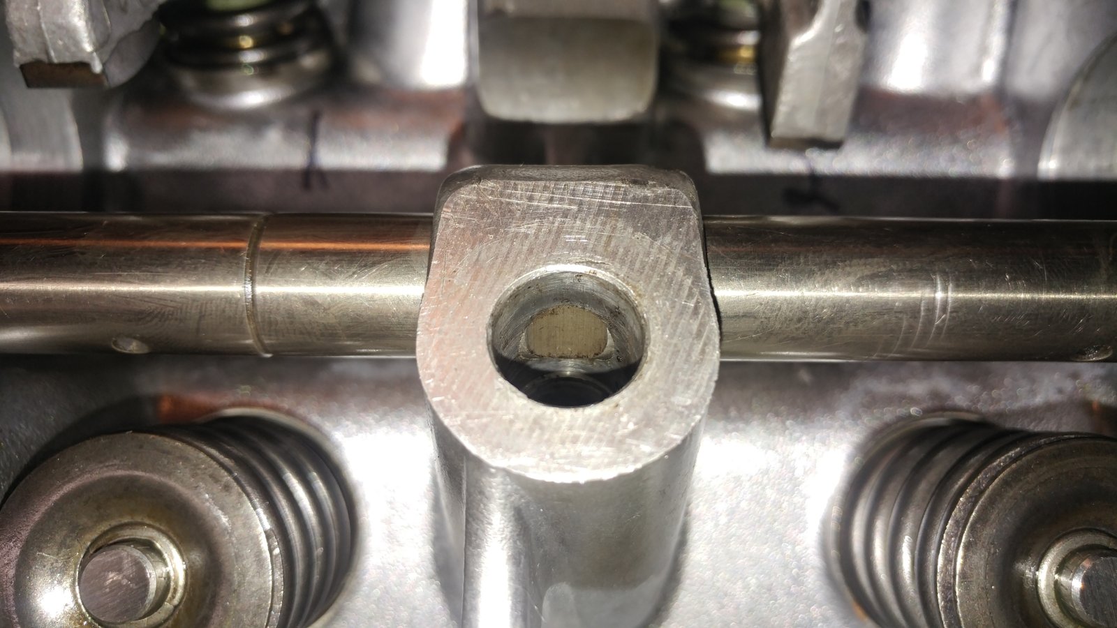

We measured the amount of left to right movement by putting 4 bolts and washers on the front intake shaft and found it to be 3/16" (5mm). The photo shows a mark with the shaft at the left stop of the movement and then at the right stop of the movement, showing the total lateral movement.

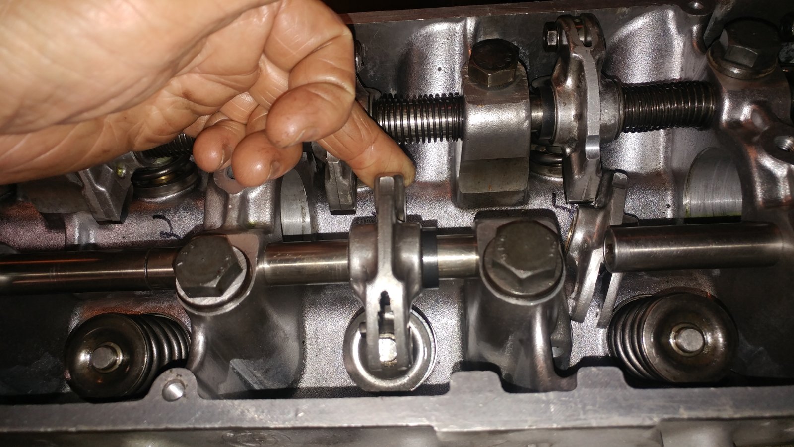

Here is a shot of the a rocker arm installed missing the eccentric for clarity, showing how far off the rocker arms will be, once the springs are installed, which we had done and that's how we found the issue. It actually worse than the photo shows. We did center the the shaft by inserting a rod solid rod of similar diameter of the the head bolt to center the shaft (as shown in the above photo) and by doing so, the rocker arms line up right over the top of the valve stem.

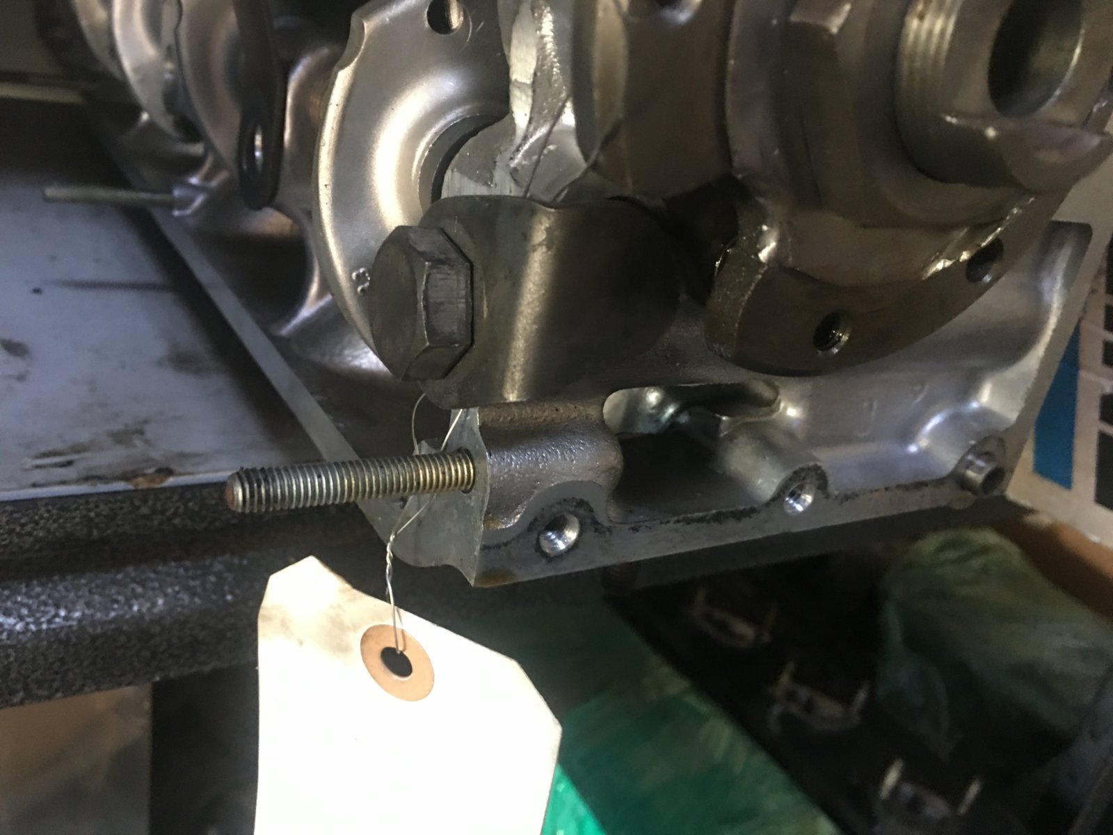

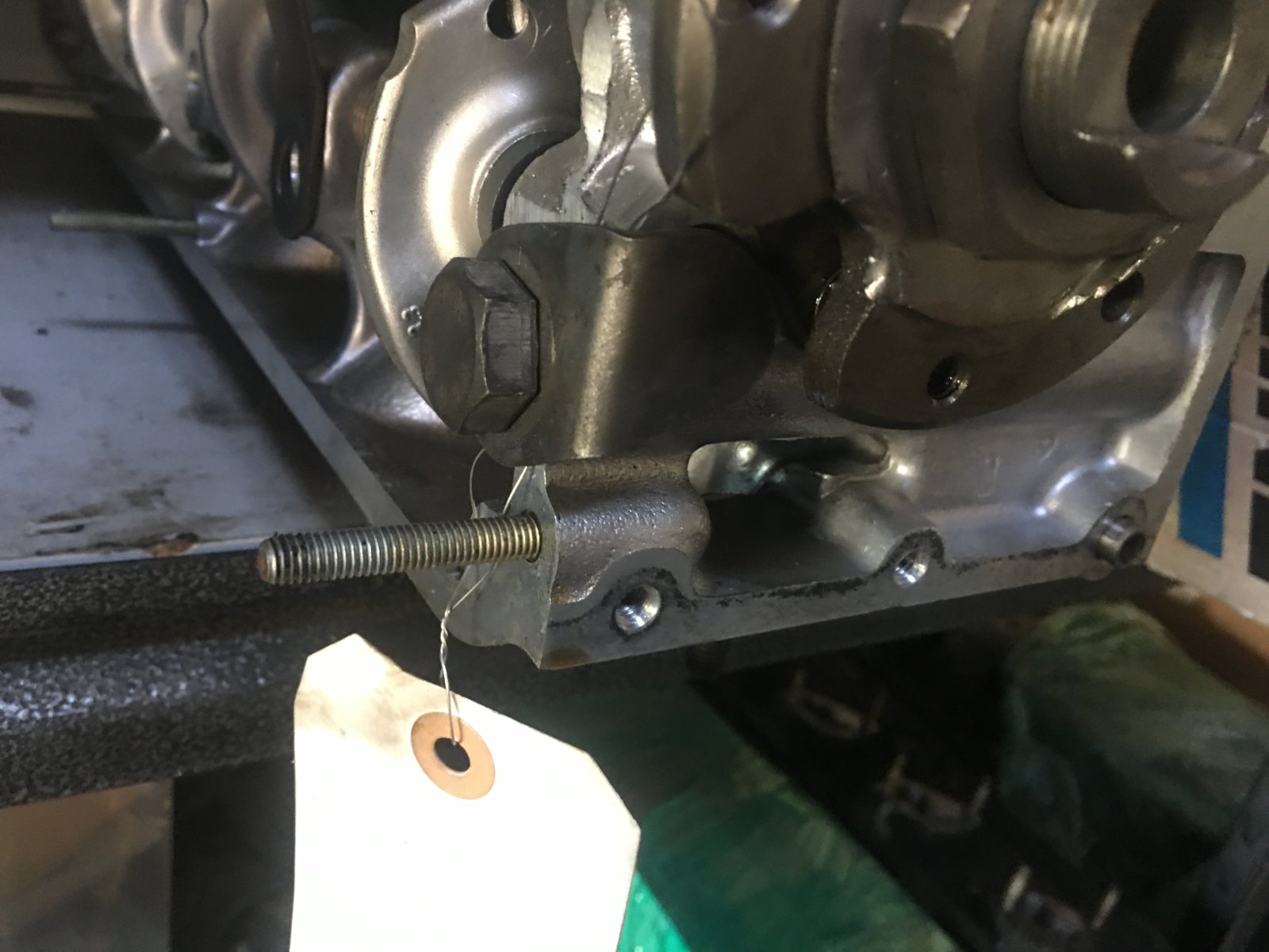

On the exhaust side the problem is the springs now are pushing the shafts forward. And there is nothing to block it like the intake side which gets pushed towards the back. Here is out situation. The shaft is sticking out of the head. All the exhaust rockers are misaligned over the stems.

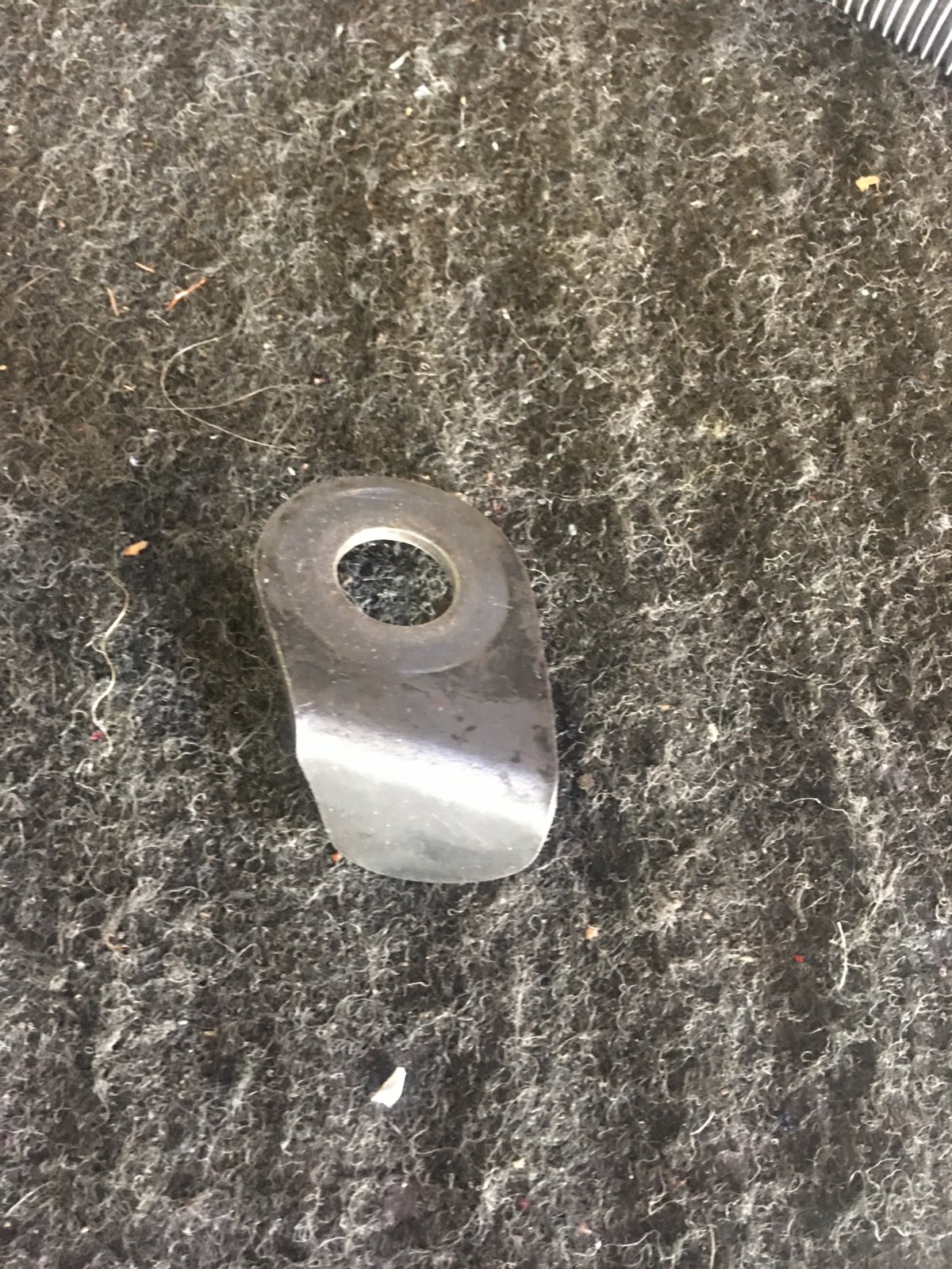

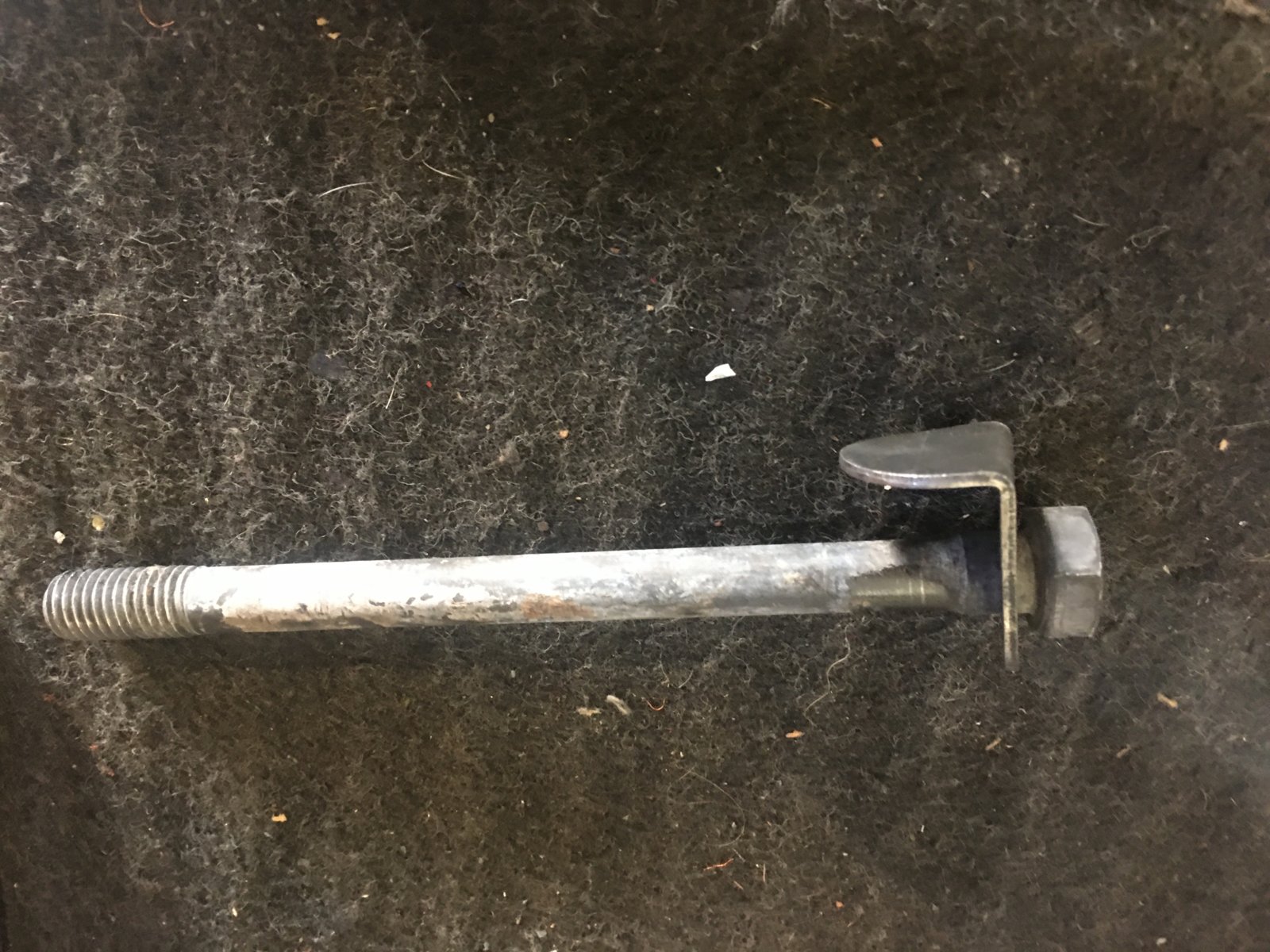

Many high end engine builds used simple 90* shaft plates in the front.

Also I thought of using one or more of these on exhaust if they could fit between the circlip side and pedestal support. The collar clamps cant be thicker than 1/4".

A collar shaft lock could work here on any of the front intake rockers, but would have to be less than 1/4" thick. Look at lower right side of photo.

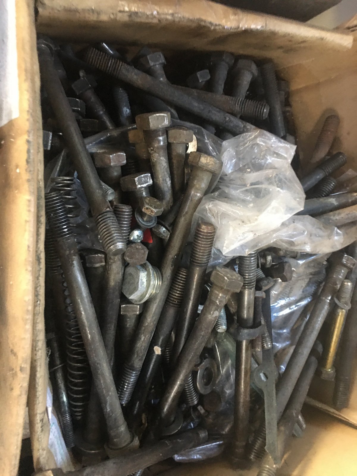

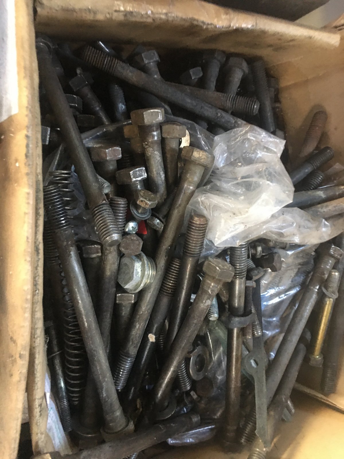

I have at least one of the special stops at the shop and several hundred old head bolts.

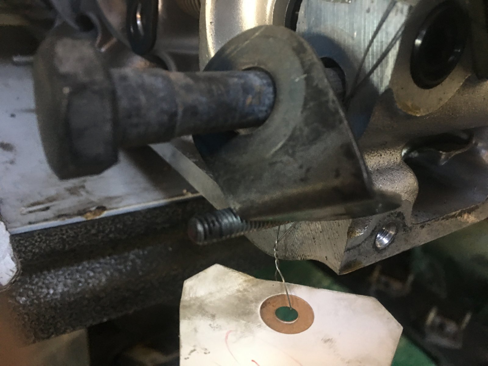

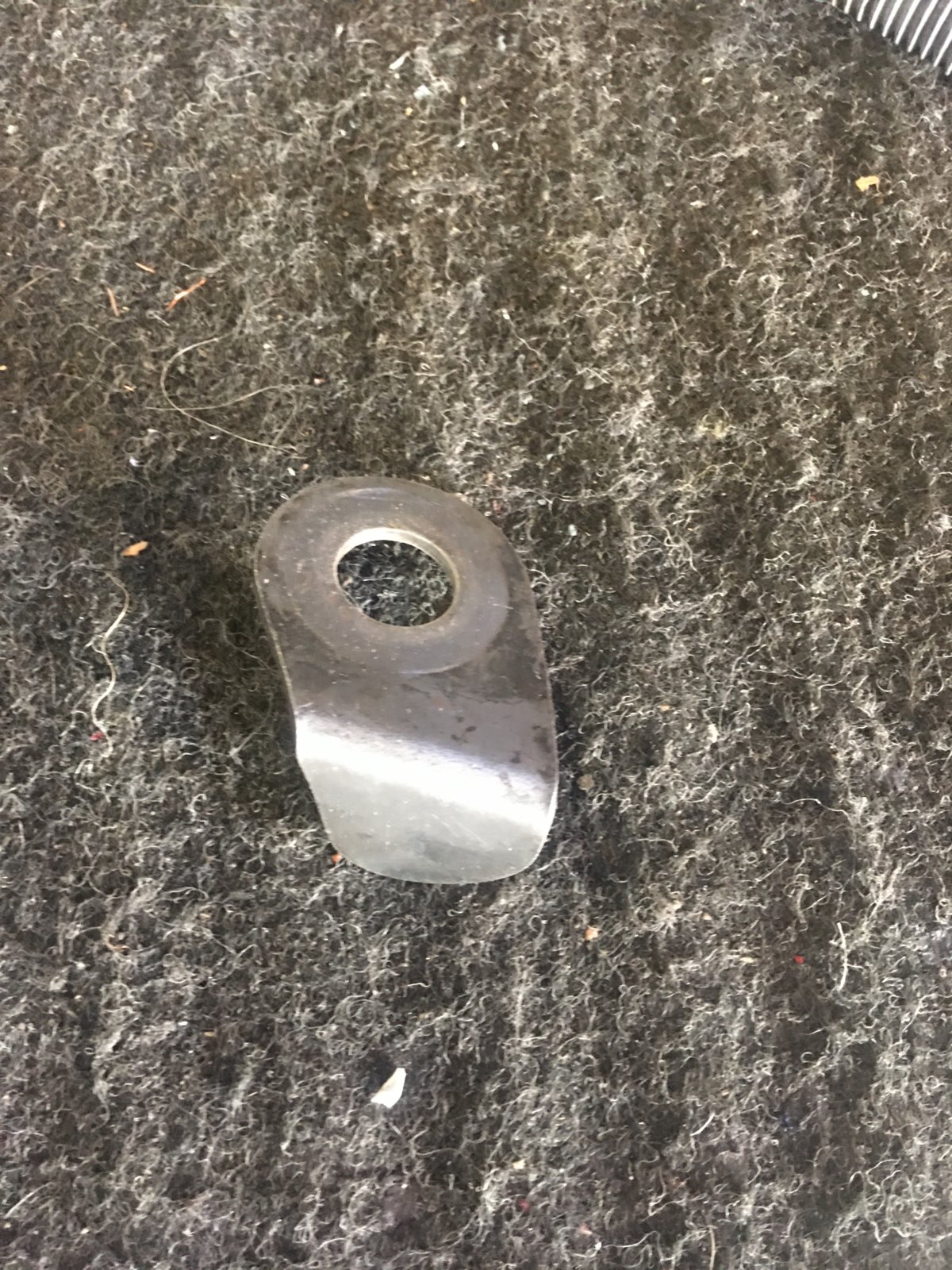

90* shaft stop plate

100 lbs of of old head bolts

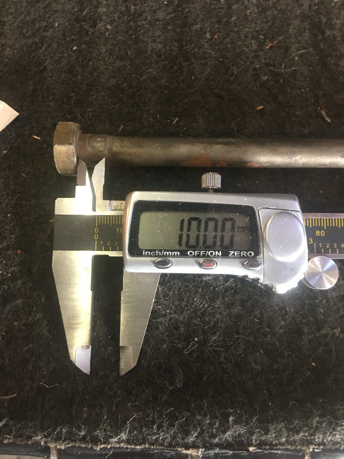

Note that head bolts are more complex than you might think. The unthreaded shoulder at top has 2 dimensions. There is a step the thickness of the washer that keeps the bolt from being completely inserted into the head and bore hole
Shoulder length

Shoulder length
Yes I measured the two different diameters as you say, just about .005" difference almost impossible to see, but it is there.
My new bolts have the same lenght of the 10mm you measured, so I am good there. But still wonder, by using these bolts with no additional means to "lock them" in place, then the rocker shafts will move mis-aligning the rocker arms. So how and why were these engines assembled initially knowing this issue?? What was stopping the shafts from moving. Were the shafts initially a really tight fit? Mine slide right in and out. Or LOL maybe with the older heads warping it stopped the shafts from moving.!!
As far as the right angle clamp, yes now I see that is can be used at the front exhaust. Not needed on the intake as a spacer can be used in the back as was discussed in my case an 8x1.25 nut. So the right angle bracket is used in place of the washer. Clever.
We can make one of those. But in addition we ordered a couple of collar clamps from McMaster-Carr that we possible can use in place of the cir-clip with a suitable shim to lock the shaft up against a pedestal. I will post a photo if it works.
