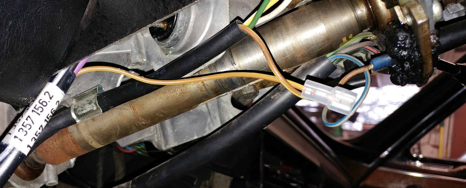

teahead aka "Rob" Site Donor $ Messages 6,453 Reaction score 1,887 Location Tacoma, WA, USA Dec 23, 2017 #1 Where does the brown/yellow wire go? Wiring diagram shows horn, but I already have a brown/yellow wire hooked up. Key buzzer (which I don't see)?

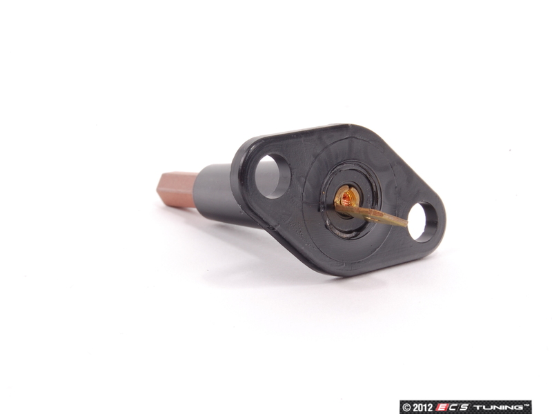

sfdon Well-Known Member Site Donor $ Site Donor $$ Messages 9,177 Reaction score 5,850 Location sfbay area Dec 23, 2017 #2 You appear to need a new carbon pin.... 32331350750
teahead aka "Rob" Site Donor $ Messages 6,453 Reaction score 1,887 Location Tacoma, WA, USA Dec 23, 2017 #3 One of these? Ya, I bet. $50 though. Uggh. I have a feeling that extra brown/yellow is for the key buzzer: https://www.e9coupe.com/forum/threads/key-buzzer.8391/
sfdon Well-Known Member Site Donor $ Site Donor $$ Messages 9,177 Reaction score 5,850 Location sfbay area Dec 23, 2017 #4 https://www.fcpeuro.com/products/bmw-horn-contact-ring-32331350750 11 bucks?
teahead aka "Rob" Site Donor $ Messages 6,453 Reaction score 1,887 Location Tacoma, WA, USA Dec 23, 2017 #5 Thanks. For once, ECSTuning.com is way higher
