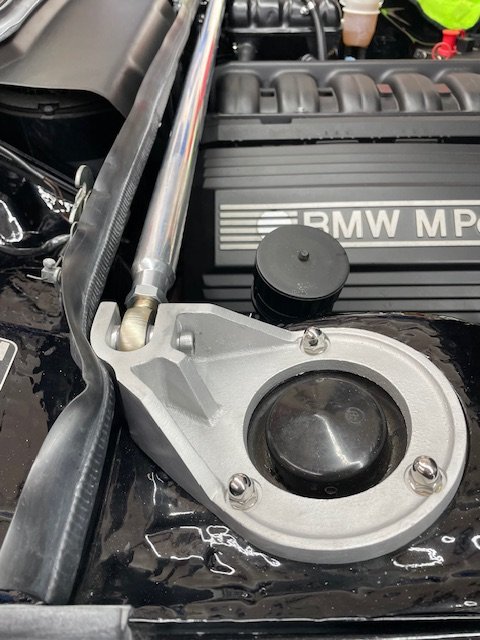

There have been many smaller issues to resolve and Thanks are overdue to: sfDon, Eric at CoupeKing, and Jeff Tighe for parts and advice. I replaced the Weds wheels that came with the car (16x8 front and rear) with CoupeKing's staggered Alpina-look wheels. The Weds are going to be for sale. I purchased and modified the DaddyWad front strut bar to use LH and RH rod ends.

DaddyWad bar kit

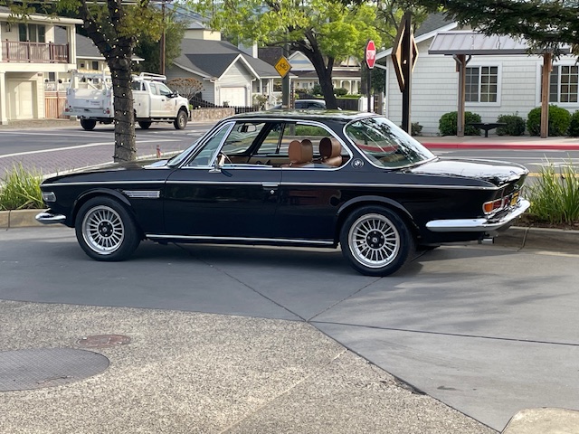

View attachment 225893 Eric's wheels do look nice

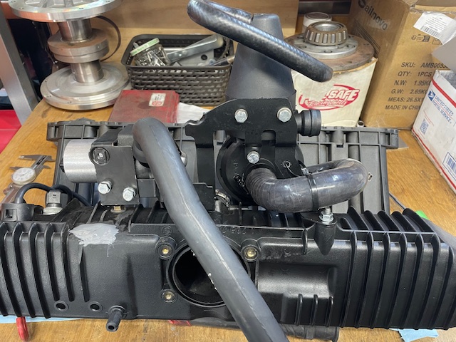

View attachment 225894 S50 intake with S52 PCV (oil - vapor separator) and oil return to sump hose

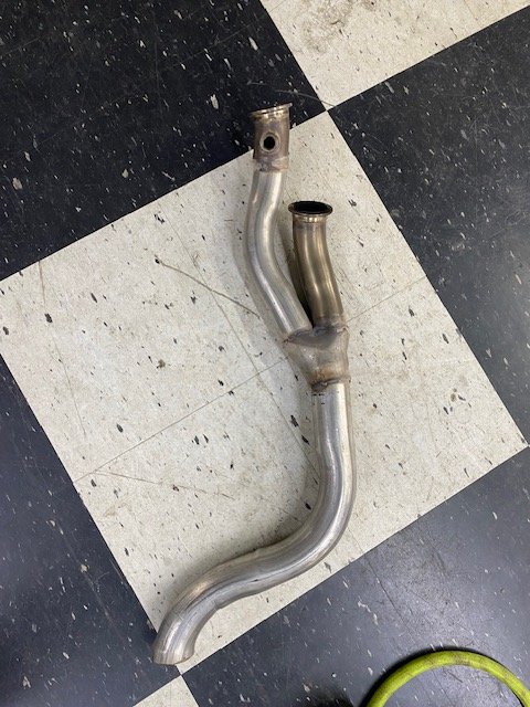

View attachment 225897 The old Y pipe

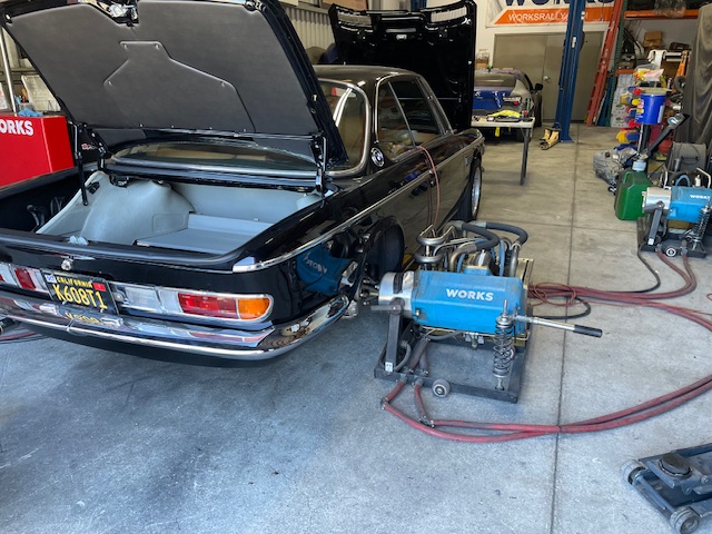

View attachment 225903 The dyno at Works Motorsport bolts to the hubs
View attachment 225904 DaddyWad bar kit
Welcome! I love this build and I'm happy to see that is was sorted so efficiently. I've been on the hunt for a set of those Weds wheels if you'd like to reach out when you're ready!
I'm not very familiar with Weds wheels. The inner and outer 'barrels' are welded together and then bolted to the black center. I started researching purchasing barrels to reduce one pair from 8" to 7" (SRR or BrilliantRays).
I will collect the wheels from storage and post some photos.
These may not actually be "Weds" brand wheels, there is some debate to this since this style had a ton of manufacturers making them all around the same time. I'll send you a message and you can send me pictures! Thank you! Markos is very knowledgeable and inevitably chimes in when wheels come up in discussion.
