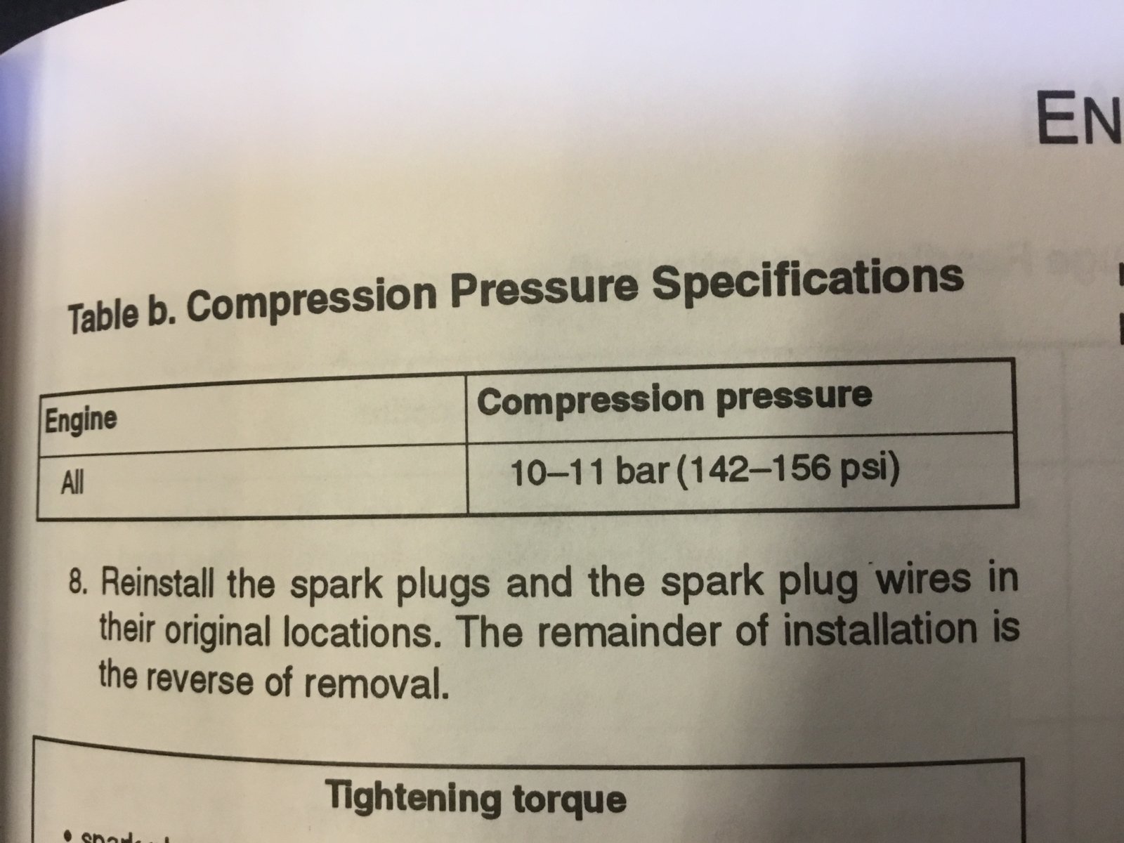

Hi guys I was hoping to not have a "help" post as my first topic. I'm looking at a '74 e9 with the M30B32 motor with twin weber carbs. I don't know the mileage on the motor since it was a transplant before I came along. Supposedly about 70k miles from the owner's recollection. I need to make a decision on a purchase of this car (still haven't seen yet) and I'm concerned about poor compression test result. I'm looking for possible reasons besides a tired motor as a reason. So the readings are as follows checked against two gages.
102, 90, 95, 94, 92, 98.
Now based on those numbers (taken at 1,000 foot elevation) seem really, really low. I'm told the car starts right away. That it idles fine for a carbureted engine. I'm told It runs perfectly fine with the usual power. I'm told it doesn't seem to have any blow by or smoking.
I haven't checked for a cold start video or view - yet. I'm looking to make a long drive tomorrow to see the car in person and make a purchase decision tomorrow or Friday morning. I'm very nervous about this. Other wise the car is in immaculate condition with the right updates, 5 speed, LSD, no rust, no accidents, new leather interior. Basically a great car but those compression numbers bother me. I have no idea what a complete rebuild might cost.
What are your ideas? What are your thoughts? Is there a simple explanation that doesn't include a tired motor? The shop that did the test, said all spark plugs were removed and the throttle was held wide open. The car was warm.
Those numbers do look low. A healthy US M30 should closer to 150-155 with no more than 10% difference from lowest to highest. When driving the car get it safely up to highway speed 55-65mph put it in 3rd gear let the engine slow the car down while watching the rearview mirror for puffs of smoke. this usually indicates worn rings.

Really poor numbers...

That is strange, with such even and consistent low numbers and with the owner stating everything is OK, I'd suspect the compression meter or the mechanic did something wrong while using it.
