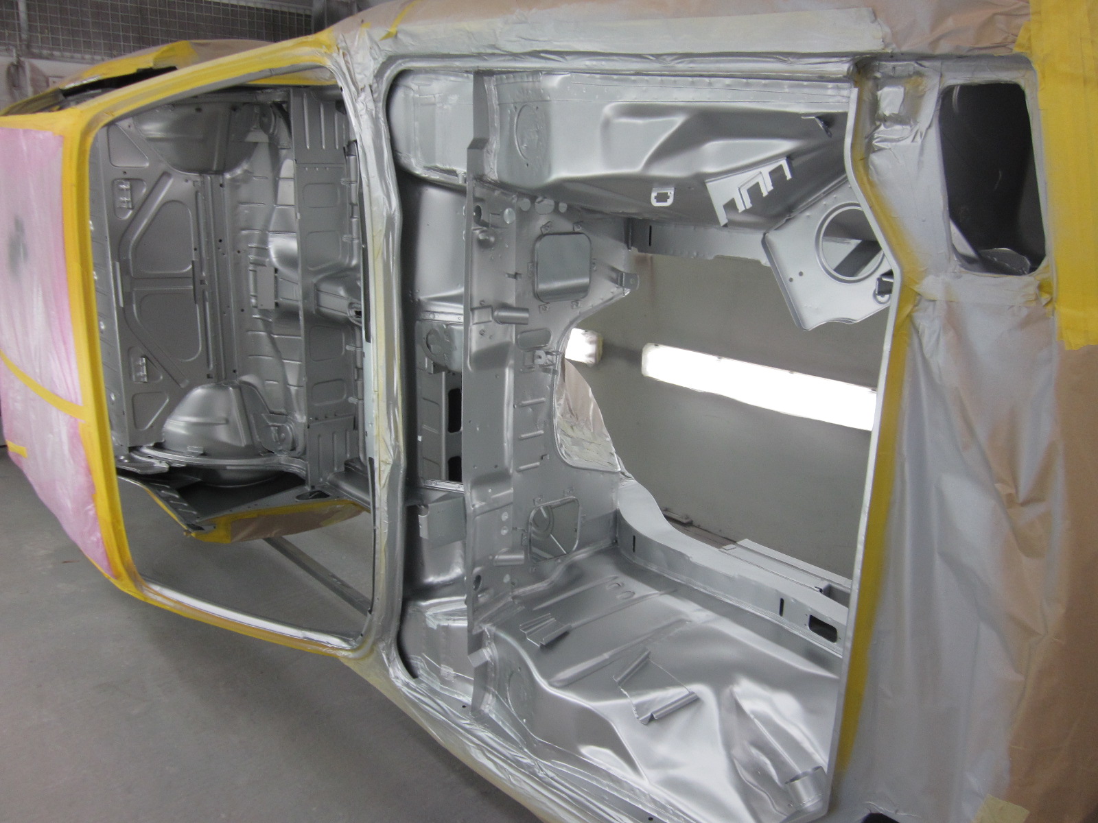

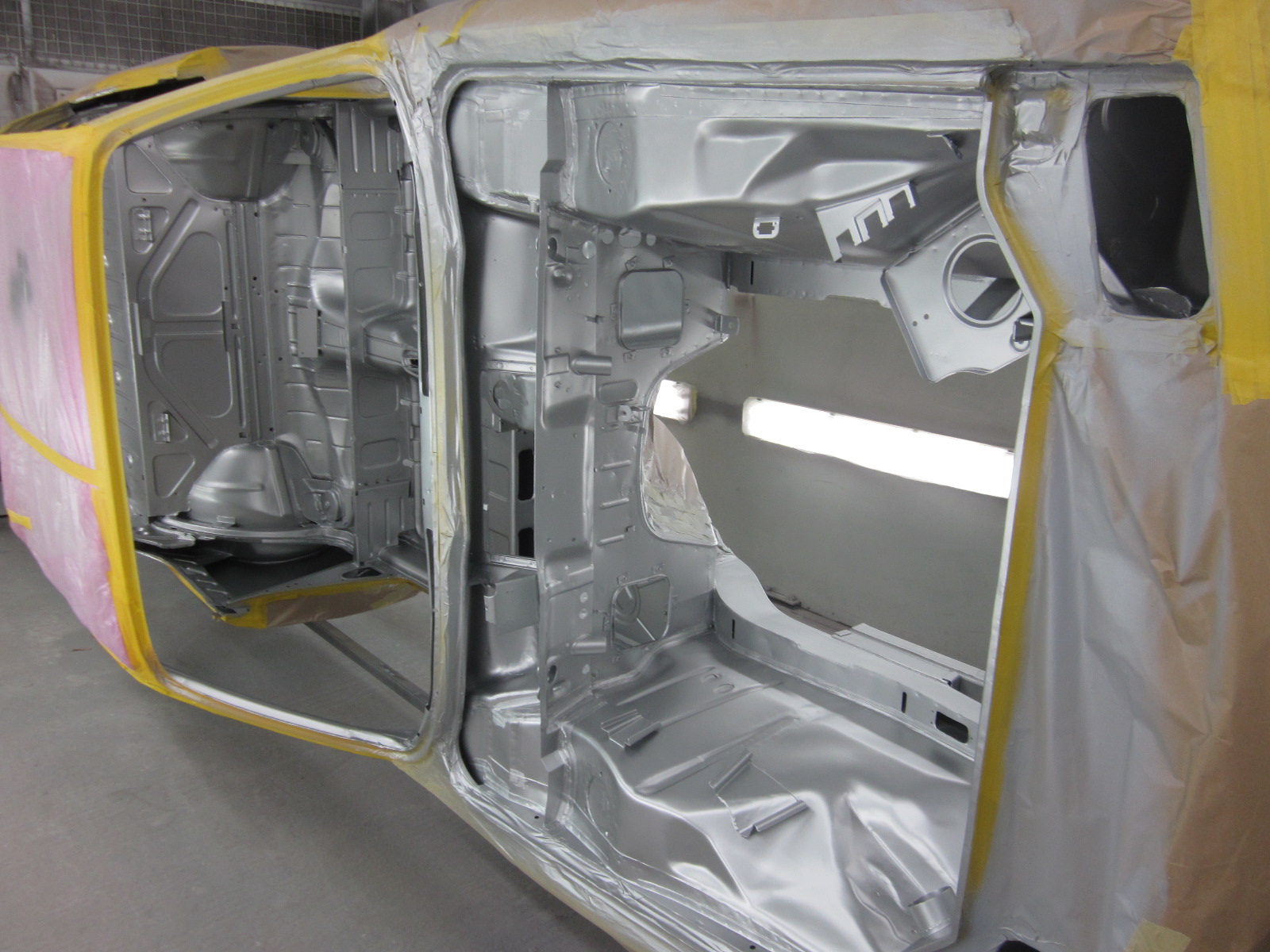

Here are a few more pictures of how we attached the mounts for the rotisserie.
The front frame simply attaches to the 4 subframe mounting points and projects out under the front valance panel.
The rear frame attaches to the outer subframe mount bolt and also triangulates up to the strut top mount turret and we also have additional fixings through the rear panel bumper mount holes to stop flex and sagging.
I hope this helps.
