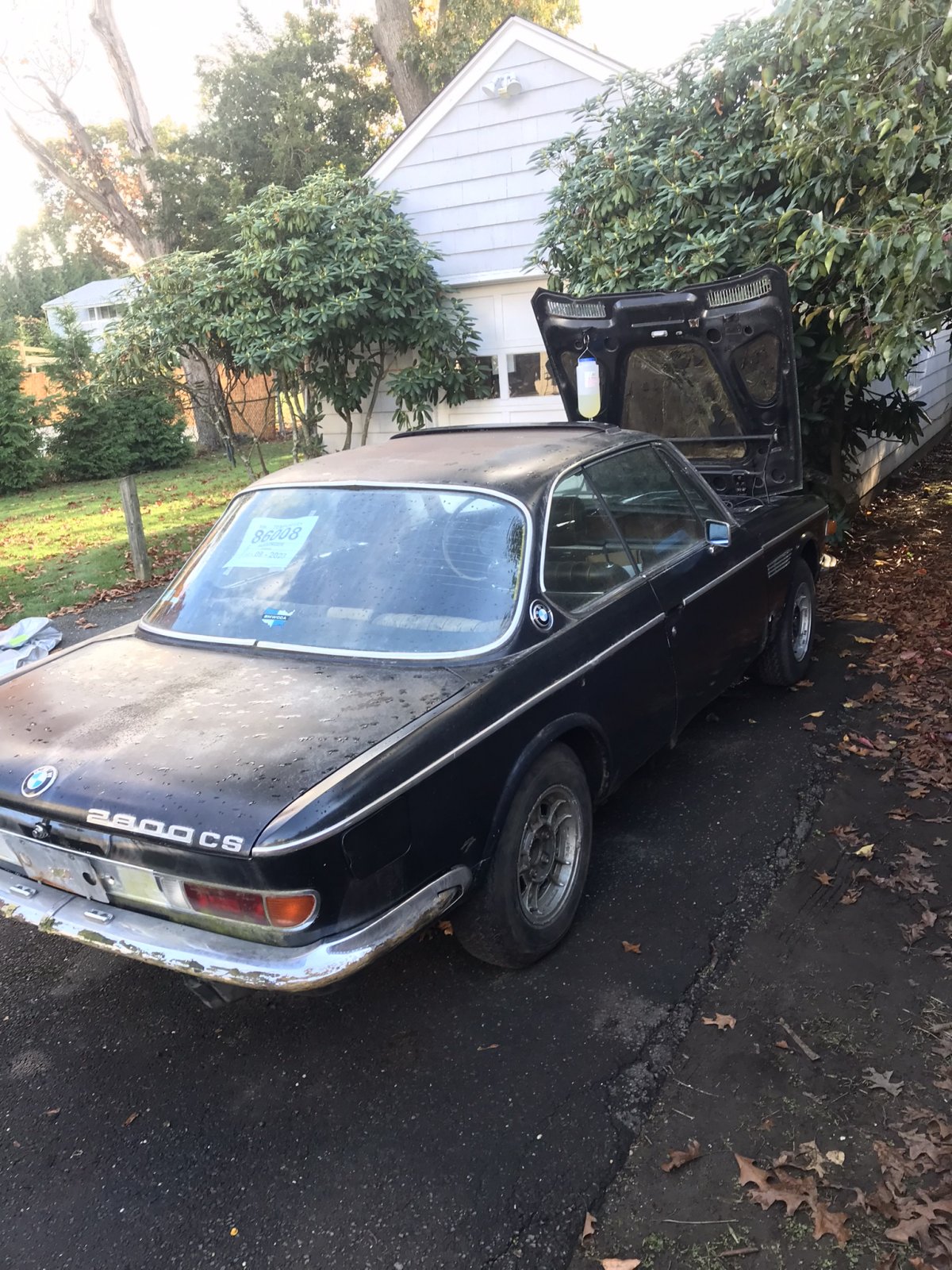

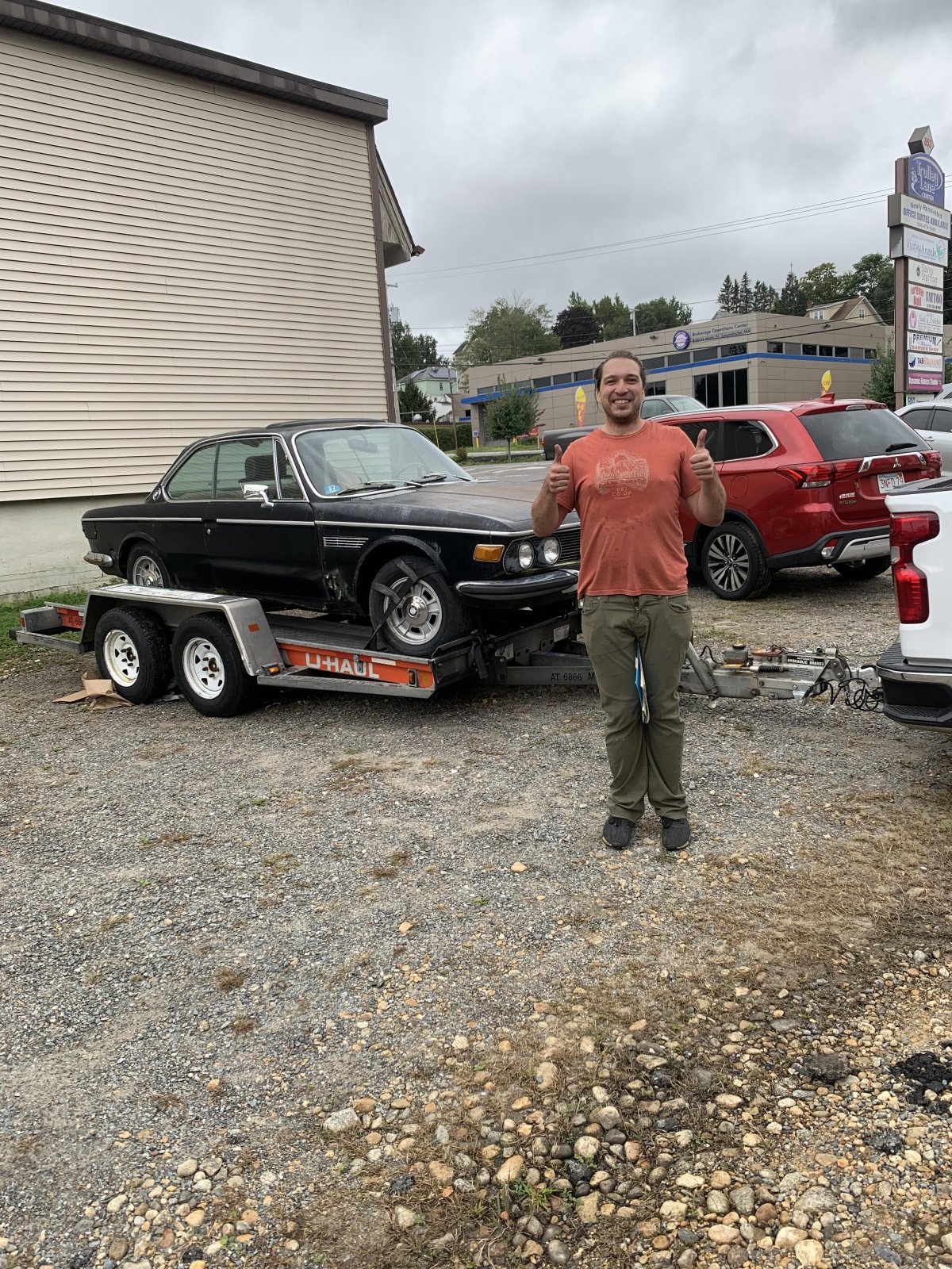

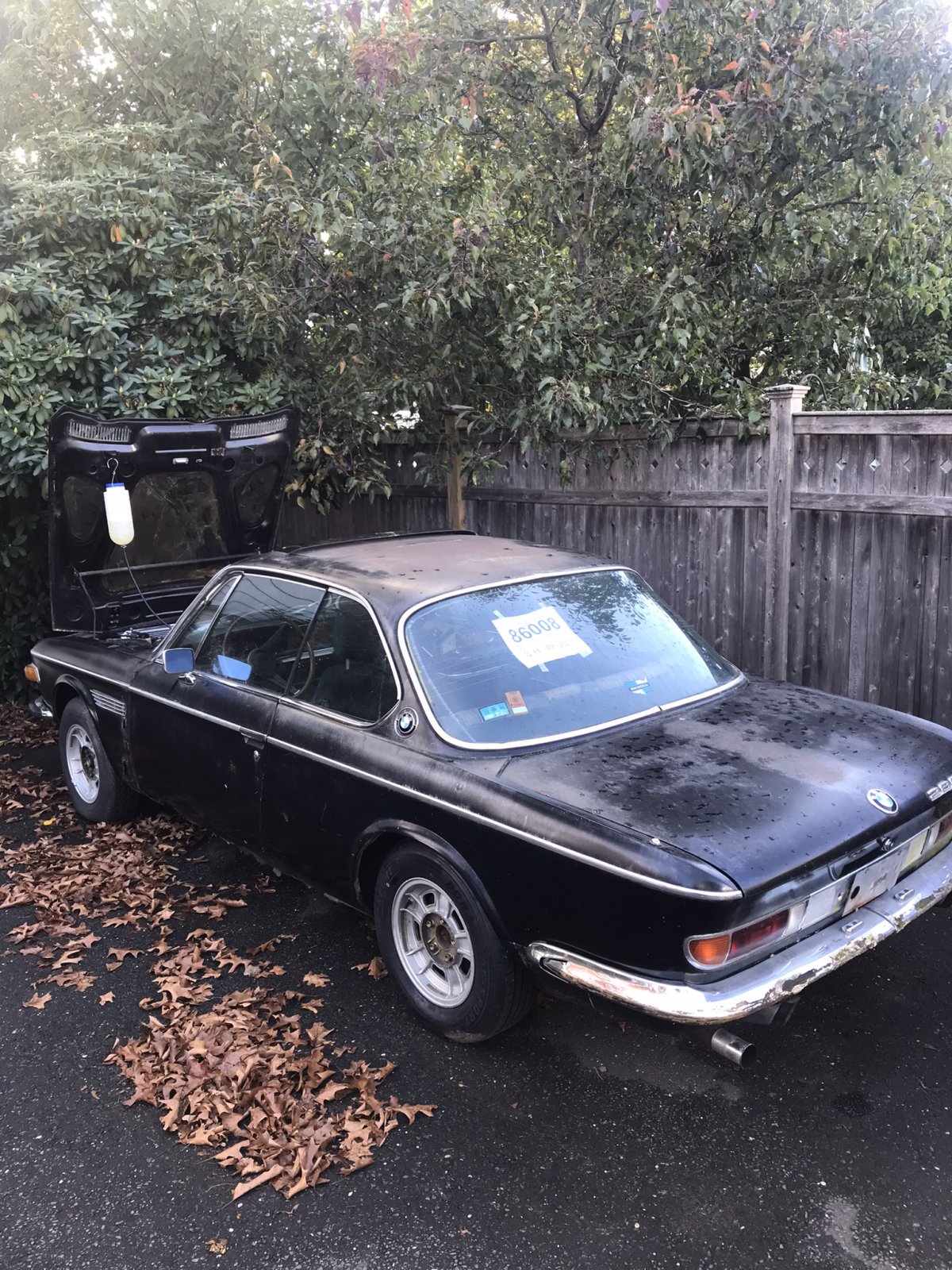

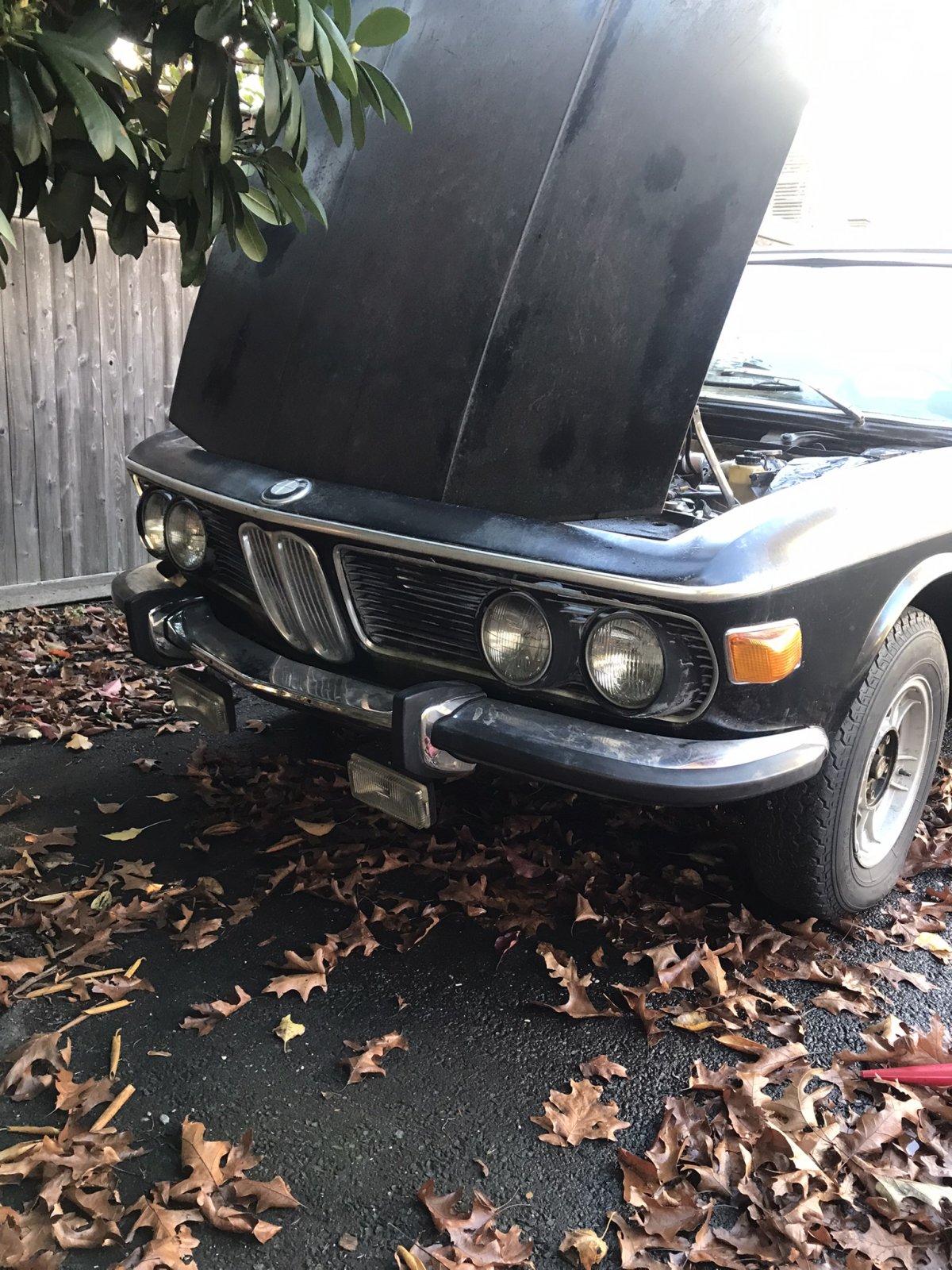

Hi guys, Marty here! A dream of mine has always been to restore a car. Found a perfect candidate with this 2800CS. Needs a lot of work, didn't think I could get it running but had good luck and got it going with battery, spark plugs, fuel tank cleaning (plus leaky hole welding), new fuel line, and a new radiator, but just about able to get it on the road once I figure the brakes out.

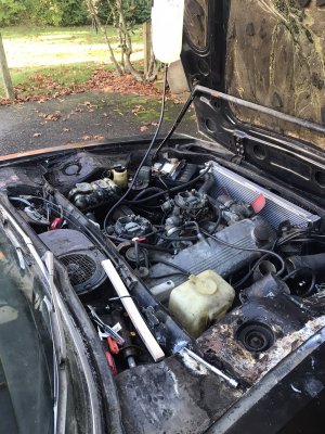

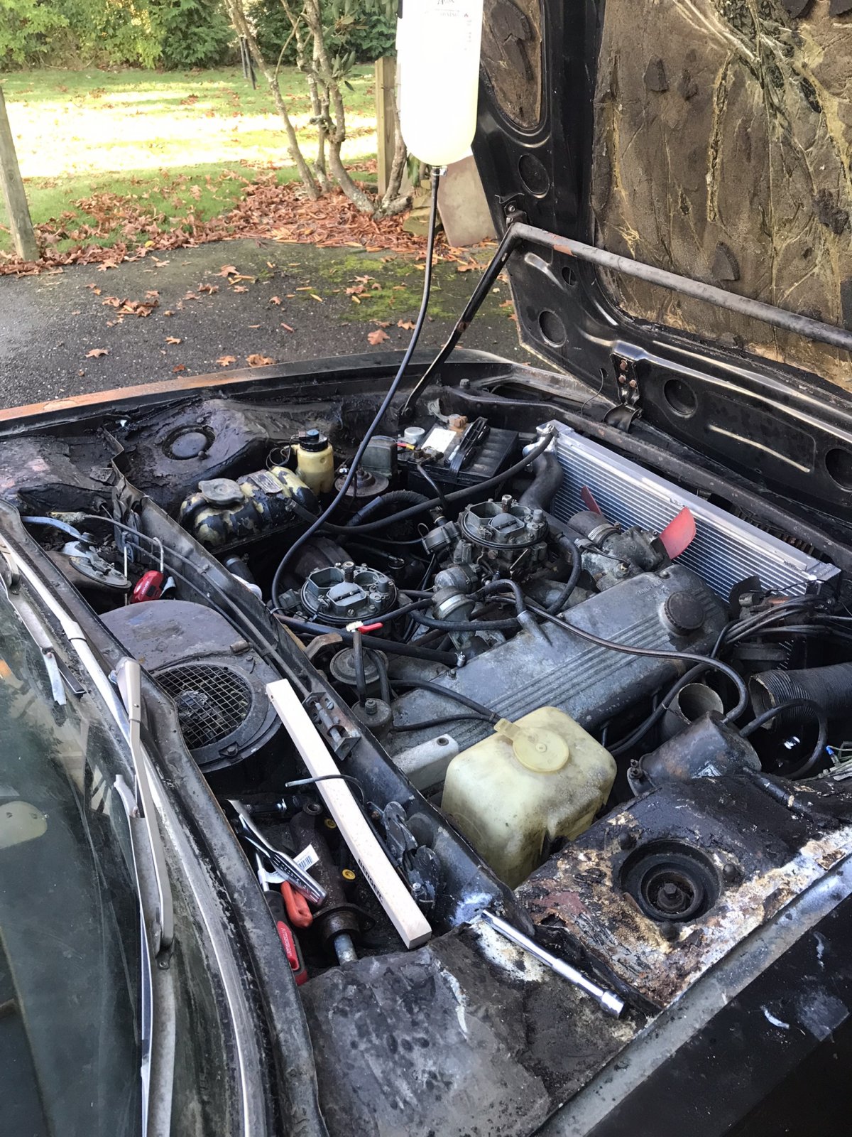

Original plan was just to strip down to chassis and acid bath and start there, but with getting the car started, I thought what the heck, let's get her on the road! Going to see if I want to keep original zenith carbed engine or swap, otherwise mostly will be restoring. Want to get all rust out otherwise I don't think it's worth doing!
Will probably be asking lots of questions even with all the info already available!

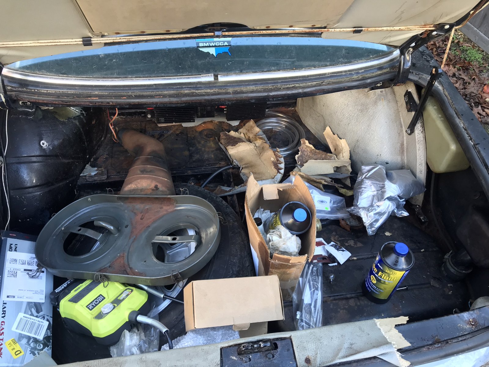

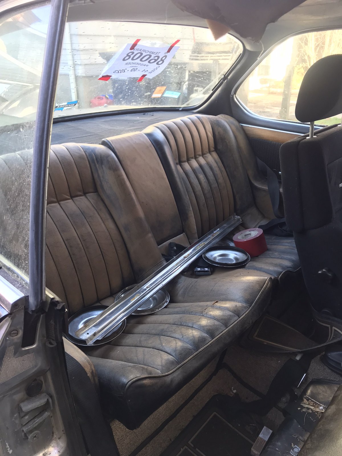

Yes, love the wheels, but wheels were not going to stop me buying this car. Happy I have the full size spare with matching rim. I have all 4 hub caps in good shape and most trunk tools.

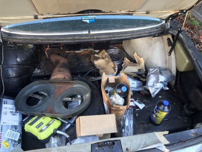

All structural parts seem solid to a hammer tap. The front A-pillar joint needs to be sorted and the bottom of doors, sills, and wheels wells are bad. Trunk spare tire well is rotted through but already have that new panel. I actually think I have most parts (95%) so happy about that. Debating how orginal I want to restore and what I'm okay modernizing. I think I want the original engine. It's number matching and sounds good and does have good power, but driving it around will tell me what to do!

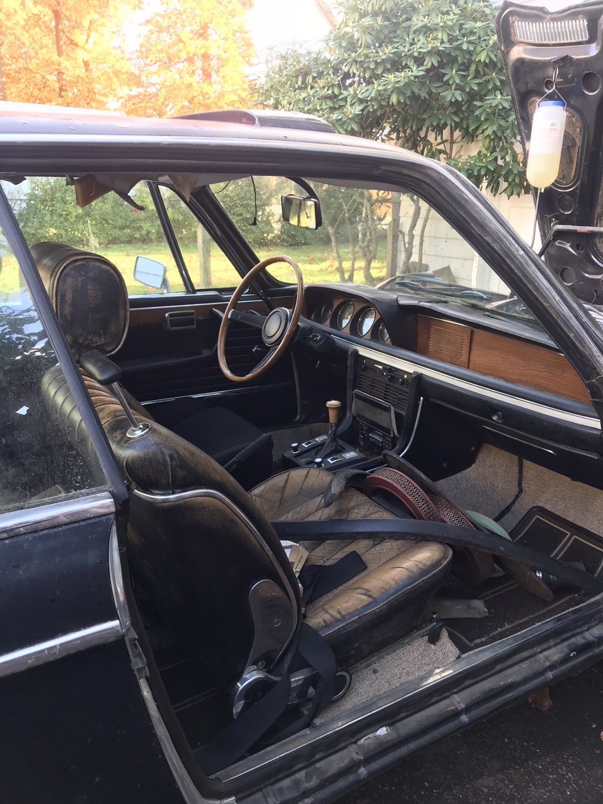

Your car looks like a good base.
Box structures behind front fenders, wheels wells, inner sills or spare wheel compartment are typical for all E9s.
Non cracked upper dash panel might be a challenge to be found for good money, but they are still possible to be found.
You can check VIN with the E9 registry top page of the Forum to see if it was already registered here by previous owner. It has BMWCCA sticker, so probably it was seen by some Members here or might be some may know the history of that car more. Worth to check.
Originality is important as long you are happy with it. In the end it is Your dream car.
Some modifications are recommended by the Members from Webers, rear disc brakes (ventilated at front), A/C or electronic ignition but it all depends on You. At least you can check topics about each of the upgrades here to make your own decision.
Anyhow brakes or basic check will take some time and it will allow to look deeper in some places. Fortunately most of the common parts are available (see FAQ section for more details)
Good luck with Your E9 journey !

Love the steering wheel
Lose the plastic wind deflector
Love the rectangular under-bumper driving lights. Are they Bosch? Took me forever to find a set!

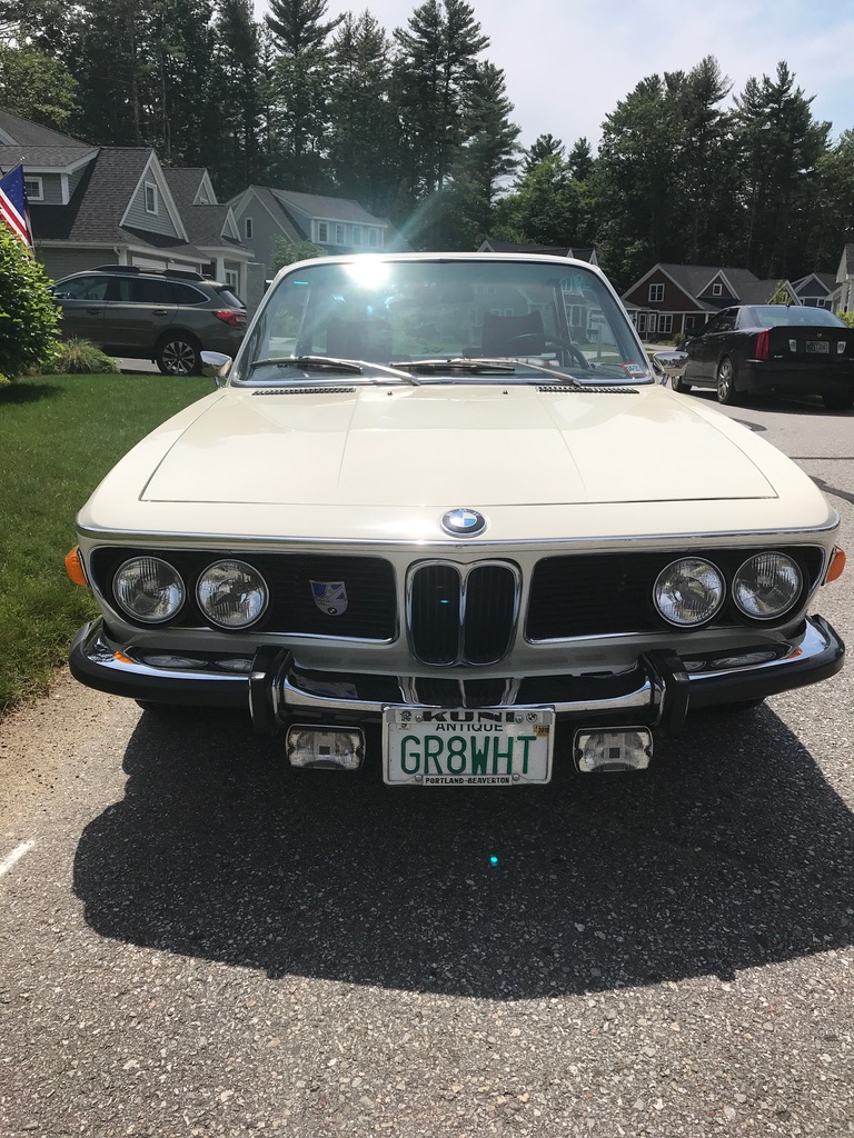

Hello @Marty , welcome to the forum! It looks like you have a great start to a long and wonderful journey. As others have noted, this is the place to be, and there are so many knowledgeable members here that are happy to help.
I started very similar to you. When I found my car it was rough and not running. The first thing we did was getting it running, driving and stopping. But I then quickly stripped it down, dipped it, and embarked on chassis restoration. I'm still working on that aspect (and may be for years to come). But I do love knowing every centimeter of the car. It is a rewarding process, for sure.
I'm looking forward to following along with your project.

I figured those were all typical. Dash we will see, not that important to me right now, but will always be on the lookout.

Are webers an upgrade? I thought they were less finicky w/o all the zenith gizmos. Right now my autochoke does heat up and work. The electric pre heat element I still haven't dived into, but regardless need to rebuild them. The car does sound very good with them.

dash - you want to remove / replace when the front windshield is out. very difficult to do otherwise. you can fix cracked dash with padded dash filler - sand and paint with SEM color coat.

Are Webers an upgrade? Haw, that's a loaded question. Simple answer: depends on who you ask!
We're talking the downdraft DGV series Webers that bolt to the original BMW manifold; not the sidedraft DCOE's. Your perception that they are less finicky than the Zeniths is a good summary. Zenith advocates say than when properly set up, the Zeniths run smoother and use less fuel, which is probably true. Nonetheless, I have manual choke 32/36 DGV's on my 2800 and like them for their simplicity.
The original 2.8 is quite a nice engine, likes to Rev. Webers for simplicity. I'd restore to original and spend you money on the body. Get it driving and use it and enjoy for 6-24 mos before you take it off the road to do the body work.
