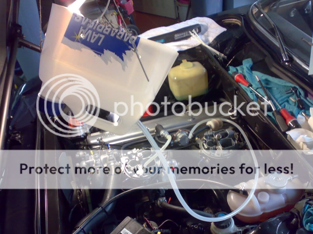

is it a mechanical pump,
it happened the same to me, please, you must fed the pump, i mean, you must pour some fuel inside the pump, fill it and then it will work ok
so, do the following:
1-prepare a reservoir with fuel and install a hose from that reservoir to the "in" tube of the pump
2-hang the reservoir from a high point (the hood has several places to do so)
3-start the car, if the hose is transparent, you will see how the fuel is entering the pump, and your car will start
4- stop the engine
5-disconnect the reservoir assembly and reinstall the normal hose
6- start the car again, it will work !!
see the next pic, that was my reservoir installed
regards
