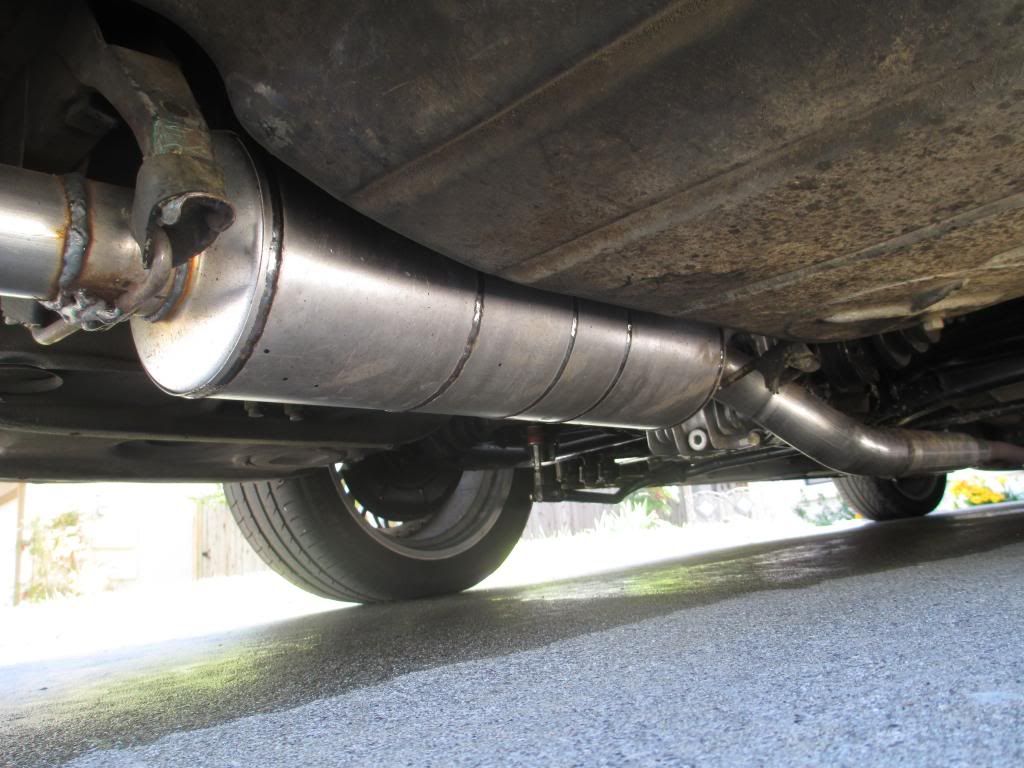

Had to get my stock style exhaust modified to fit around the E28 rear; it was old and about ready for replacement anyway. I went with a single Walker 22635 muffler in the stock rear location, getting rid of the glasspack flow reducer underneath my back seat. I'm enjoying the new growl, it's not too loud on the freeway, and complements the sound of wailing Webers quite nicely.

Hey Mike,
My 3.0cs could use a new rear muffler. Could you tell me more about how you installed the Walker 22635 muffler in the stock rear location? The Walker looks a bit shorter than the original muffler & has a different inlet position.

It's a Bavaria, so the muffler is between the tank and the well. My muffler guy made the pipe, and here's the muffler.
Oh, right ... it's different positioning than my e9, where the muffler sits crosswise behind the tank. Yours looks & sounds great, tho.
If u think your muffler guy could fit something on my '72 3.0 cs coupe, let me know.
