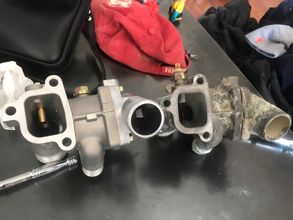

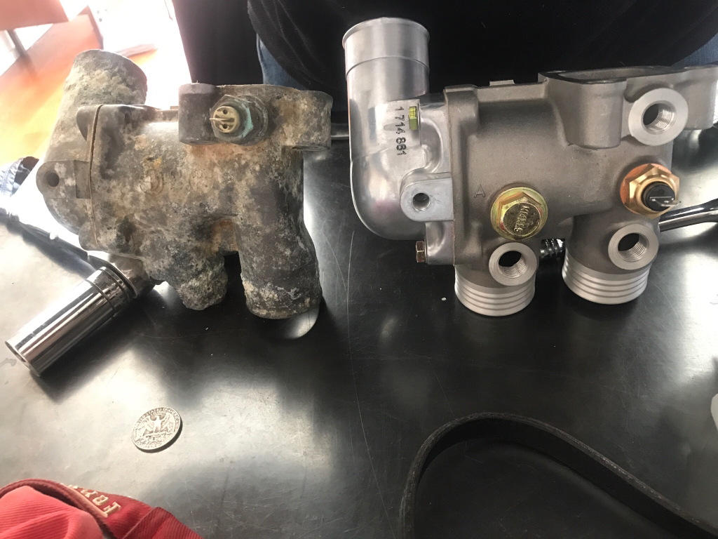

I was assembling the new thermostat housing I received from mobile tradition and the hole where the original temperature sensor was mounted is too small for it. Does it matter that I mount it slightly further back in the housing? It looks like it will capture the coolant flow once the thermostat opens. Thanks for the help! Not sure why they had to change this thing!
