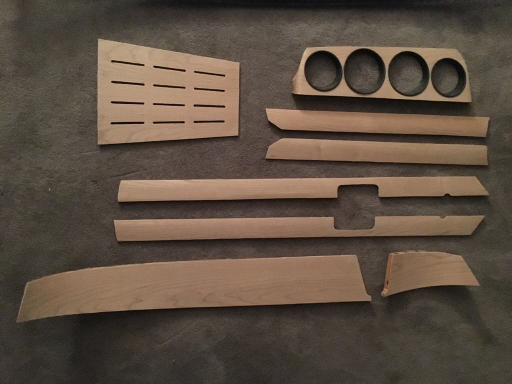

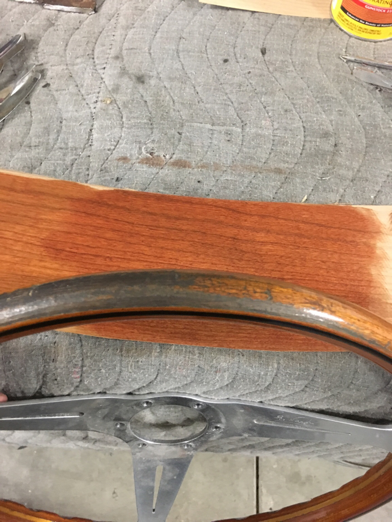

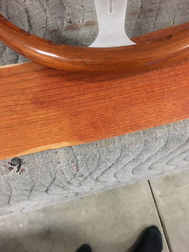

I'm redoing my Dash/wood and going to stain the wood the same as my Nardi wheel.
Anyone ever do a steering wheel?

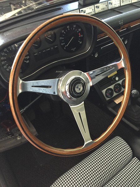

Here is the (Nardi Trivia: about 1966 - before Enrico's passing and when the wheels were made with integral hubs specific to the application) wheel now on the Bavaria which was discovered hanging in a friend's garage who owned no BMWs. He liked it as decoration but was convinced to decorate his wallet instead:
And this was a low-dollar, fairly beaten up Ebay find which I used on a golf cart for farm use. And yes, I'm a tad on the anal side but this was a fun little project.
Wow Jim that Nardi is stunning. The larger and older Nardi's get, the more elegant they become! Great job on the restoration! Love the houndstooth also but won't hijack another thead...
