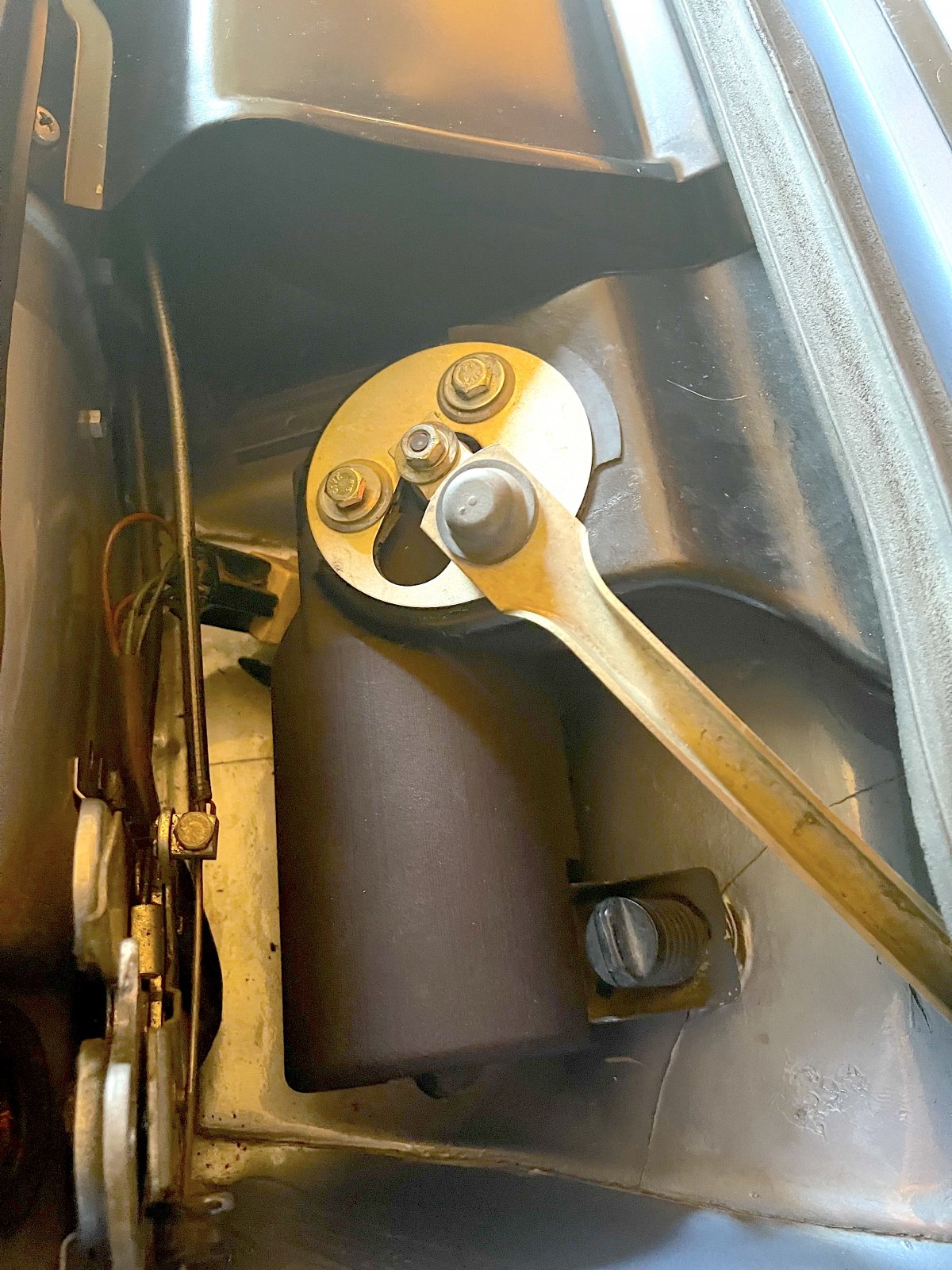

Wiper Motor Cover made of hard black plastic for the final prototype to fit CS & M6 motors like I have.

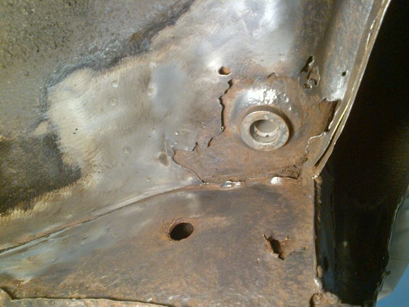

- sheet metal: apart from the clear front fender issue, I missed a repair section for the rear floor; this bit (seen from the underside here):
The triangle is the underside of the sill, left is front of car. The circle is the rea axle mounting point with the big knurled bolt going through it.

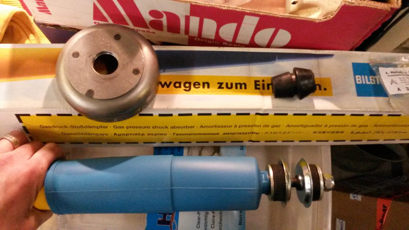

- the rear strut tower reinforcements (after cracking, they need a new cap - various versions have been successfully made by members, but most are one off's. Here's one of a set I purchased 10 years ago made by a german member:

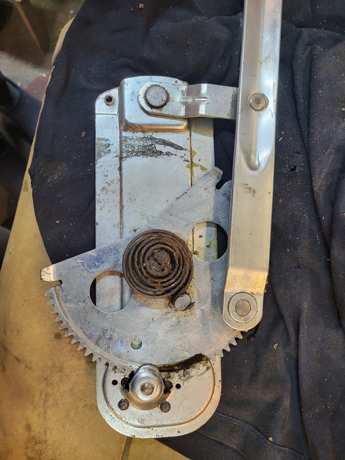

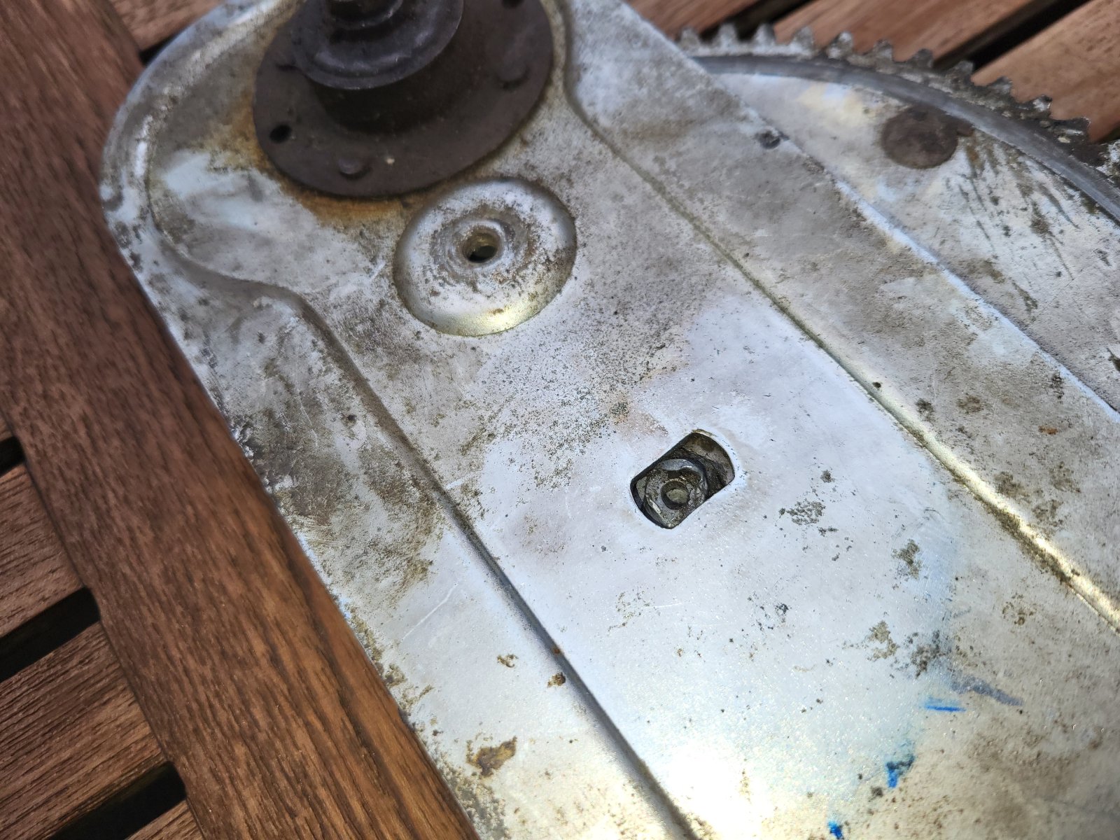

- the center pin of the clock spring window winder mechanism - it fails due to being too soft metal.
clock spring side and the other side showing the deformed 'plug' through the hole:

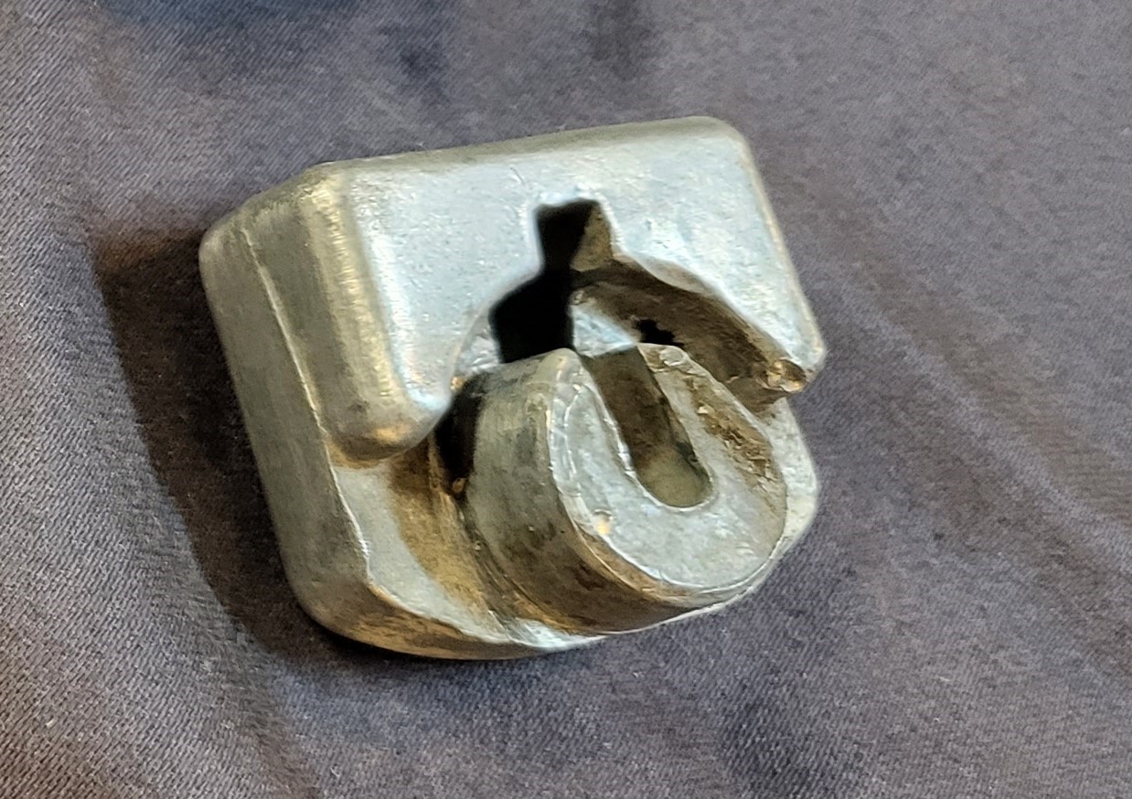

- the soft metal block inside the front hood hinge system: these things:

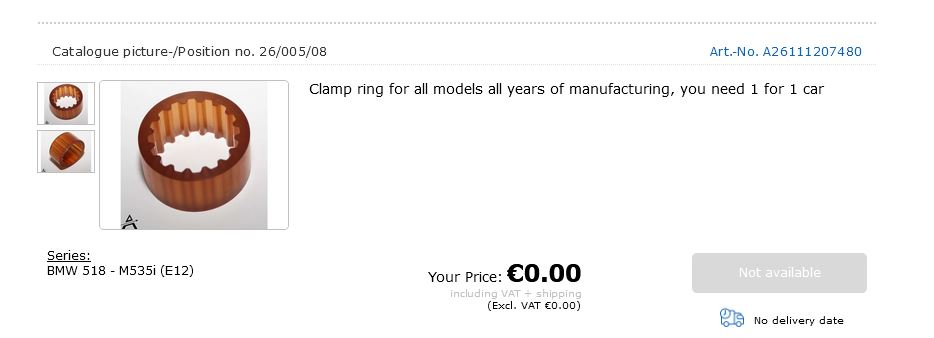

- recently added to the list, the rubber clamp ring with coarse threads on the drive shaft: No alternatives that i know off apart from reusing the 50 year old rubber part
