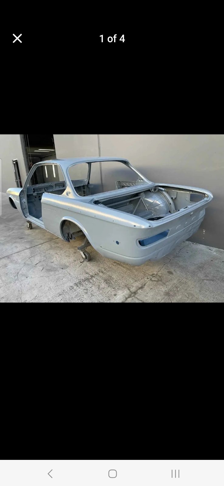

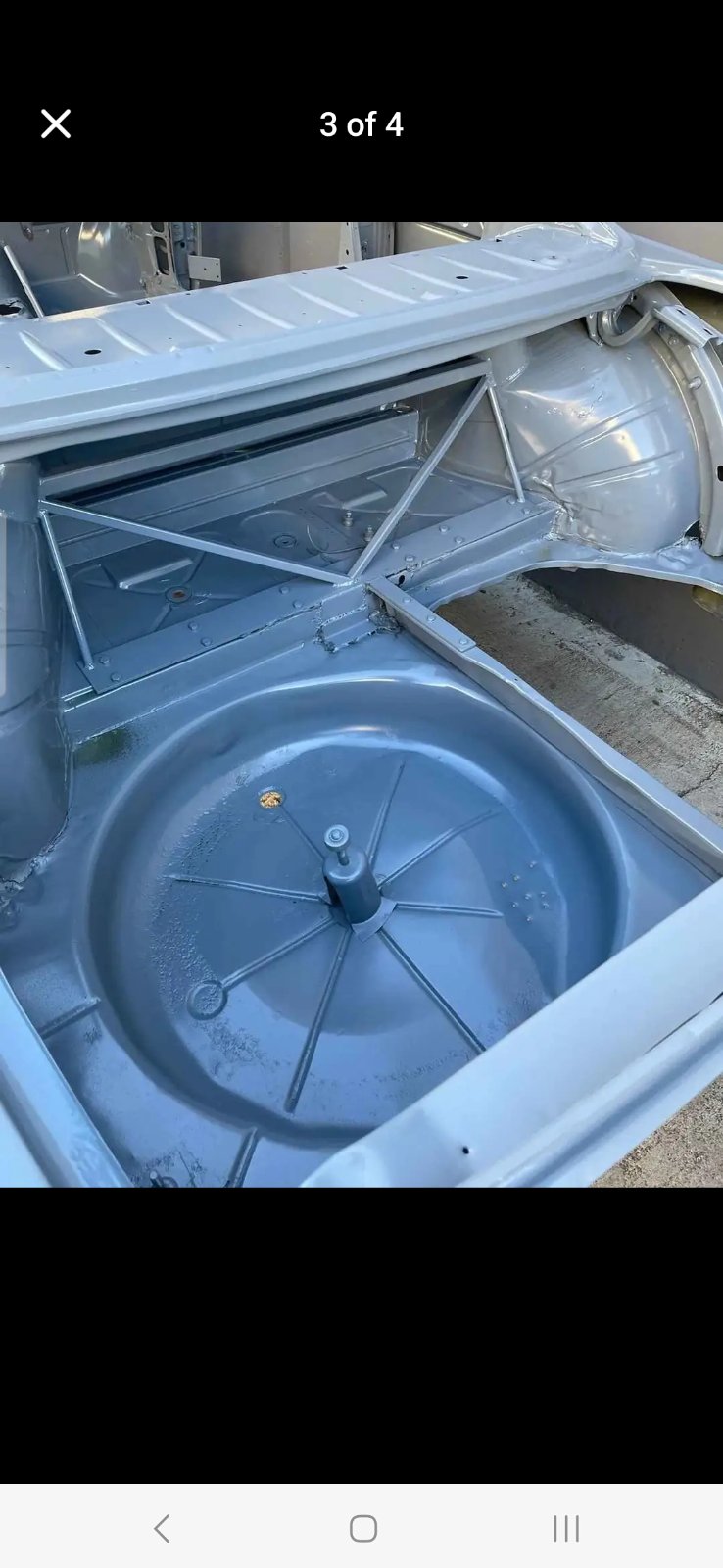

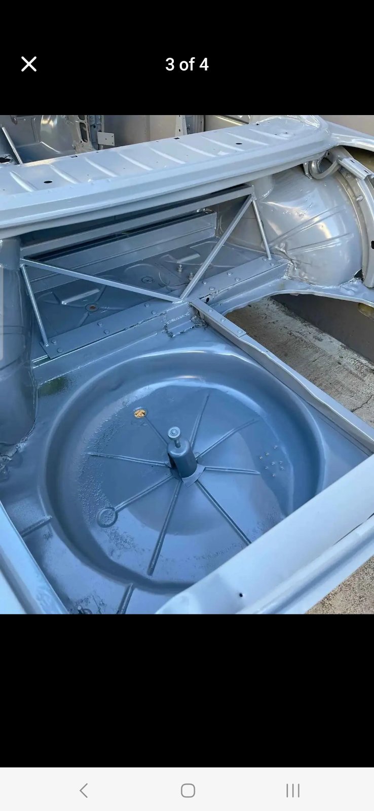

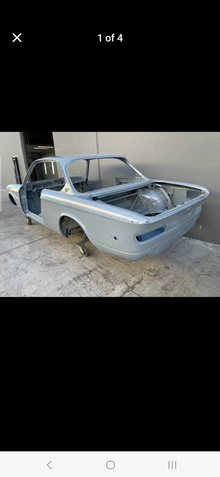

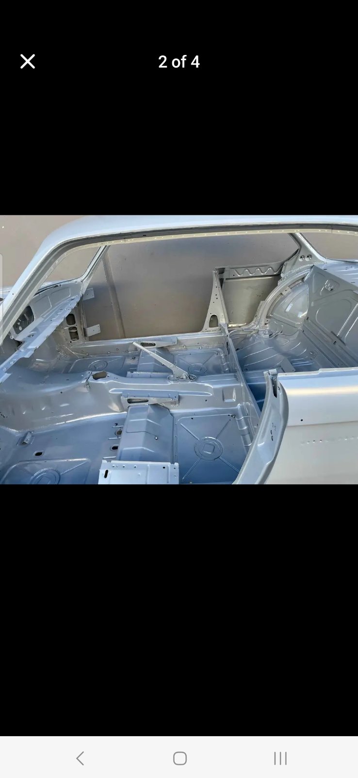

The trunk right rear wheel arch has some funny wrinkles. Seems like it has had an accident, or the diff tore off or something?
Also some poorly patched rust spots in that trunk, of the type that just make it worse. Still. It's a car. And maybe very presentable after a few years of work.
Particularly worried on the corner of the left wheel arch/floor/outer skin; it's just half visible on the left edge off the picture. What i can see, isnt nice. What I can't see...That's a nasty corner to fix.
I'd consider the fresh paint as a primer. There is likely, based on the trunk status, enough metal to be welded (correctly this time pls!) to warrent a full repray once done.

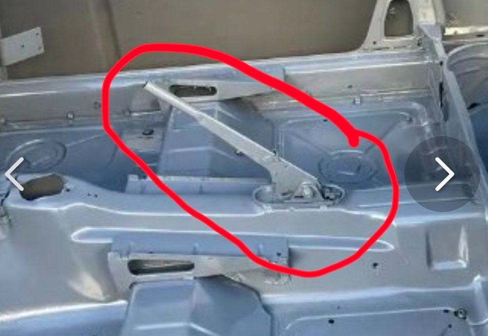

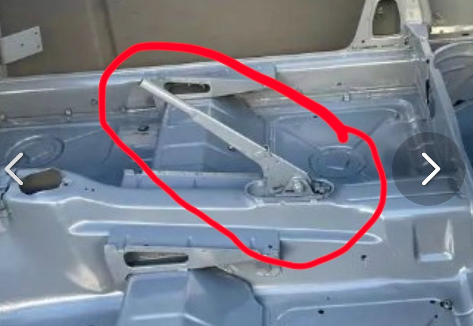

Oh, and painting right over the handbrake is a clear tell tale to me about the effort gone into prepping the car for painting: ASAP please. Get it done. I want it out of the way.
