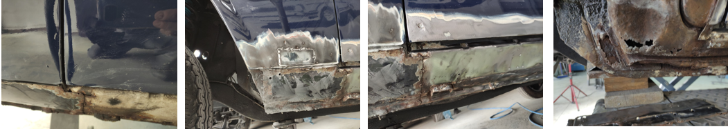

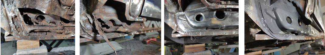

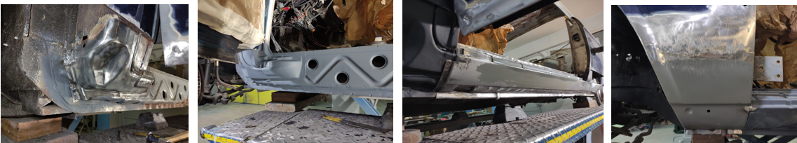

It can be repaired one way or another, I was shown this recently
to my untrained eye doesn´t look too badly done
this car lived in Madrid for many years, supposedly dry weather, no salt during winters,...well
@deQuincey , although the pictures are a bit small, the fix of the front the part of the sill(rocker) seems to be done to an acceptable standard. Rust will be dormant for a long time if the car is well loved from now on.
One could have made the choice to replace the full inner sill and
not only the front 40cm.
This would make it a very, very decent repair, and double as expensive.
Rust of this size in the front sills usually also means bad rear sills and bad front shock towers: both are difficult jobs like the front sill.

Rear sills and front shock towers were also repaired, I have seen the pics, but too much carnage for dinner time me think
