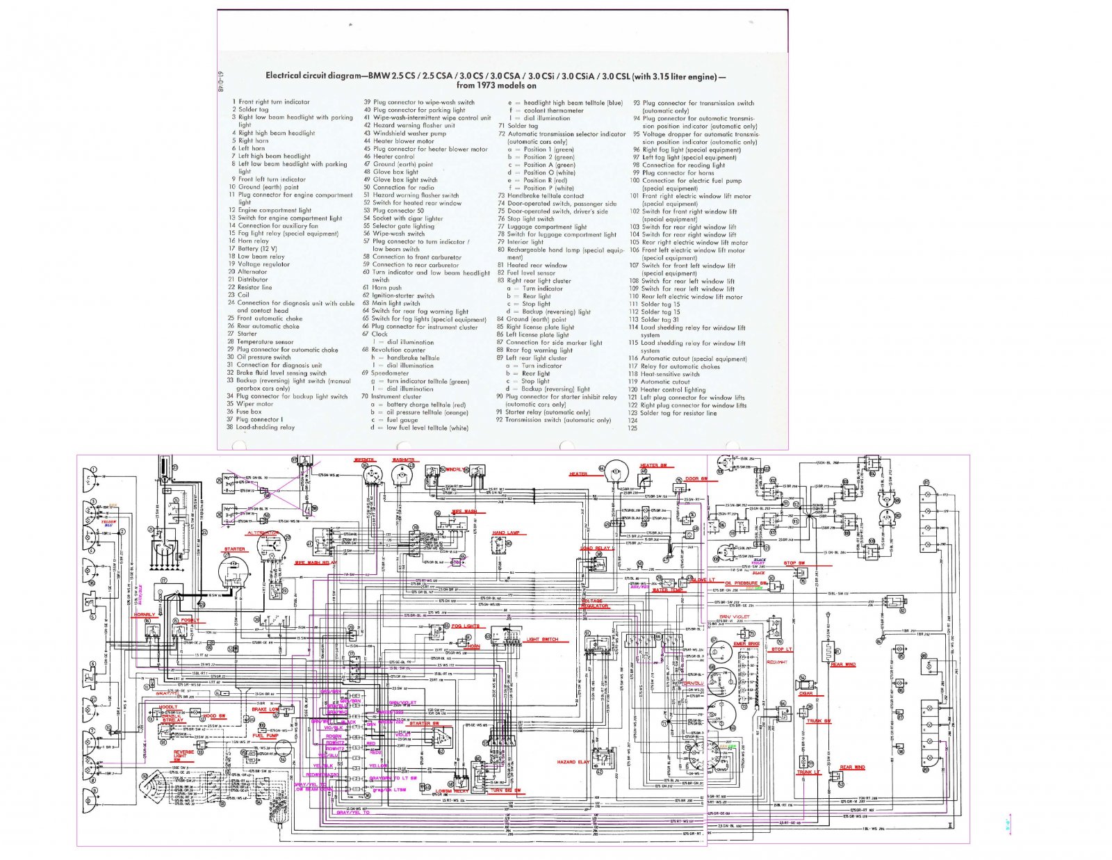

I freely admit, the electrical aspect of this car has be baffled. I posted before that I have no power to the rear electric windows in my 73 Euro (manual front windows). I also have no power to the electric sunroof. All motors are working via direct hookup to 12 volt source. The sunroof is on fuse 10 and that has power going through it. The kill switch for the widows is functional and in the right position. There car starts without any issue. I have gone over electric diagrams till I am blue and still have no answer. Is there a ground somewhere that I am missing???
MAYBE THIS WILL HELP
I WOULD GET AN OHMETER AND CHECK THE CONTINUITY
OF THE WIRES FROM THE FUSE BOX OUT TO THE CIRCUITS ENDS
THAT WOULD GIVE YOU YOUR BEST CHANCE OF FINDING THE ISSUE.
ALSO MAKE SURE YOU CHECK THE RELAYS UP UNDER THE DASH
THAT COULD SURELY BE A GOOD PLACE TO START
AND YOU CAN JUMP THE RELAYS TO MAKE SURE THEY ARE SNAPPING GOOD. OK
IVE GONE THRU ALL MY WIRING EXTENSIVELY AND THAT SOUND LIKE IT COULD BE THE PROBLEM.
